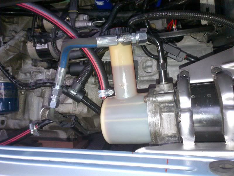

Ill get one to moz what piping did you use for the pump?
Cheers
View user's profile Send e-mail AIM Address
PostPosted: Wed Jul 03, 2013 3:09 pm Up
Posts: 7047
Zack
PostPosted: Wed Jul 03, 2013 3:12 pm Up
Joined: May 19, 2011
Posts: 581
Location: Northamptonshire
Edward wrote:
Wow so clean and good!!
