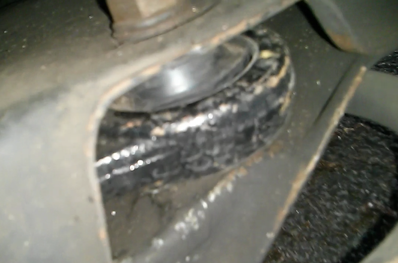

Pretty much as it says. Car becomes really unstable even in non-sharp corners, enough if I keep pumping the accelerator, it swirls the car into wobbliness Sad
Drives sharp fine when driving/pulling straight forwards.
When the car is raised with wheel off, you can see a tear(?) gap in N/S lower arm's rear bush rubber.
Just took the picture when the car is parked on all 4s now:
I can get a better quality picture, and raise car up in the evening.
Lower arms are not of top-notch quality, but they were fitted two months ago!... So could this gap be causing the problem?

The split could be letting the arm move more than it should.
Could be the rear axles bushes are going and you've got movement there too.

I can't see the tear in the picture. But as said check all the rubbers. Engine mounts as well

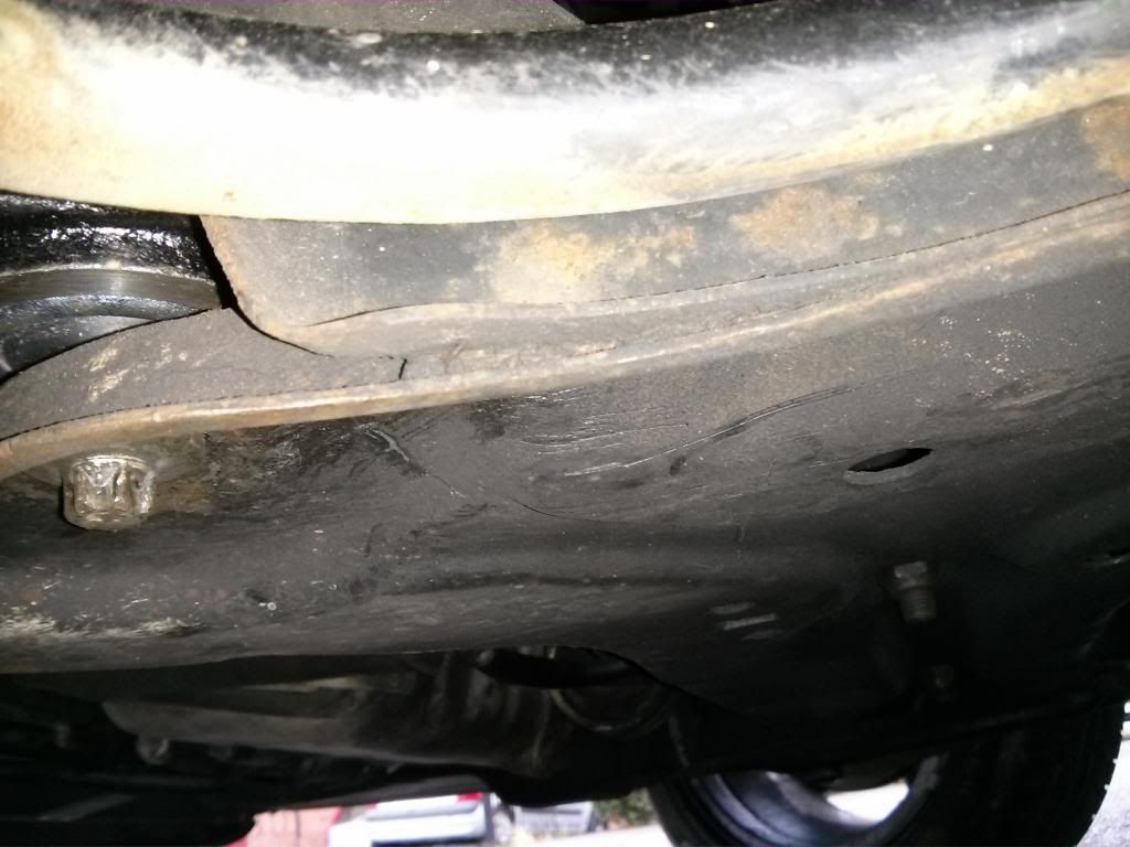

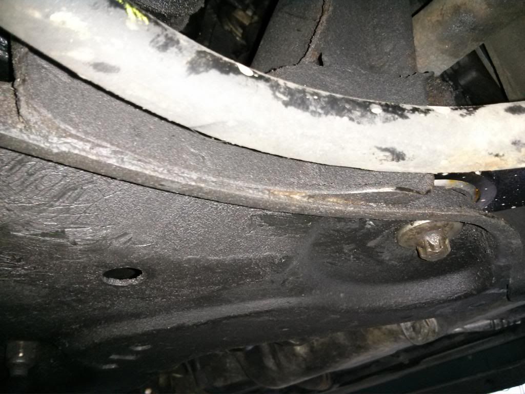

Could anyone please post the pictures of their (ideally HDi 2.0) subframe, so I could compare?
I suspect to have a bent subframe fitted. The N/S looks like this (notice the gap between the two metal lips -- should it be there??):
Meanwhile O/S looks ok:
Many thanks.. If it should not be like this, then the bent subframe has eaten a couple of N/S wishbones (this one got ripped in two months):
