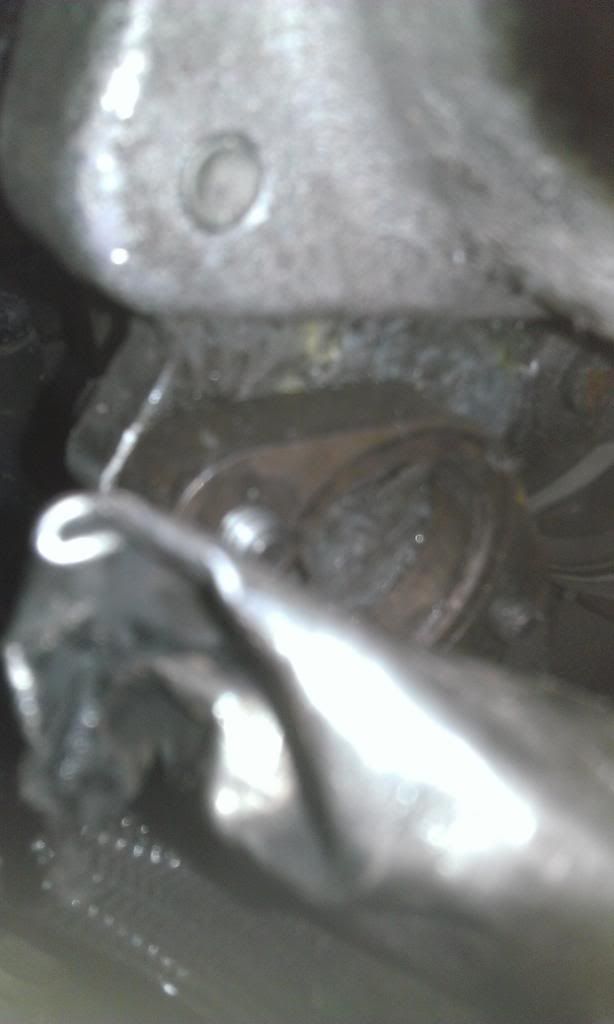

Its been a bit lumpy on start up so i took the black cover off and noticed the silver pipe coming off the Egr valve is damaged. Can i just buy that pipe and replace it or have i got to buy the whole thing?

Would this cause it to be lumpy on the start up then guys ?

I got no idea what that mangled piece of metal was. Any chance of a clearer pic showing what it is actually attached too?
If the EGR pipework is leaking gasses yes it could cause issues

Its attached too the egr valve ,I guess the pipe is meant to run to this in the picture

Umm i been reading the site there's lot info fair play i come cross a page about blanking the egr valve off do you think this was a attempt at this ?
I seen that you can un plug the blue wire behind the egr valve or blank the black pipe ?

What a mess :/
It LOOKS like the EGR valve pipework isn't blanked, but exhaust gasses should be sealed by the EGR valve itself when it is closed. To make sure EGR is disabled and stays closed, remove the blue plug from the EGR electrovalve as you mentioned. Then, you will notice on the EGR electrovalve is two rubber vacuum hoses, one goes to the EGR valve and the other goes to the vacuum source. Disconnect the rubber hose that goes to the vacuum source from the EGR electrovalve and plug the rubber hose with a bolt and some sealant.
If you have a KWP2000 or Galetto I can even remove the EGR function from your ECU completely but it is optional. Just doing the above only causes a hidden error code so no real need to do this.
On the inlet side, where the pipe should go into (the hole) should be an opening, but yours looks blanked somehow, or full of EGR gunk.... I can't tell it looks a bit weird. Either way it will need to be blanked on the inlet side too if not already otherwise there will be boost leak (poor running & smoke).
Hope this makes sense

If you (or anyone else reading this) decides to blank an EGR valve by removal, make sure the plate used on the exhaust manifold is at LEAST 5mm thick of decent steel! The inlet side should be fine with standard fleabay blanks.

Thanks rlees85 done that now fingers crossed i will try it in a hour or two when its cooled right down if not back to the drawing board lol

Still not running right at start up going to try glow plugs next any ideas people ?
