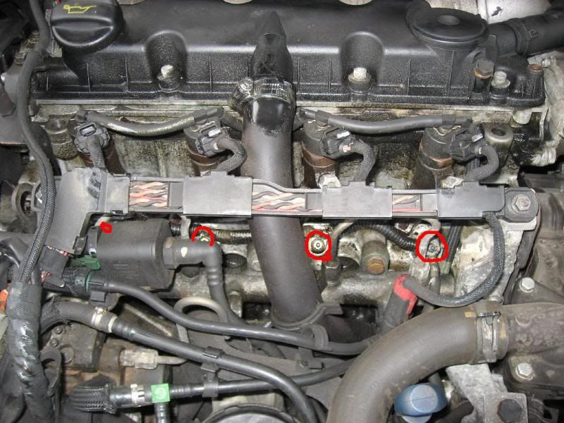

here you go buddy, the glow plugs are circled, there is a 8mm at the top with a wire on it, remove that and then you will see the glow plugs which i belleive is a 10mm, make sure you let lots of wd40 soak in before you remove them

Thanks Troy the picture helped me out alot
