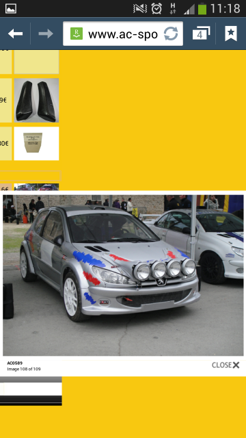

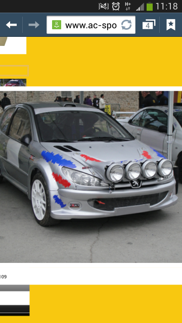

as for the quality of the kit i waa most likely going to use a kit from ac-sport in france. I got my 106 wide wings from them and tho they were far from perfect they were better than some of the crap i saw when the bodykit thing was massive years ago.

My other plan was to fit ac-sports plus 50mm bodykit.
tho this would be much simpler and i love the look of it it doesnt quite look as cool as the wrc/s1600 kit.

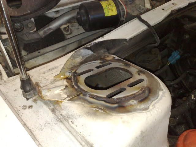

Another idea is that where you have welded in the strut tops we could use the laser cut camber adjustment plates instead. This would give us a little bit of leeway if we get something imperfect.

The ac-sport +50mm kit. I love the looks and it would run on 16" wheels looking at it. That should mean it wouldnt slow the car down and could theoretically be run on my gti hdi which would make a 1600 mile round trip to the alps a bit more affordable.
Here are some pics of the strut top plates fitted to the rallye, its a 6mm plate laser cut and machines with a ten mm or so rebate around the edge to stop them pushing thru once welded in. These could be fitted simply to any car really.
should help with any discrepencies in fabrication
