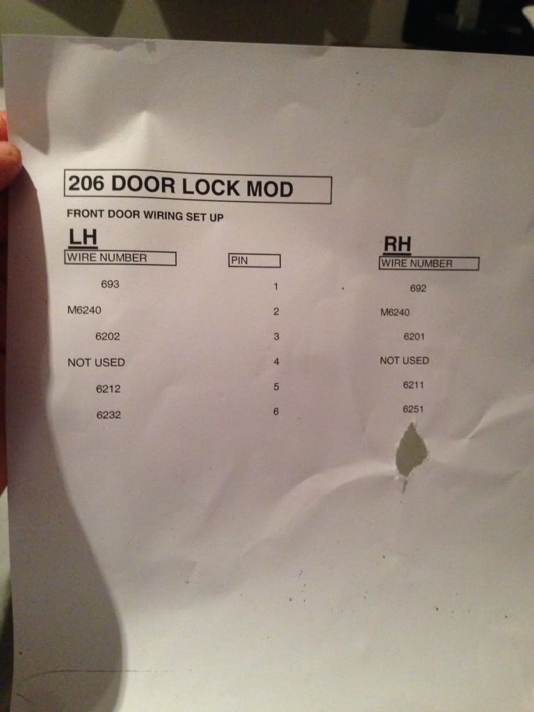

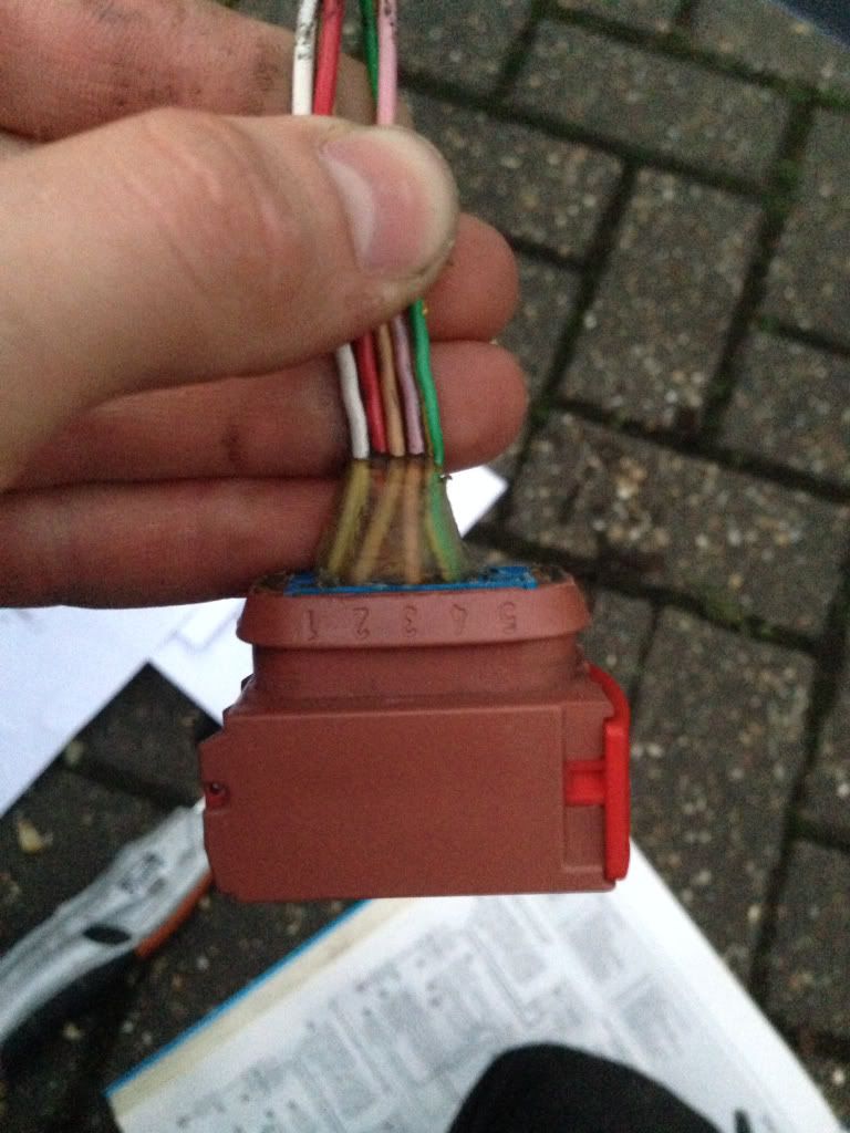

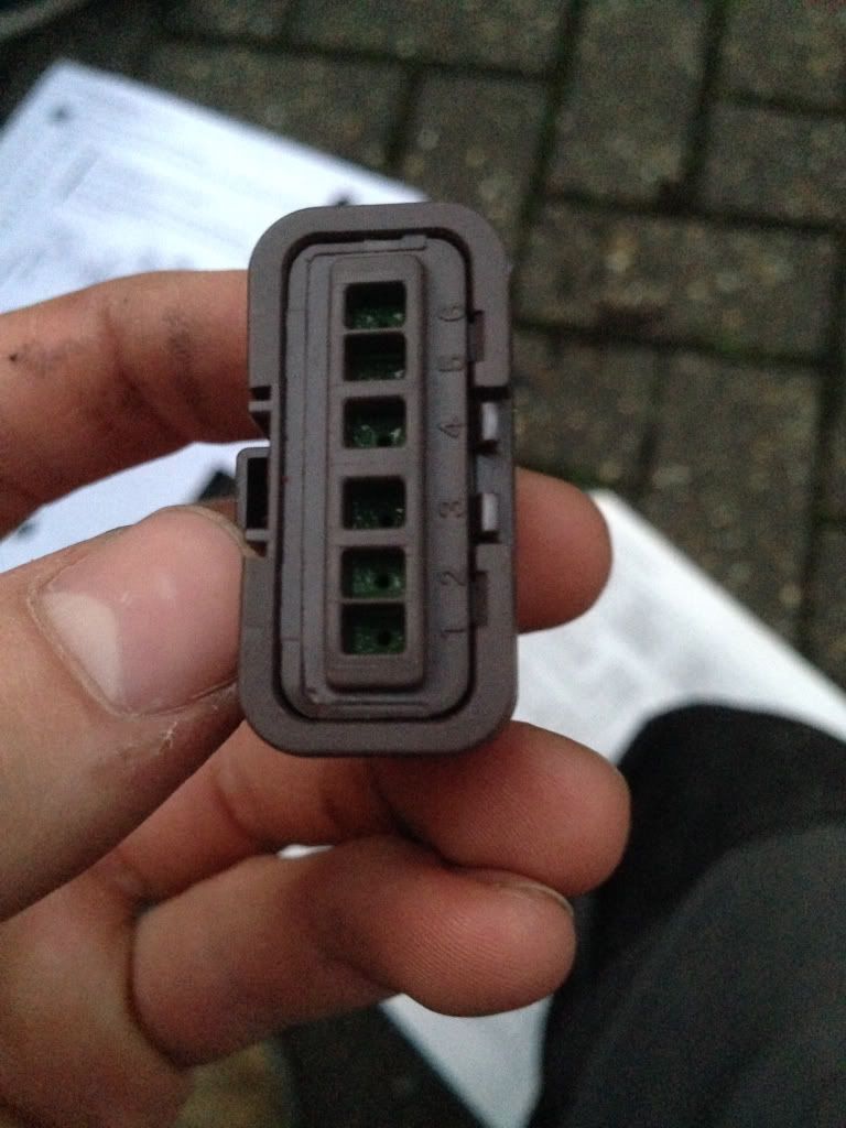

Good eveningggggggg,
I'm after a bit of guidance. Basically I've finally got a new door actuator.... However, it requires me to replace the wiring harness that I already have for a new updated one to fit the new actuator I have.
Here's my problem... The wiring scheme is basically done by number but the wires in my car have no numbers/not readable numbers.
If anyone has done this before then I need help, need to sort this so I can sell the poor thing aha.
Anyway. Thanks for your help in advance
Here's the current wiring harness:
Here's the new harness I need to wire:
Here's the wiring setup I need to follow (right hand door):

Cheers for the reply macca but the adaptor I have is a 6 pin? 5 wire?
PostPosted: Mon Oct 21, 2013 5:16 am Up
Then you have the simple (Non deadlocking) wires.
The pins used for that one are 2, 3, 4, 6, 7. Wire codes and colours are the same as above. Basically brown is the solenoid and orange the switch.
The numbers should be stamped on the wires, I can see some in the picture. You might need to look further up the loom to make them out clearly.
I'm guessing it's the front door from the picture you have put up of the sheet of paper.

ahh okay, how come the sheet I got from Peugeot is telling me to put the 692 in number 1? im stupidly confused, apologies if im being a noob.
I have tried looking further up the cabling but the tape residue seems to have smudged everything on them.
it is indeed the RH Front door,
Again, thanks for replying!
PostPosted: Mon Oct 21, 2013 8:42 am Up
692 is the cable that runs from the BSI and joins onto 693 (guessing the cabin loom and the door loom numbers)
Surprised that any Peugeot part isn't a straight swap.
If I was doing it I would do
Old connector New connector
Pin 2 --------> Pin 3
Pin 3 --------> Pin 6
Pin 4 --------> Pin 2
Pin 6 --------> Pin 1
Pin 7 --------> Pin 5
Only thing I can think off for the different connectors is that they have changed the design of the actuator.
Have they supplied the correct part? It should be 9136** (7 variants)

Well basically I got a second hand actuator from the scrappy but apparently Peugeot reckon they changed the wiring loom connection late 2001 or something? So I need the new loom to modernise it. I'm not at home this evening but shall check the part tomorrow then give the wire suggestion you've given a go. Really appreciate your help mate
PostPosted: Tue Oct 22, 2013 4:44 am Up
Peugeot changed the electrical system in 2001 from pre-plexed to multi-plexed, so the connection will have changed then.
This is about the best I can do to show you the difference between the 2, but it should help you get the wires in the right place.
