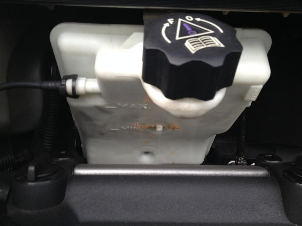

cheekyage
PostPosted: Tue Apr 08, 2014 4:52 am Up
Joined: Jan 22, 2013
Posts: 94
Location: Australia
Noticed these brown coloured dried up spots on the coolant reservoir.
