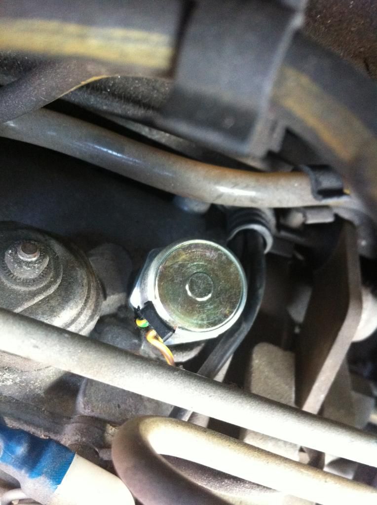

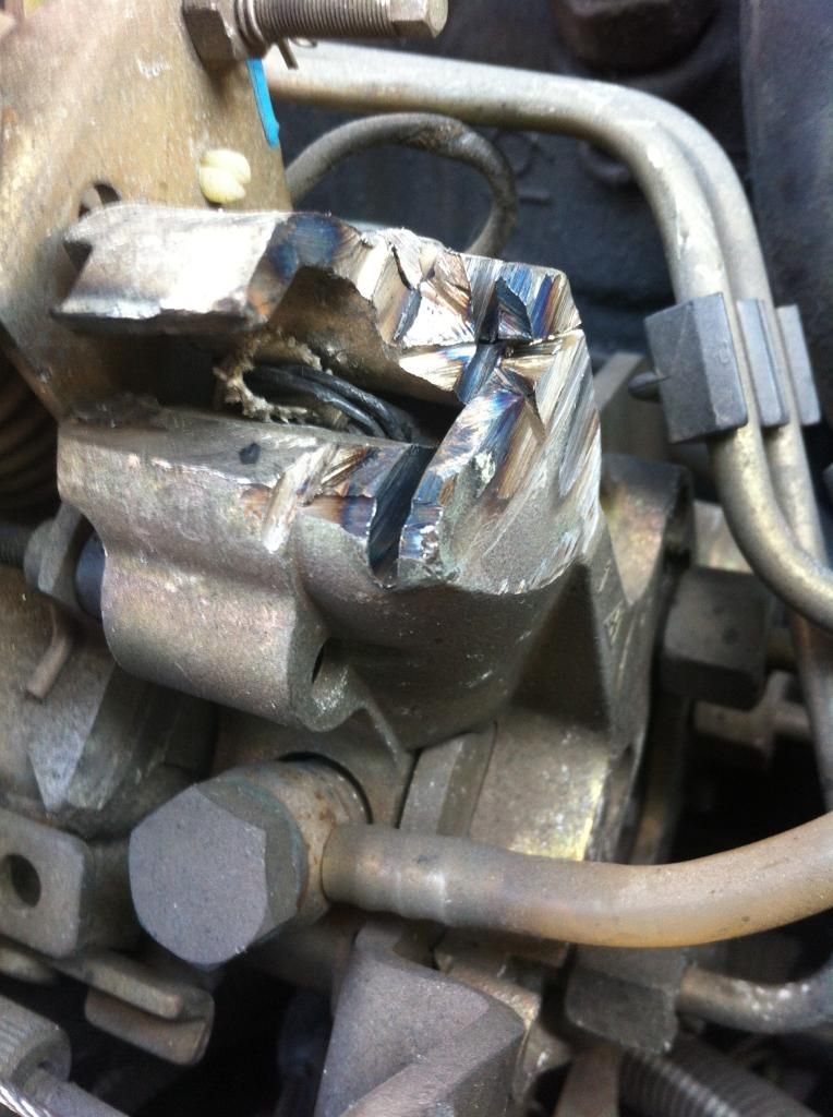

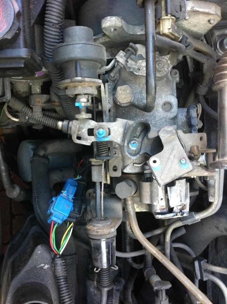

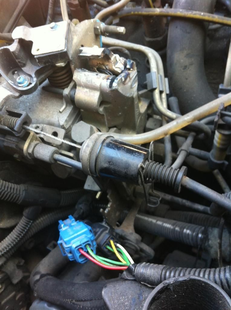

Here are some photos of the fuel pump fitted, as you can see i have cut the security shield back to try and gain access to the top of the fuel solenoid but have been presented with 3 small gauge wires...?
I need to get car running ASAP due to my mothers hip and her lack of getting around.
Any help would be much appreciated!
Many Thanks
Sam

I have managed to test the wiring and supply the cut off solenoid with 12v and earth out the plunger, When supply given I can hear the solenoid clicking.
I then cracked the injectors off and hardly any fuel is coming out.
I then have removed the line taking fuel to the filter housing and when cranked no fuel comes out of the line.
I checked the sender pump in the fuel tank was getting power, when cranked its getting 7.8v. I then gave the sender a 12 v feed and earth from the battery in situe and it didnt pump anything...?
I beleive this to be the cause of the problem, but just wanted to check that this is actually a pump that lifts it to the high pressure pump in the engine, rather than just a fuel gauge sensor.
And that the high pressure pump doesnt suck the fuel up...?
Any comments appreciated
Thanks
Sam

I have removed the fuel cut off solenoid due to it ceasing to operate now even with a direct feed and earth.
Can anyone recommend where to purchase a replacement? I have looked on eBay and there are a few but I'm not sure if there are different plunger sizes or length?
Thanks
