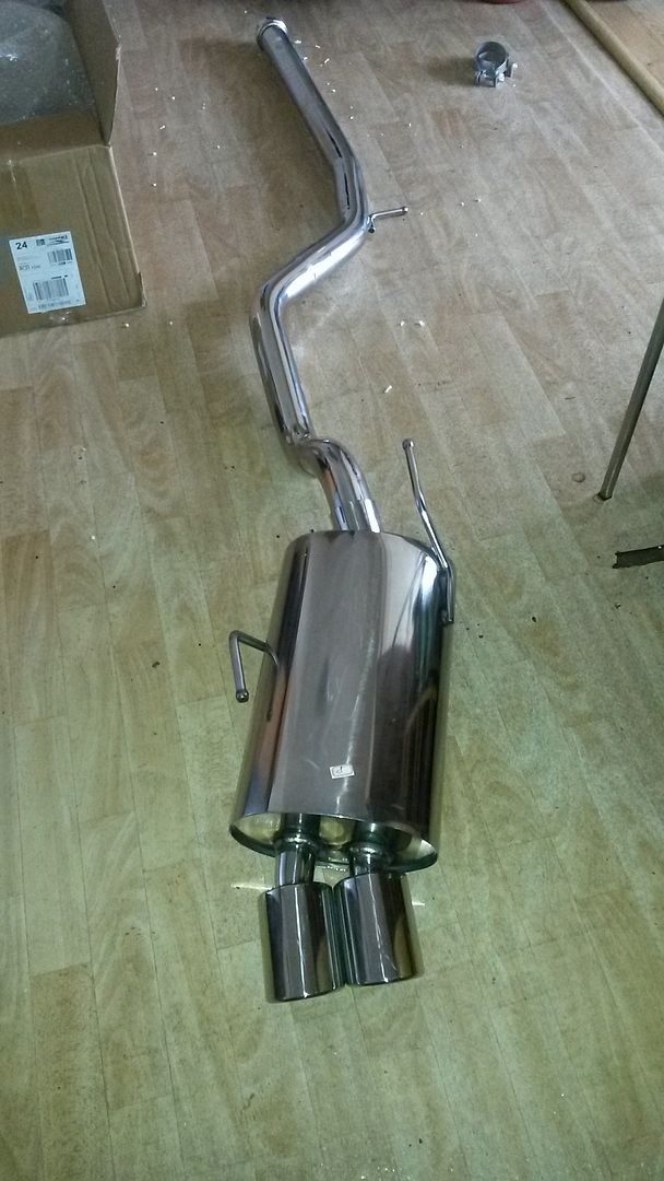

might be a problem to fit or it might not. Only one way to find out. Will install when time

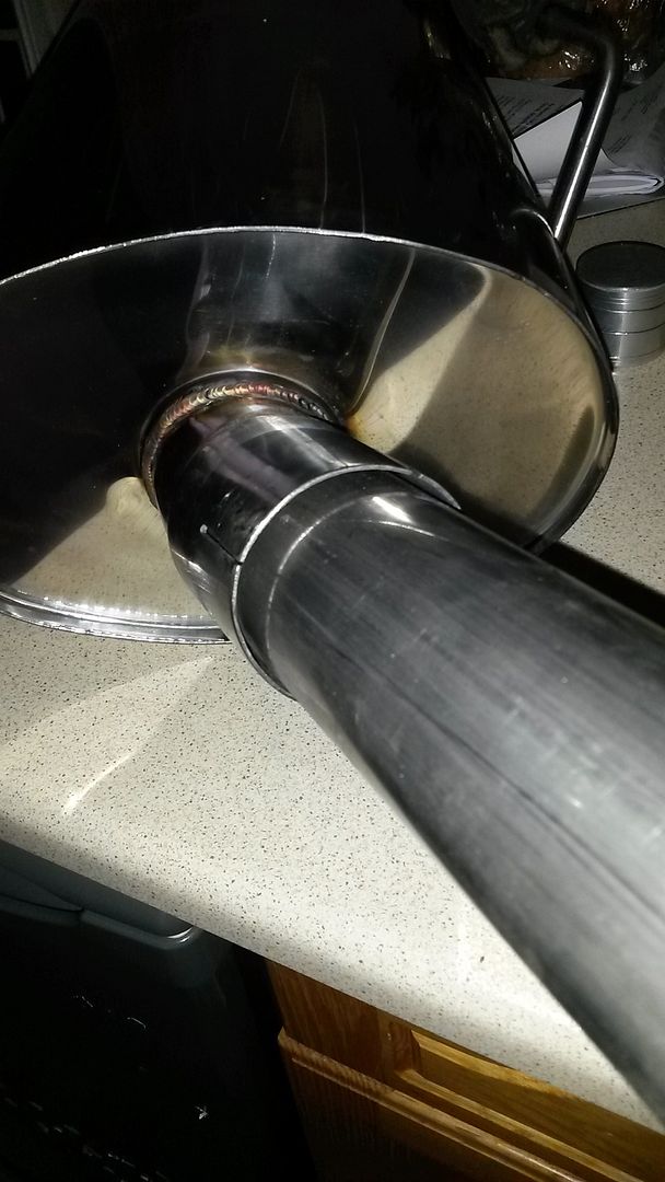

Not the best fitment for the joints as it's blowing from the back box . Lines up perfect.
I'm just addressing the 63mm inlet to the back box & the 60mm pipe toyo expect you to Fit. .

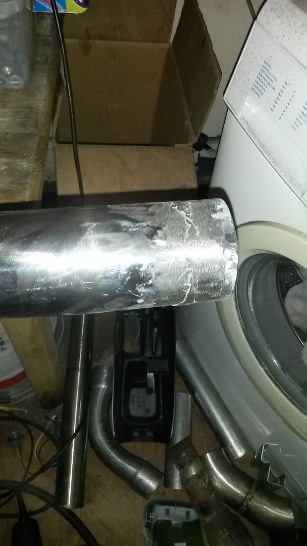

It was listed on ebay I've not seen one before with a straight through middle. It is 3 sections cat back. It's loud .
I welded a extra inch of 60mm pipe on the end of the exhaust to get the back box to fit perfectly .. Toyo pipe is thin & under 60mm.

60mm pipe to show the gap. Was worse with the toyo pipe.

I used the extra pipe to get a good seal with Clamp. also positioned the exhaust tip exactly where I wanted them.
