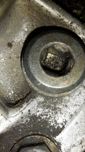

Wanted to drain my gearbox oil this weekend, but after a poke around it seems it is a 6mm square drain plug (there is no socket sides to the plug).
Does this sound correct?
Any idea where I can get a 6mm square socket from?

Ok, so its definately NOT 8mm lol.
I have an 8mm sump plug key, which fits my engine oil sump plug no bother... I've tried about 5 times now and it isn't going in the gearbox drain plug!
Went into Halfords this morning and all I could find was square keys starting from 8mm upwards!
I took a pic to make sure I'm not going mad, this is a square key isn't it?
Aegean Blue 1.6 16v Sport

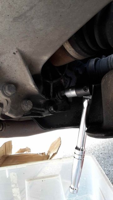

Done! The socket must have had a galvanising layer on so was a touch too big... small bit of filing and a hammer and it went in and knocked off fine.
Old oil was horrible, black and smelt burnt as hell.

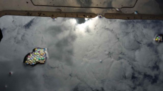

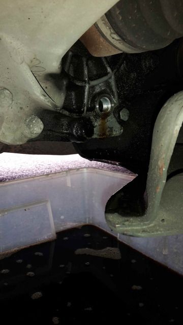

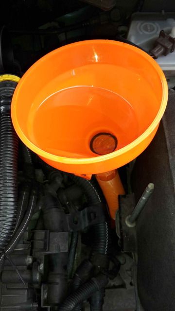

In..
Off..
Out..
In..
