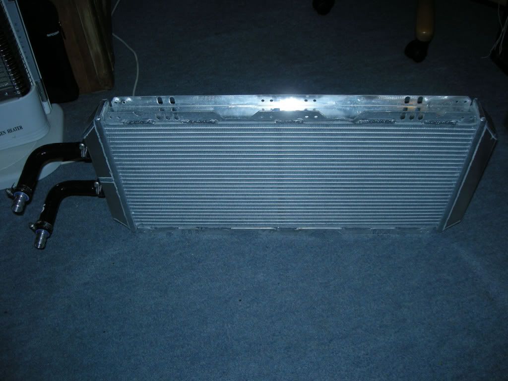

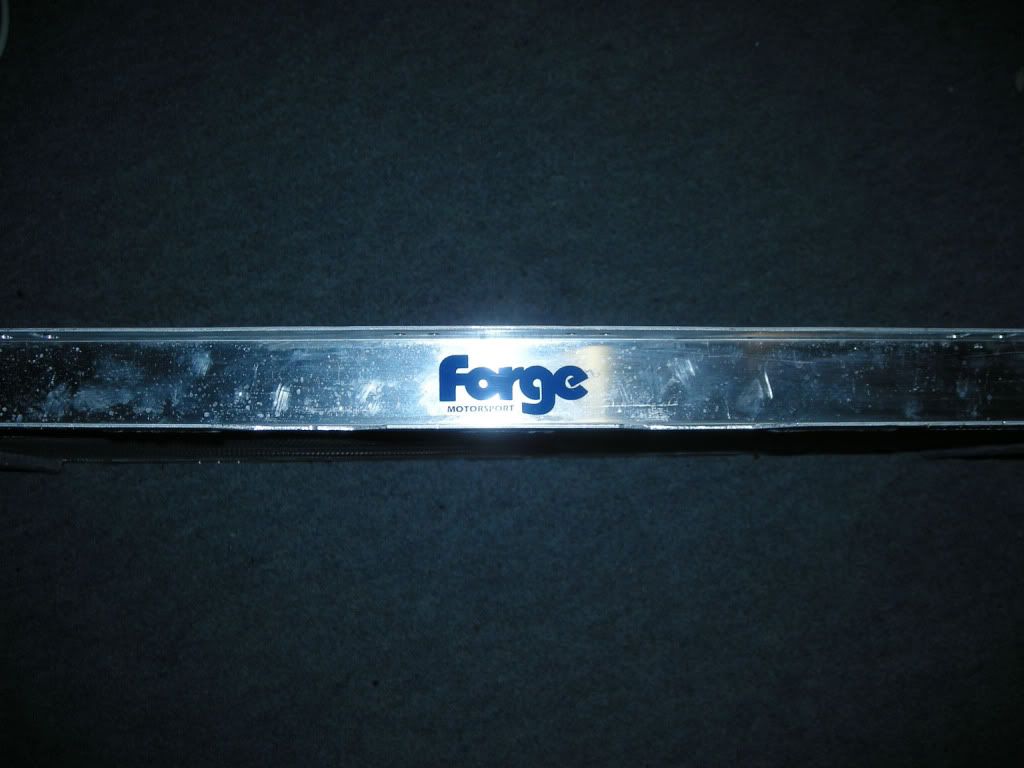

Charge cooler rad has arrived though, looks neat. It was custom built by Forge Motorsport to a design made up by a friend who has just supercharged. This is the second one to be made, has 50% more capacity than the pro alloy version so should show a significantly higher cooling than the normal ones people use, and is dual pass rather than single Smile
