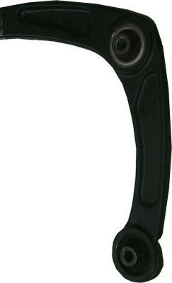

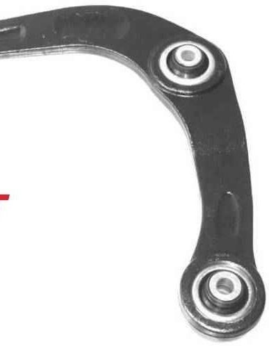

The main visual difference is that sports models have metal enclosure around rubber bushes:
as opposed to
EV (roadtripper)

Not quite true. Sports range wishbones have one metal bearing and one rubber. Normal models have two rubber bushes.
Peugeot Sport Group A parts have two metal bushes.
