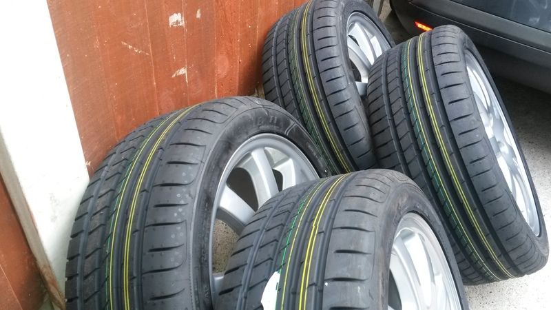

Ooh a bit more spending....this can only mean one thing!
LeeThr
PostPosted: Fri Mar 11, 2016 1:28 pm Up
Posts: 2596
Trade Rating: +17
Location: North West Wales
New rubber? That mean it might get a bit further than the end of you drive sometime soon? Surprised
gogs_macaulay wrote:
LeeThr wrote:
The garage
I must be mad.....
PostPosted: Fri Mar 11, 2016 1:43 pm Up
Yep. Didn't want to fit new tyres if the car wasn't going to be used as they just age....so now that the weather is looking better I'm going to get it used.

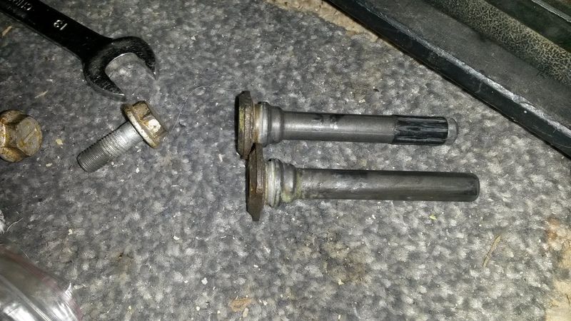

£14 spent the other day. I noticed ages ago that one wheel was slightly difficult to turn by hard. The caliper was sticking slightly but the sliders were free to move when the caliper was removed. As soon as the slider bolts were tight it stuck again.
So I ordered some new sliders from Brakes International for £14. Problem fixed!
The old sliders did have some polished marks on them so that could suggest they weren't 100% straight. Who knows.
