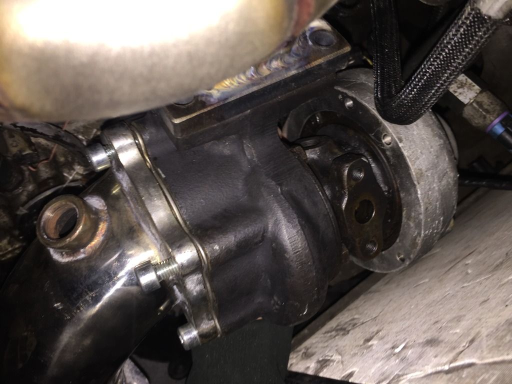

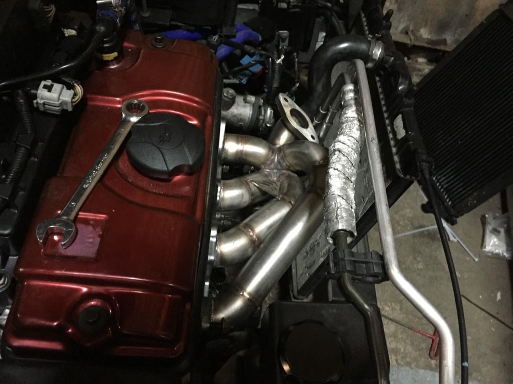

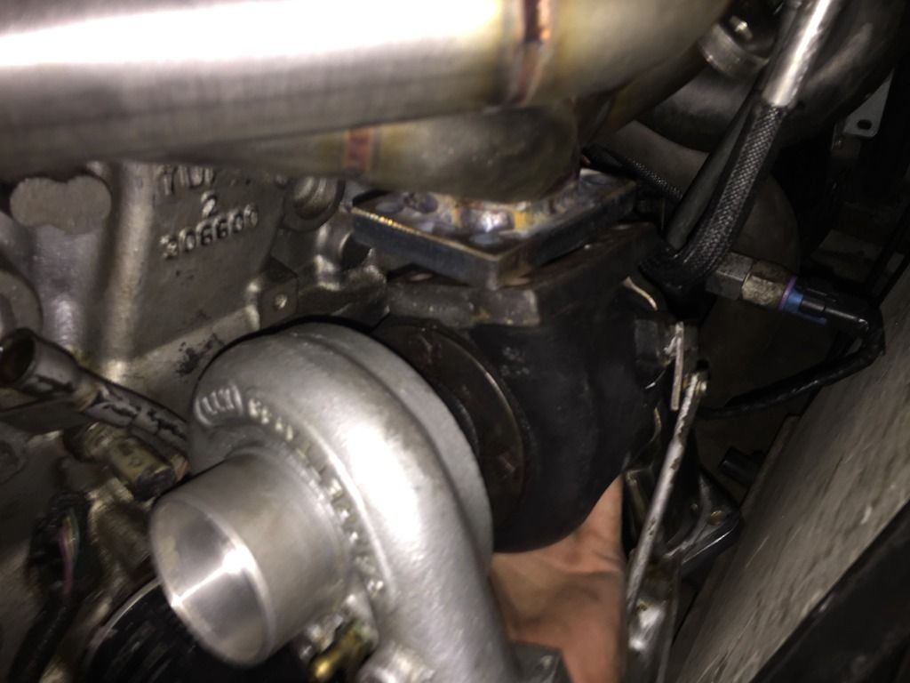

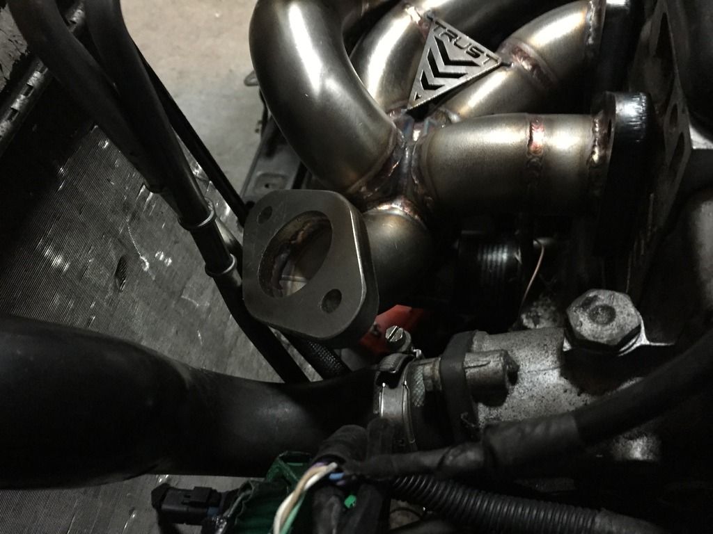

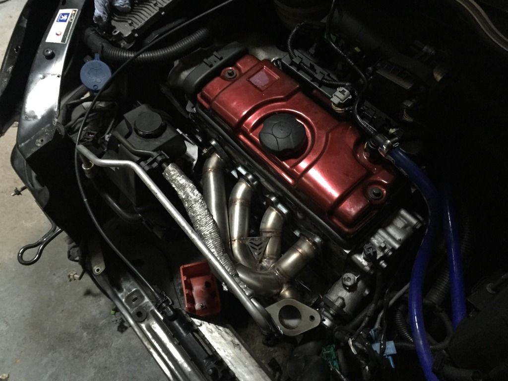

A bit of progress today in the way of test fitting the manifold and offering up the turbo. I have ran into a few issues as you can see below.
I taken out most of the studs on the head to just about squeeze it past the power steering pipes (which I have always considered to be an eyesore). At first glance you may think it looks fine, but the external wastegate flange fouls the pipes. I need to consider my options in either getting the pipes replaced with custom made ones, or finding out if there is another 206 or PSA model that has the power steering pump on the same place but with the pipes routed down the left hand side of the engine.
The next slight concern is how close the external wastegate flange is to the radiator hose. I am going to get the manifold ceramic coated at some point and hope that the radiant temperature doesn't affect that hose.
And wait - there's more! If I offer the turbo up with the hot side on the right, it fouls the block and line up with the flange.
If I offer it up with the hot side to the left, the downpipe piece sits nicely and it mates up to the manifold flange. However, it leaves me very little room for fitting any pipework from the impeller to an intake filter, as you can see on the very far top right of this picture the radiator hose bend is in the way.

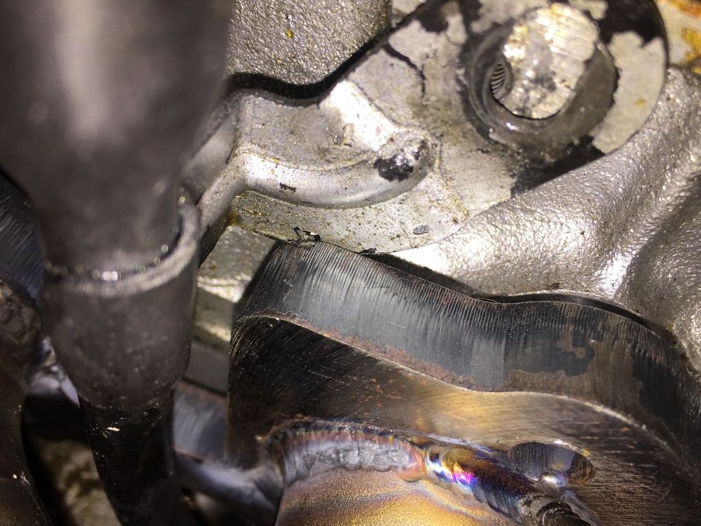

Lastly, although minor, the dipstick mounting blocks the manifold seating onto the face of the head, which can be sorted by grinding some of the mounting to suit. Everything looks a little dirty right now but I intend to get everything painted properly once the initial teething issues are sorted.
With what I have learned today, I am in half a mind to sell the turbo in favour of a smaller GT17 that is more likely to fit in the space without impacting other components. The guys who made my manifold recommended a GT17 for my car. As this is an excerise and learning curve for a bit of fun rather than a quest for balls-out power, I'd be happy running a turbo capable of 7-10psi.

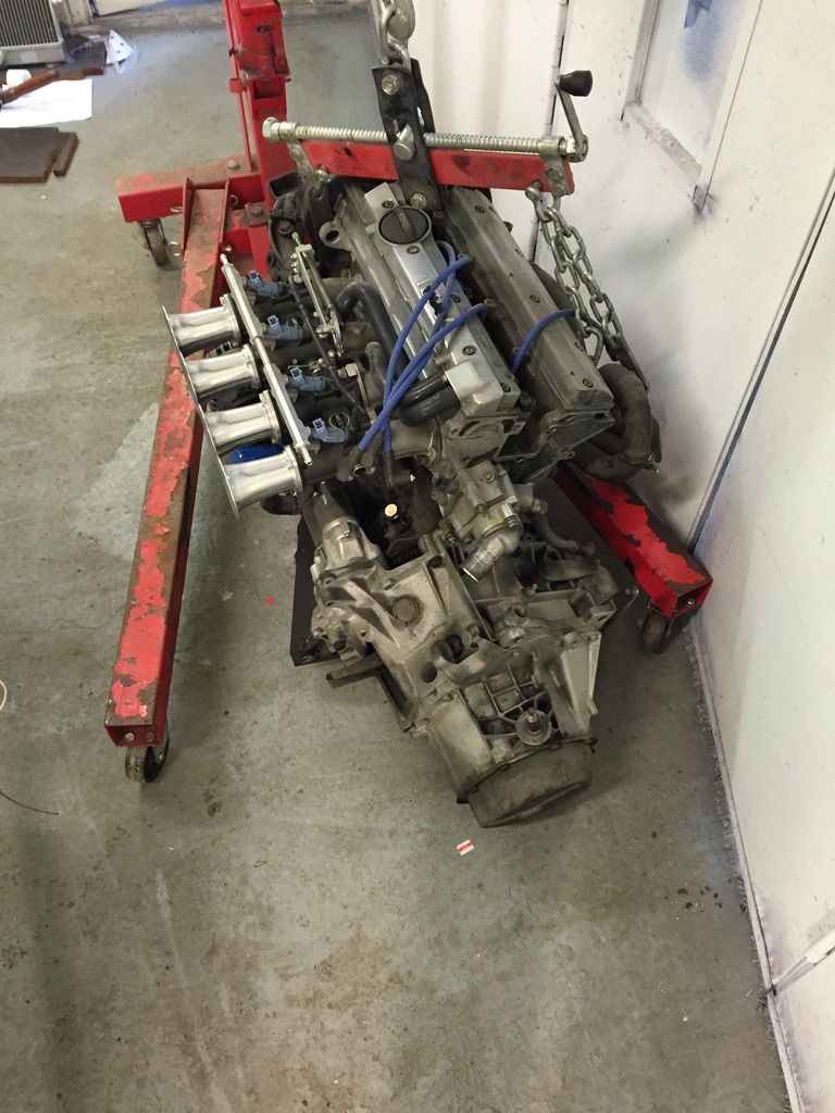

A massive change in plan has come about, as a result of being offered something too good to turn away. So this is the end of the 8 valve turbo dream.

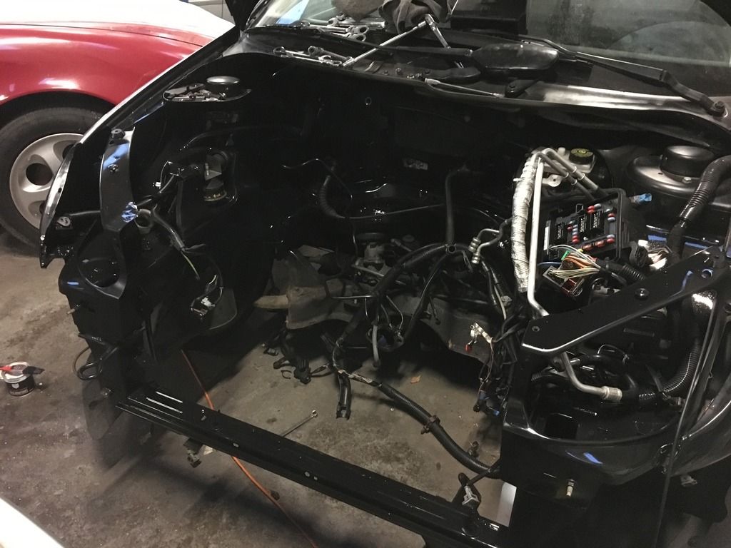

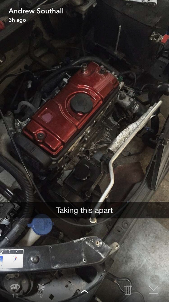

So yesterday I started clearing things out of the engine bay for a couple of hours, ready for the block and gearbox to be removed.
Hello sweetheart.

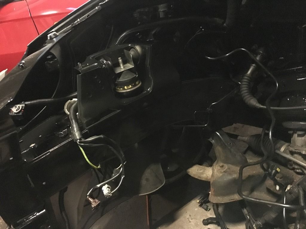

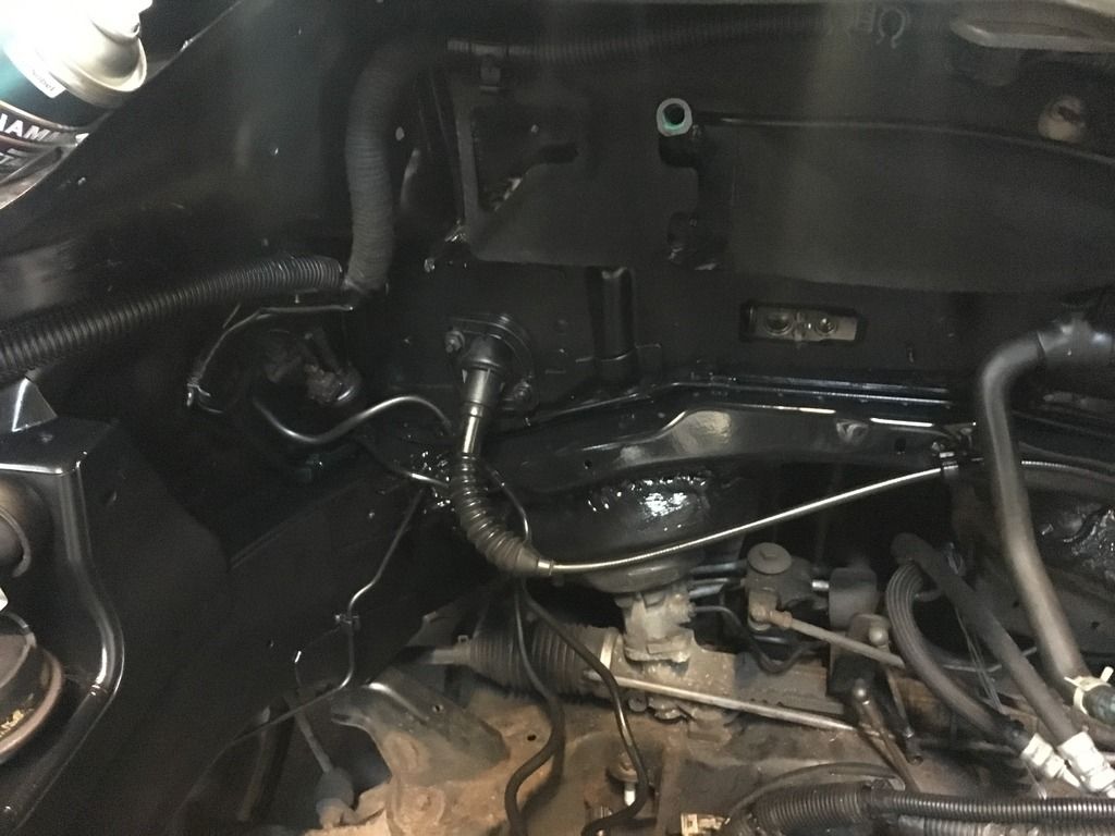

It's been much longer than I thought with updates. The last two days I have degreased the engine bay, keyed the surfaces and painted in Satin Black. Originally I wanted a professional spray job but would rather save the money for the little things that will be required to get the engine running - my patience for the lack of progress has worn thin as of late.
