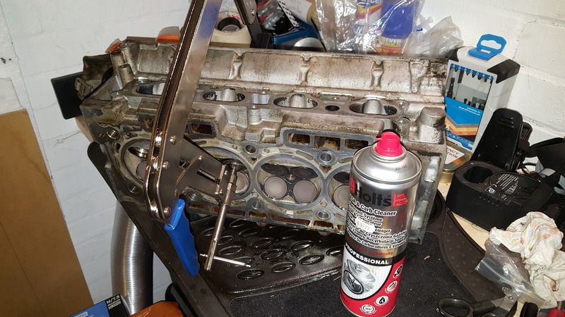

Valves being removed ready to have the cam clearance machined at the lifters

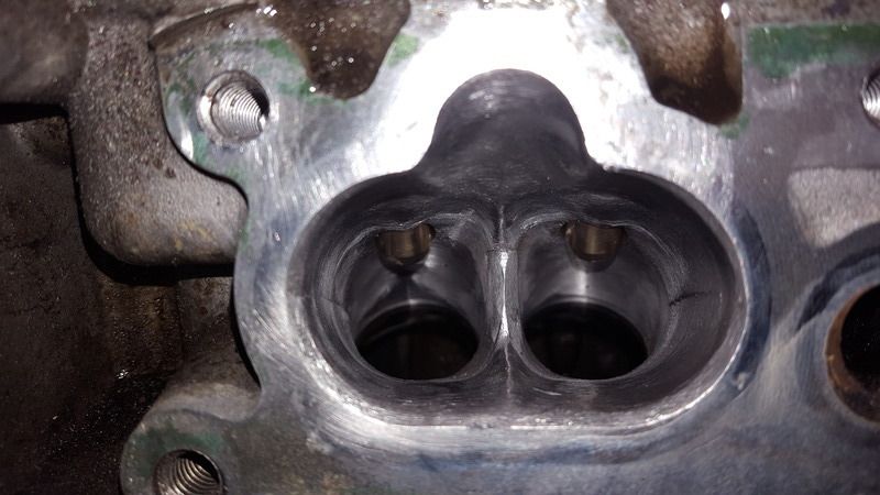

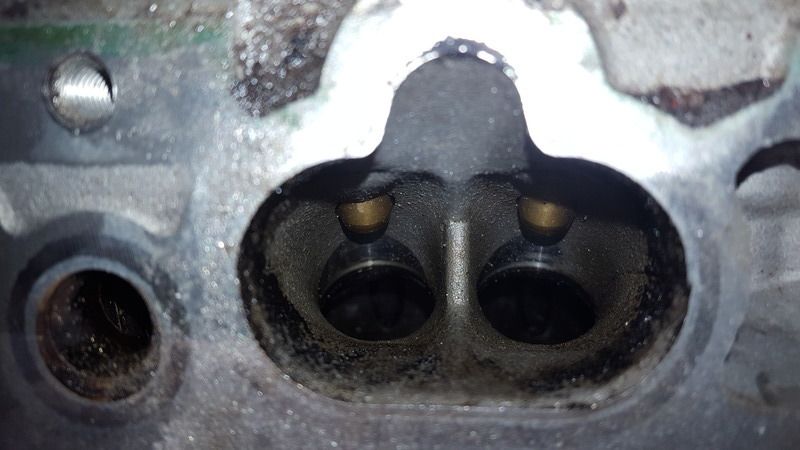

While the head was stripped I thought I might as well spend some time DIY port and polishing. This is definitely a mild attempt, basically focusing on knife-edging the split and polishing the walls to an 80 grit finish. No drastic reshaping will take place. I've done tonnes of reading over the last decade about porting and polishing, this will be my first practical attempt. It's started now, so there's no point telling me I shouldn't have done it...
Before:
During:

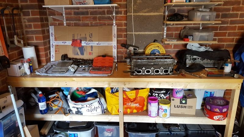

Been in the new house for 3 months. Spent the last few weeks building a decent work bench,
so that's given me somewhere to work on the cylinder head(s).
I bought a standard EW10J4 cylinder head this week with the plan of dropping the Newman cams into that, putting it on the J4S bottom end and just getting the car running again. I finally unboxed the cams that I'd sent to Newman for checking and refinishing about 9 months ago. Turns out they're 264 400 cams, not 420 as Newman told me over the phone. This means they're 10.1mm lift instead of 10.66. The good news is that this means they spin freely in the EW10J4S cylinder head without any machining, which means I might have bought a J4 head for no reason...
Only problem is I started but haven't finished the port/polish on the J4S head, so I either need to put a load of hours into that (hours I don't really have) or fit the standard J4 head. Decisions, decisions...
