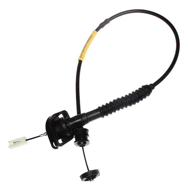

I recently replaced the automatic clutch cable but the bite seems very high. The clutch itself is about 25000 miles old.
The cable I fitted is identical to the one in the photo
Done a bit of web research, there is a lot of mention about a retaining clip that needs to be released after being fitted. I didn't see anything obvious on the cable nor was there any mention on the instruction tab.
