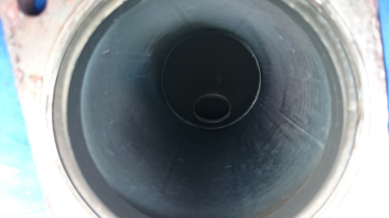

At the beginning, I removed the back piece of exhaust manifold, I took the opportunity to take some picts since last time when I removed the two catalytic's cartridge

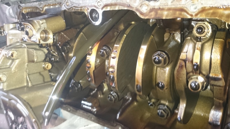

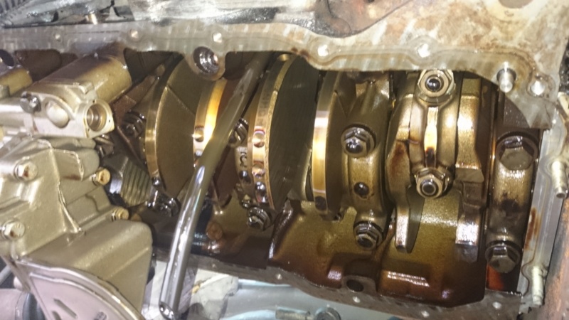

And then, "surprises" began : to remove the oil pan I have to remove the air conditioning compressor (so to remove the accessory belt) to loosen its support (the 4th screw being behind the compressor) then I have to loosen the gimbal's engine support and to play with screwdriver, at the right places, to remove the oil pan Shocked
At the disassembly :
The oil pan :
The crankshaft :

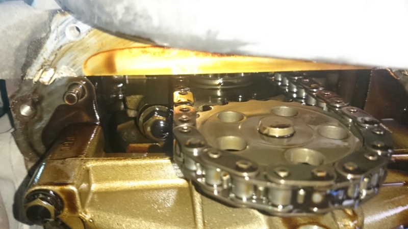

The wheel and the chain to train the oil pump ?
We allways see the marking on the crankshaft !

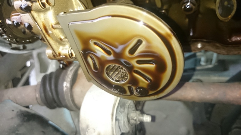

The inlet filter :

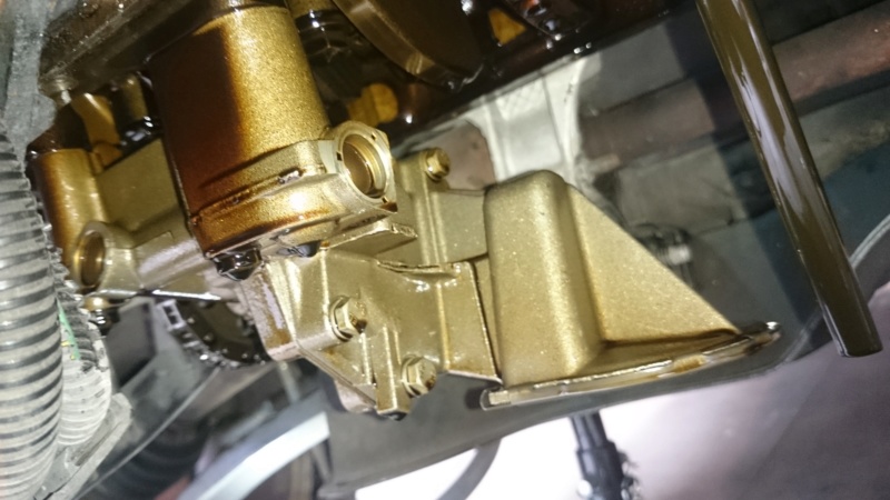

Cleaned oil pan :
Cleaned back engine where the new seal will be hanging :
Cleaned inlet filter :
And then full oil and after 30 min drive, the oil is always transparent Very Happy
