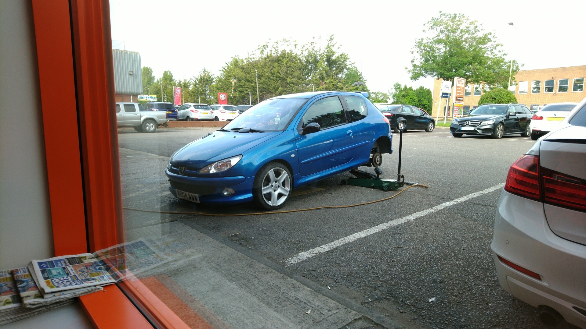

Earlier that day Chris Mullins decided to do a quick job outside their workshop, so I didn't have to wait the whole queue!

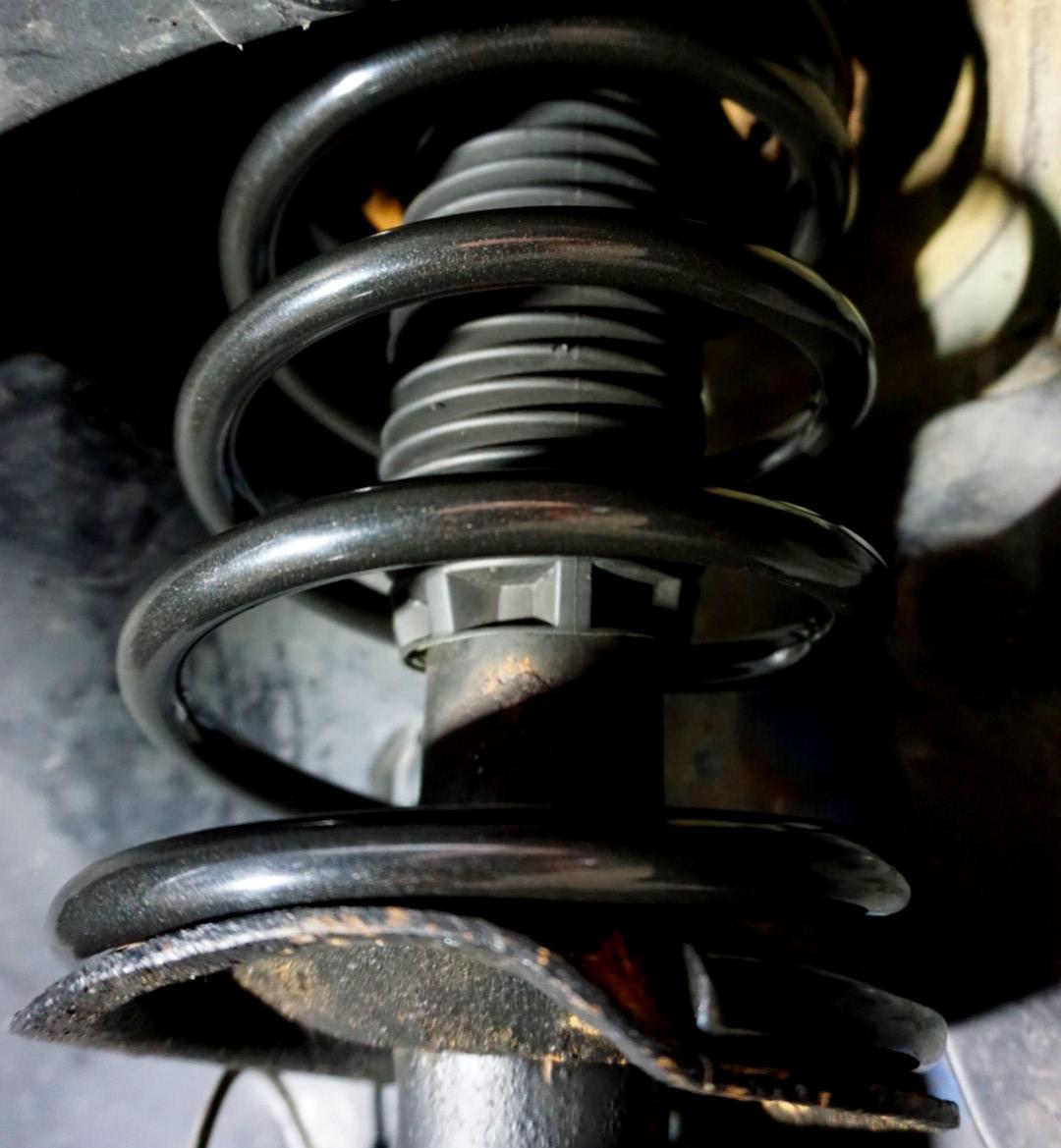

This month was a no-brainer to sort out the harsh ride.
Seeing how stiff the previous owner's FK adjustable suspension was, I've put the blame of the unbearable rattle and clanging even on the slightest of potholes to the offside shock absorber, it was as if a rod's been welded in place of the suspension strut, so I'd thought the shock was shot (read dry).
Also coming from the experience of having fitted AVO adjustables on the HDi, one can barely do the "rock the boat" move, car's front just moves side-to-side when on such static suspension.

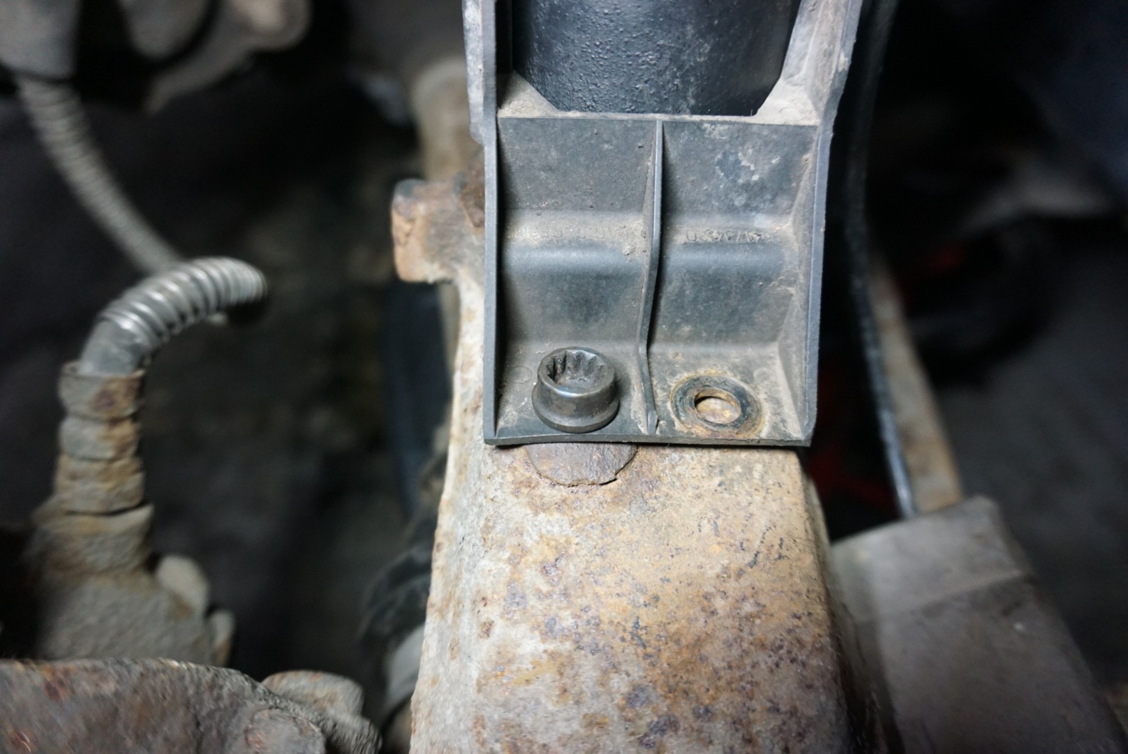

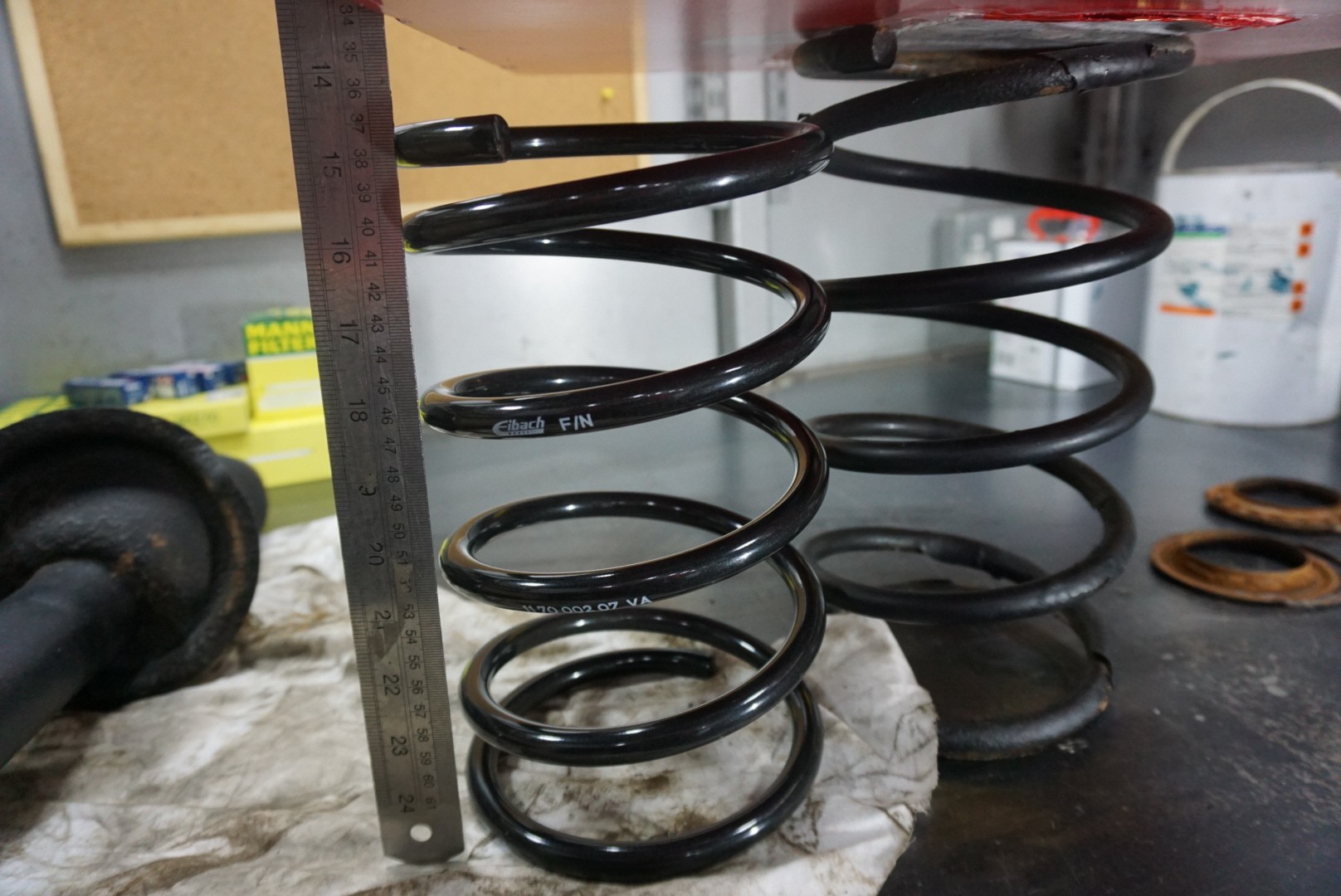

The missing wishbone's bush metal housing (see previous post) only reinforced my theory, and so I finally splurged out on the long-ago planned Eibach springs
They're even TÜV approved, but I still wouldn't be able to cross into Germany because of this Very Happy C'mon Germans, why are you clamping down on the modified scene? Wink
The 30mm difference translates to the promised 15-20mm drop once in situ
(If you ask why I didn't go with a 30mm drop at front -- GTi 180 already comes lower from factory compared to others)

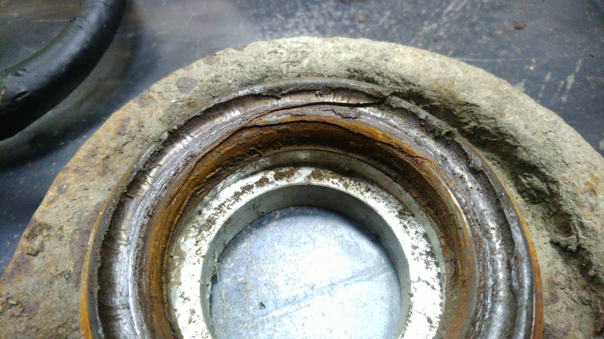

Discovered top mount bearings were barely holding themselves together

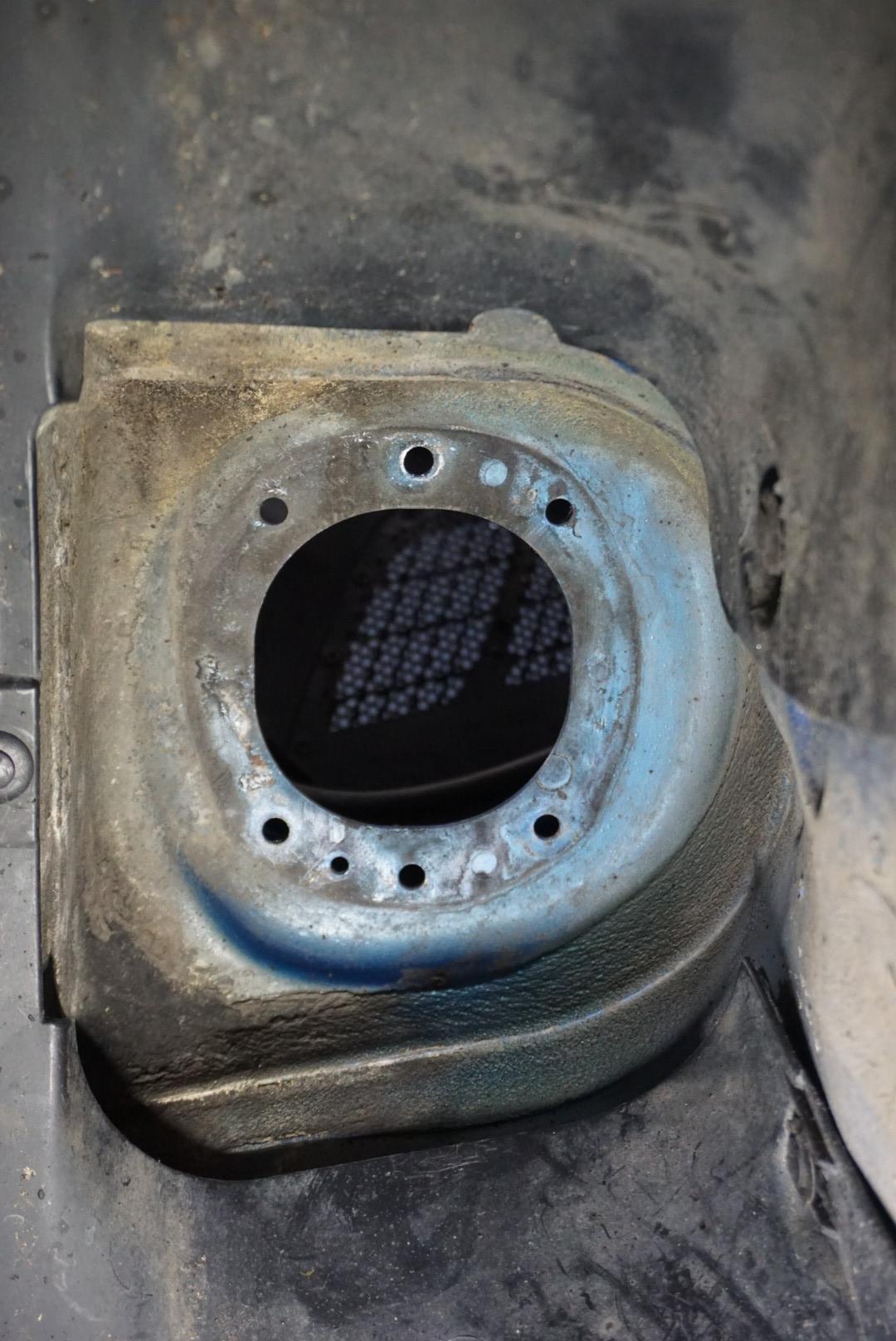

The turret itself has given some confidence in the car not being k-rusty

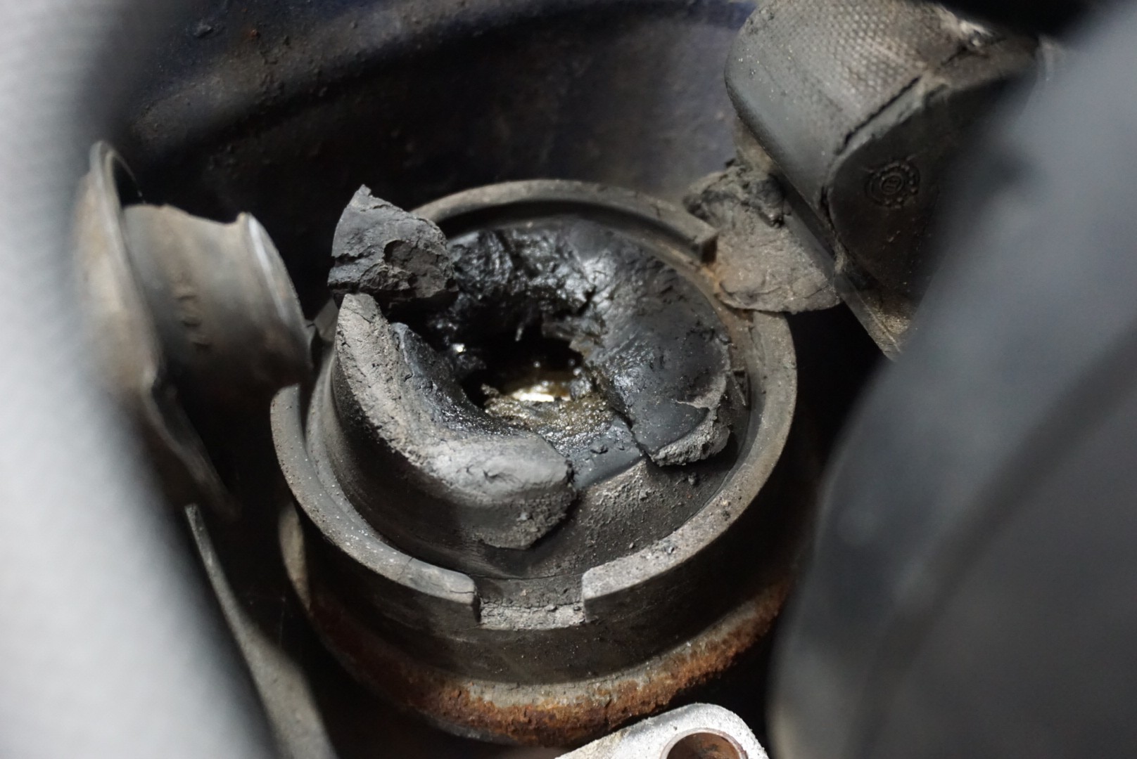

And yet the rumbling didn't go away..... Evil or Very Mad Silver lining: I planned on fitting Eibachs regardless, and in an unforeseeable future complementing them with some damping+rebound adjustable shock absorbers.
It was something else grumbling in the engine bay, was so inconclusive, that all sorts of explanations were going through my head, from a loose driveshaft intermediate bearing, to broken off exhaust manifold -- tests revealed that the grumble is pronounced only on potholes when the engine is running!..

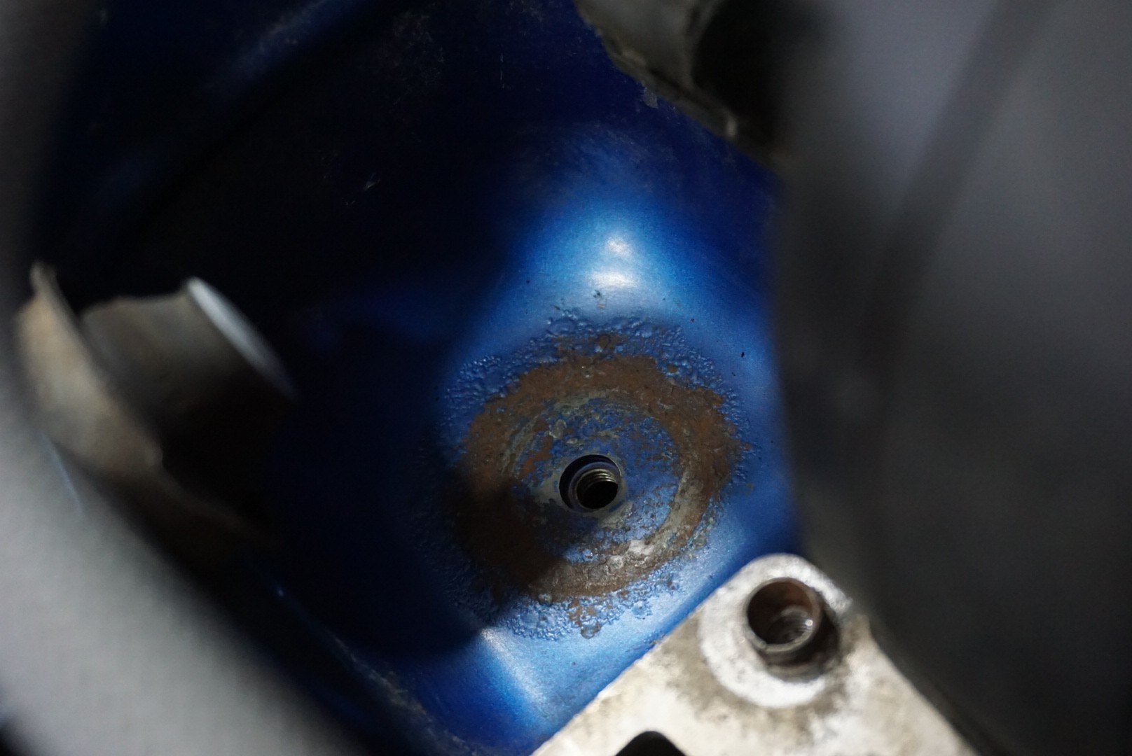

Then after a lot of headache experiments, at certain point I could reproduce it while slightly pressing down on the engine, the rest of the car starts to shake -- engine mount it is! And whaddaya know...
I should've looked there in the first place! (lesson learned Razz )
Revealed some surface rust underneath
Sanded it off and treated with
Some say, it's the best applicant for such places, the rust would never come back. We'll see about that! Wink

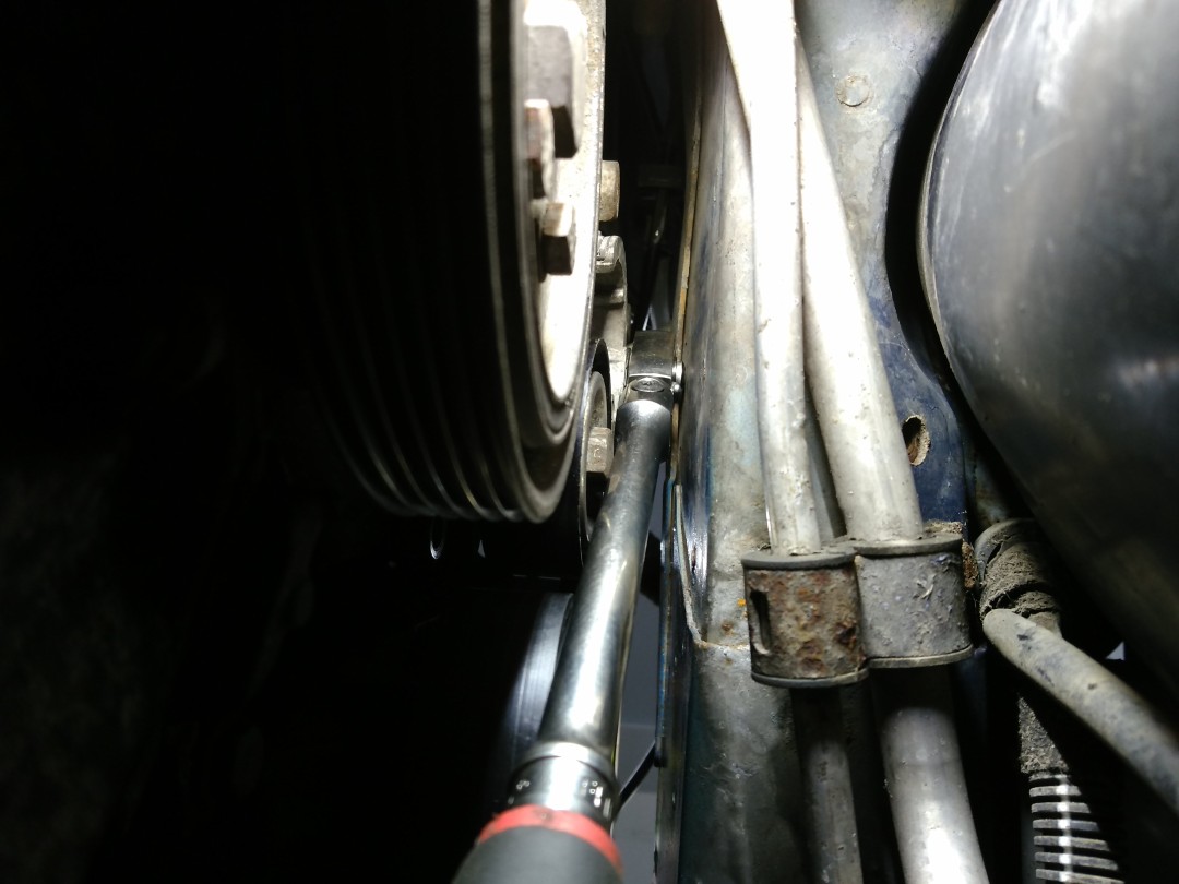

Alas the high pitched whistle remained, and I turned my head (and got bad neck) to the drive-belt tensioner pulley, cursing and using the stubbiest tools I still lost hours while refitting it Evil or Very Mad
Small cars + big engines = love + hate relationship, after bruising your arms you yet again forget the rage once the job is done Smile
The old pulley had some gunk accrued on it in a dotted fashion, maybe cleaning that off would've just helped the whistle to go away? Who knows now! It didn't have too much play or rumbling while turning.
All in all, the new Gates tensioner pulley surely is quiet now.
