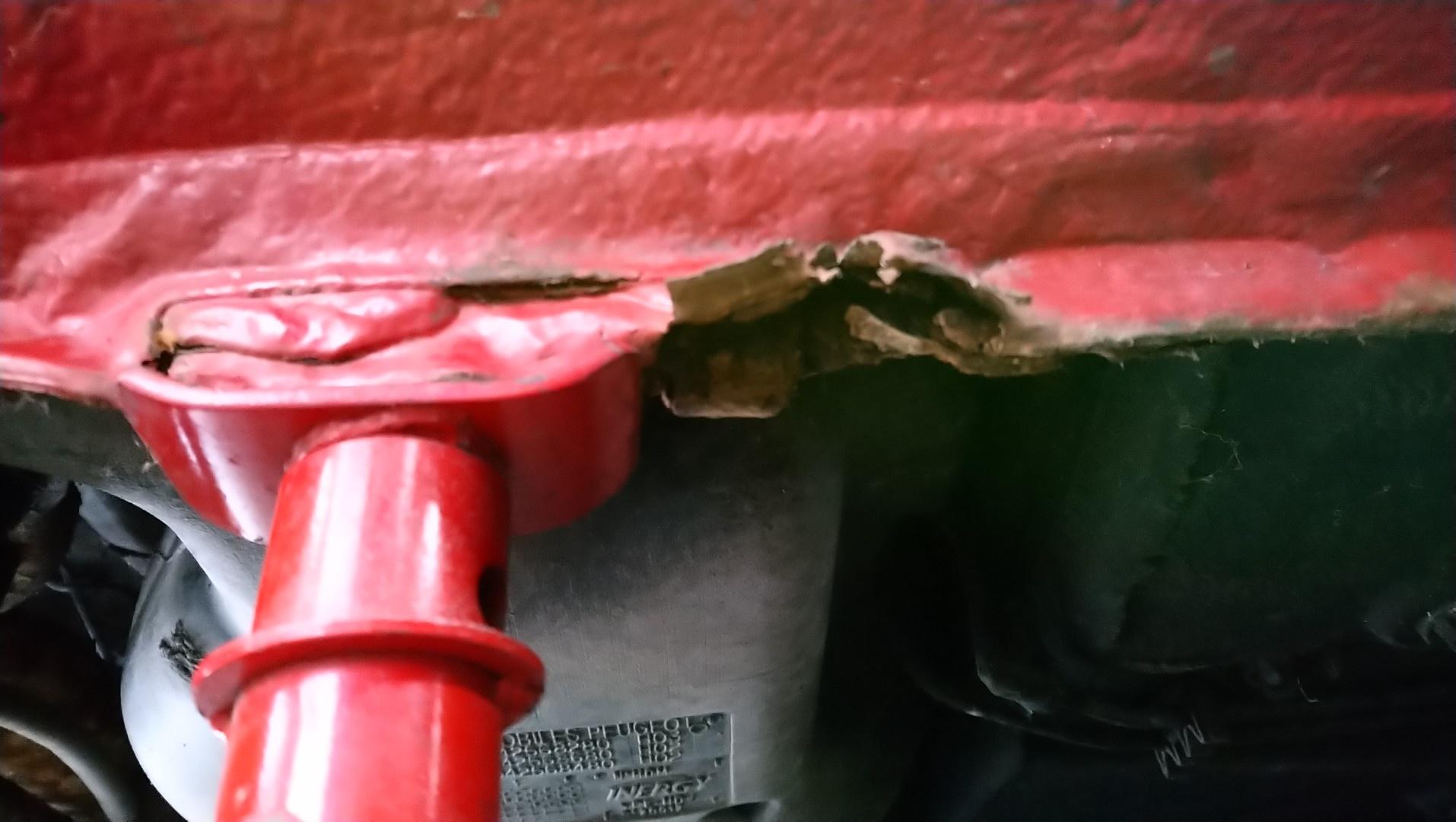

14. Sills?
14. Sills!

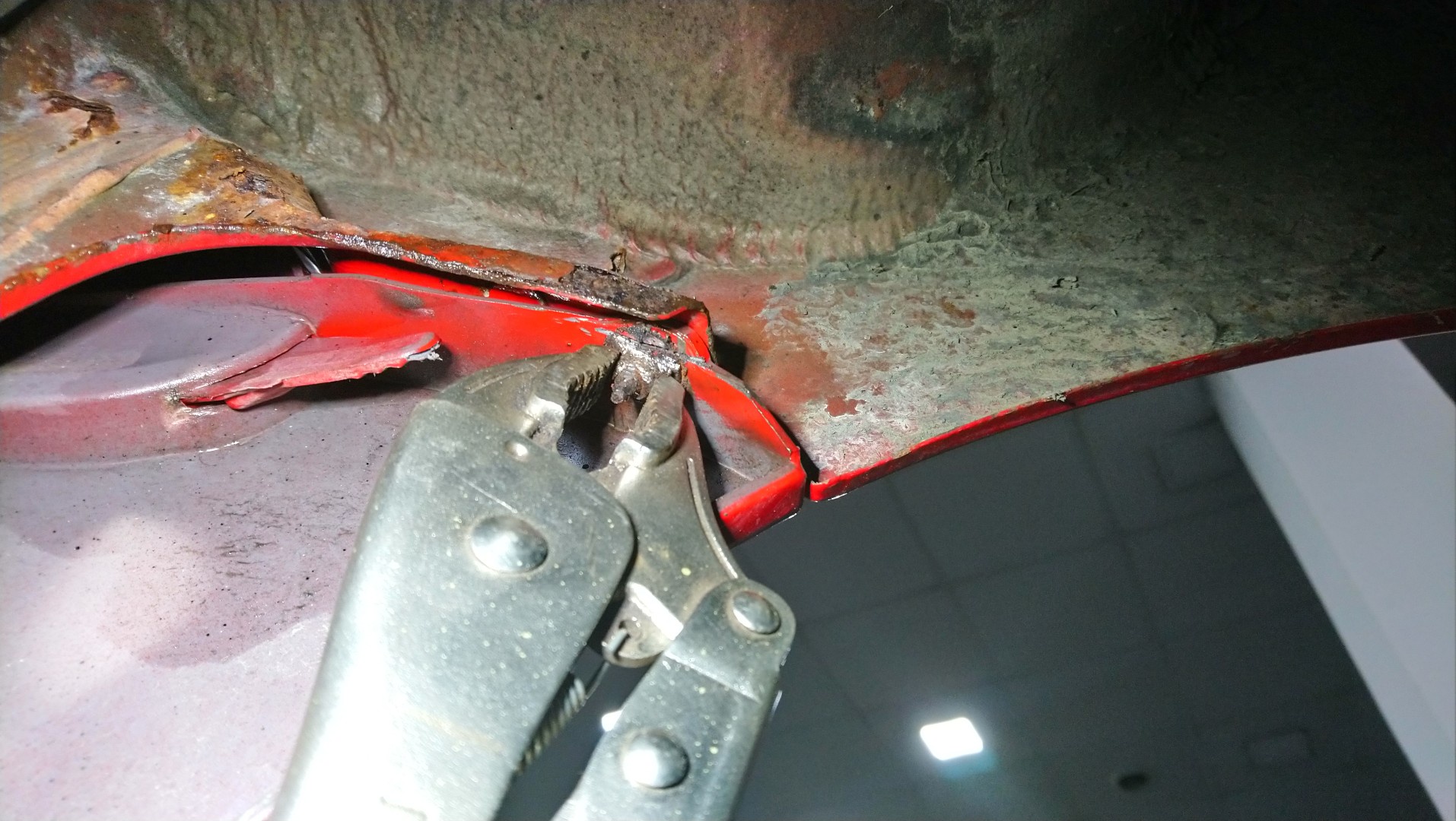

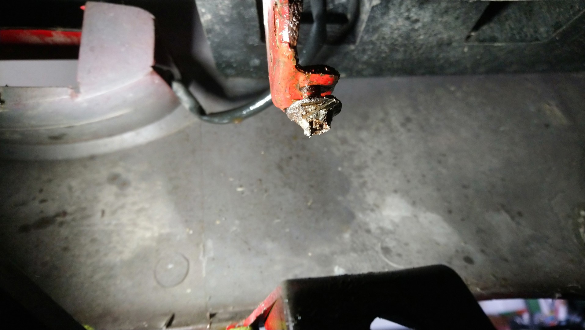

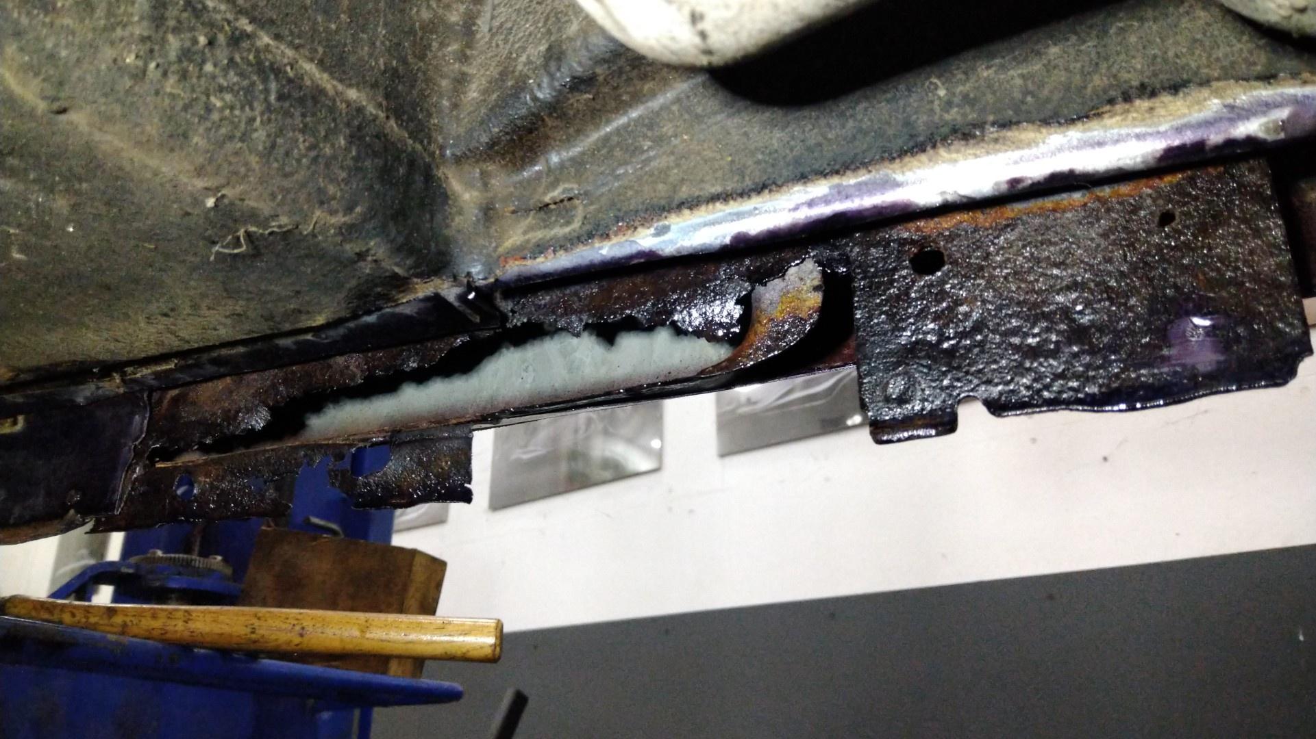

Here's what happened when I placed an axle stand in prep for swapping out the rear beam last year:) Both car and I had a sinking feeling to the slow crunchy sound Very Happy The main jack-point support started bending, because the other layers of metal were no longer existing to support it Shocked
(Don't be alarmed about the incorrectly replaced stand -- to minimise pressure I simply aimed to increase the contact area that was still somewhat held by the rust:) And took precaution not to sway the car off of it;)
Good job we have our friendly garage panel beater Jimmy, who dealt professionally with the matter at hand(s)

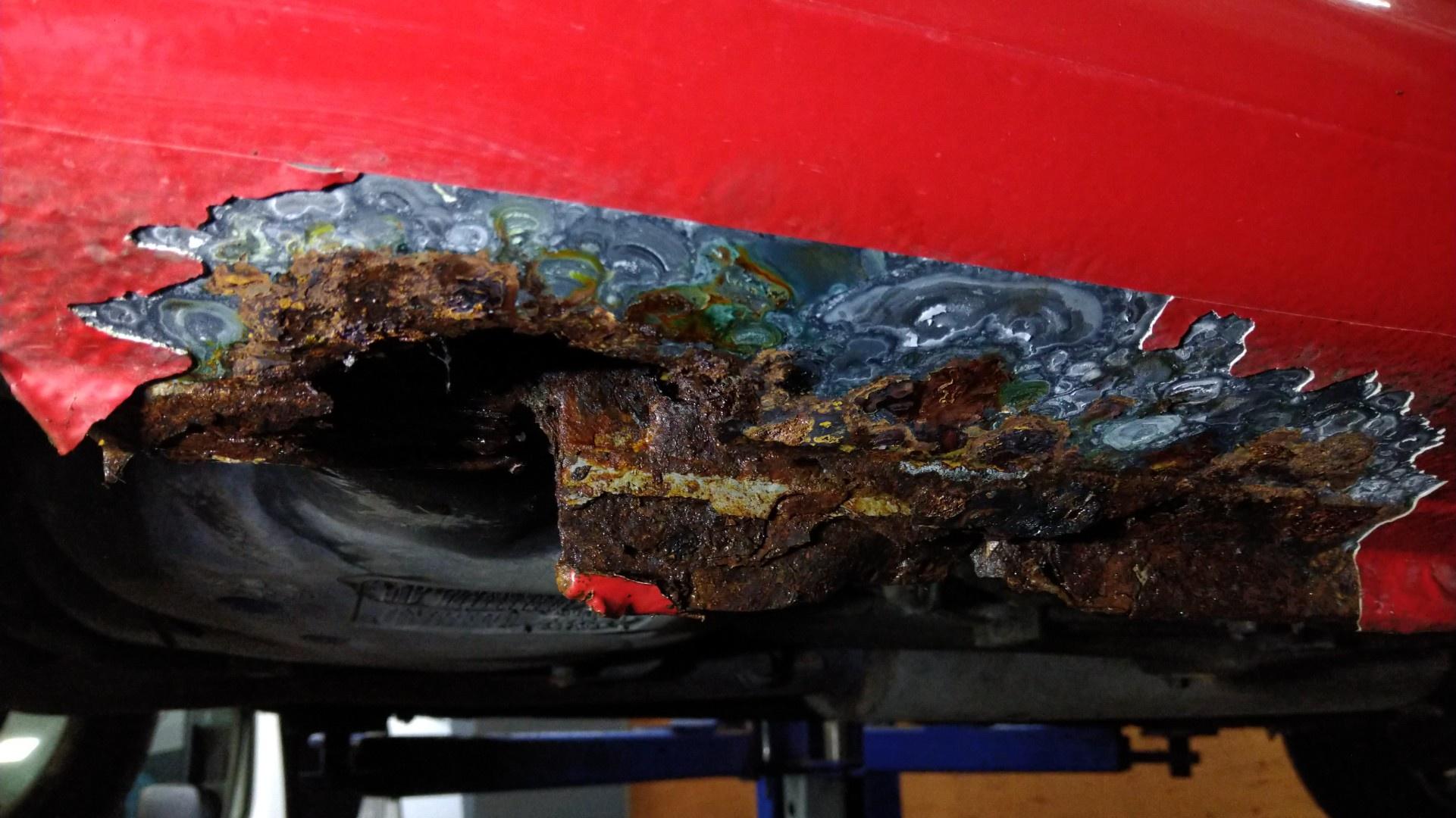

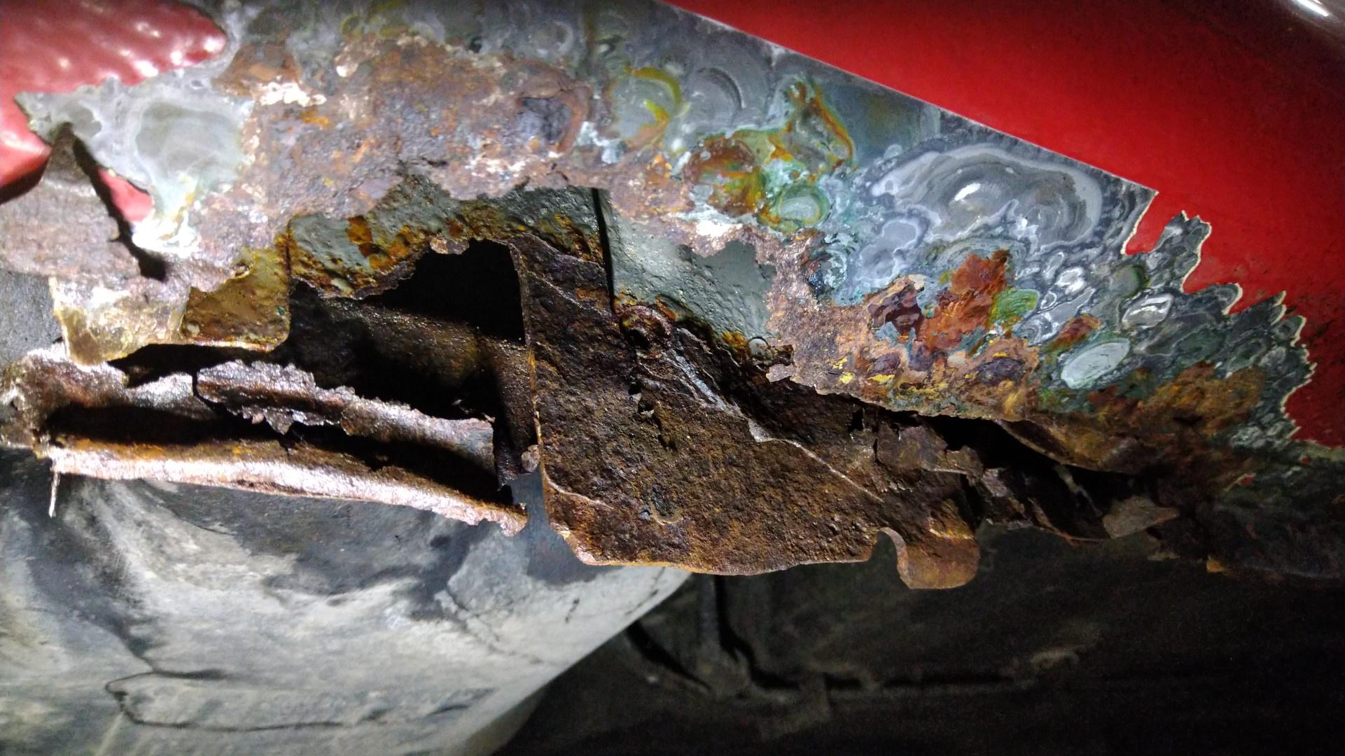

What's been hiding under the paint (or rather what was not there anymore:)

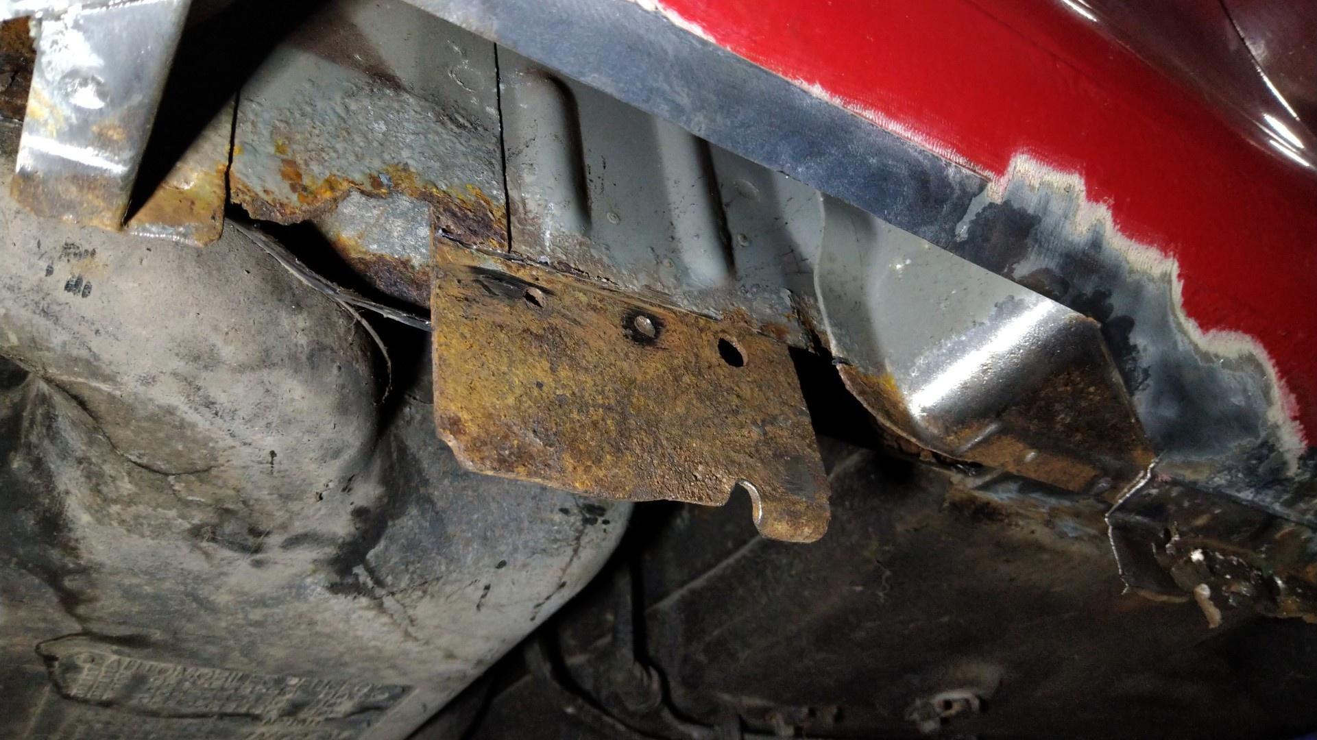

The thickest support only had surface rust, thus gotten straightened back
All waffle-y crusty bits were chopped off around the area

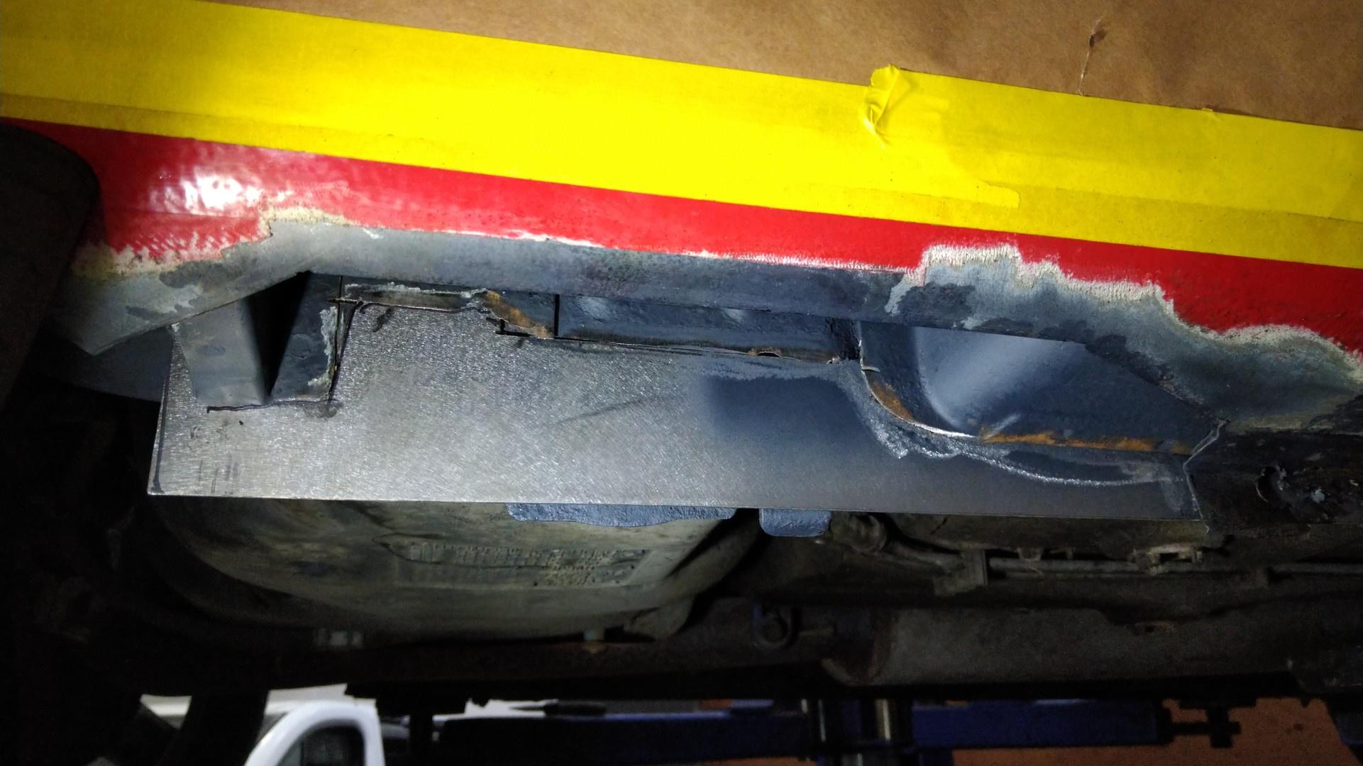

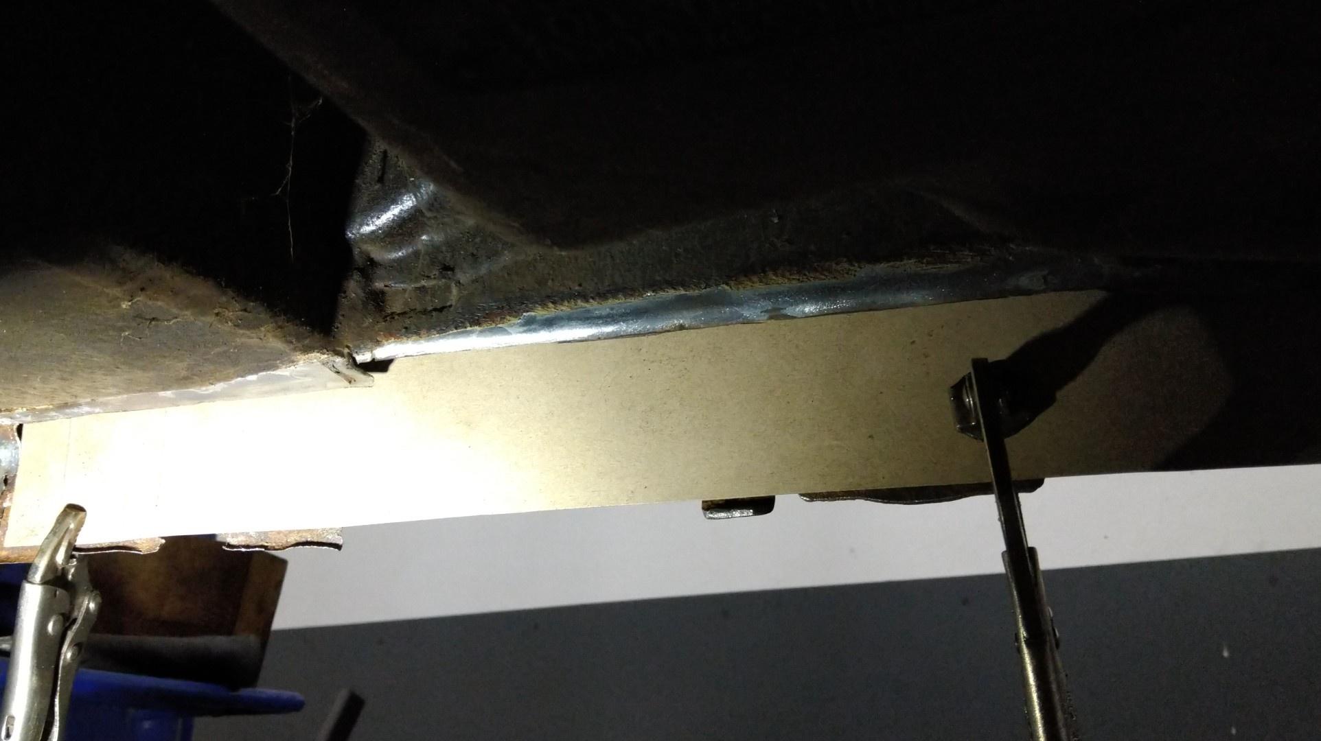

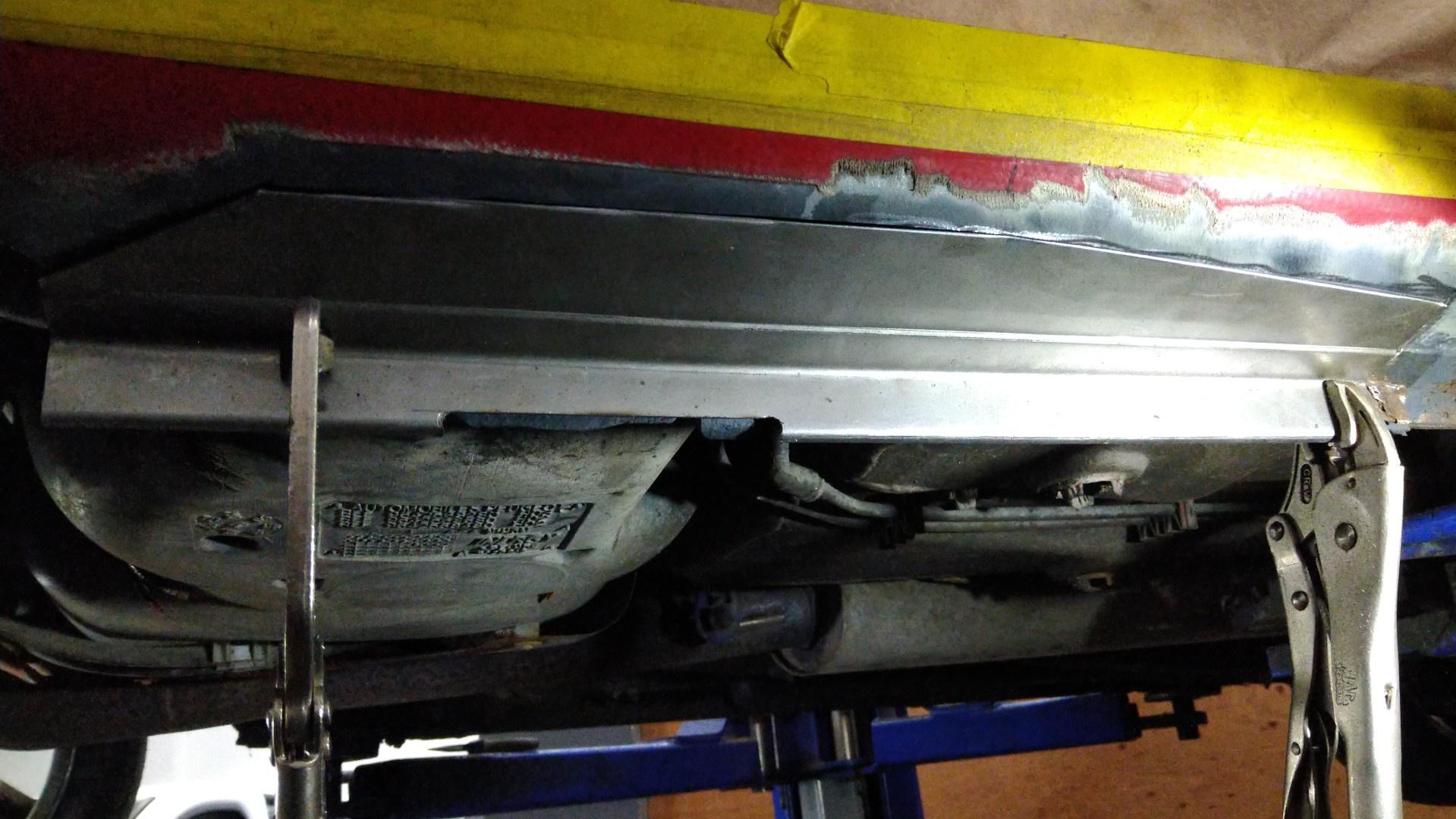

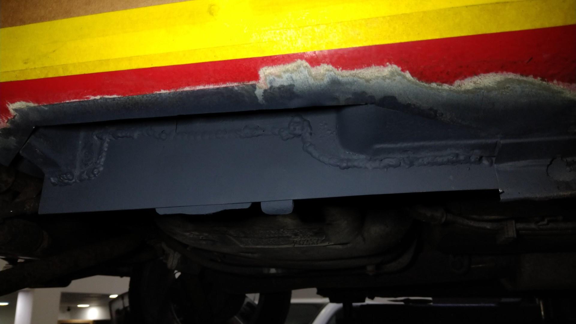

Fabricating the outer body panel part of the sill (he's trying to get by without the sheet folding machine!)
Primed for its time
Mipa Light Grey Stone Chip 1l Under Body Protection and Sound Deadening sold by Soll Automotive Paints Ltd for £9.62/bottle

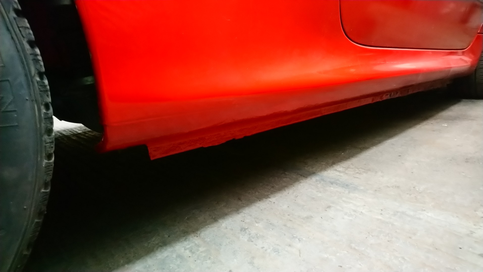

Next steps for the outside will be to obtain a new nylon clip (7136 A5) for pennies from the dealer (original got butchered by Mr Jim during an intrusive cleanup:), then primer, base coat, and clear lacquer.
And yes, it's always good to know both sides of the story:
And of course, all restorers use AutoCAD (Automotive Cardboard Aided Design)
Kurust ahoy
Standing on her own 4 feet again
HB Body Pro Auto Seal Brushable Seamsealer, applied generously with the brush around all the welds.

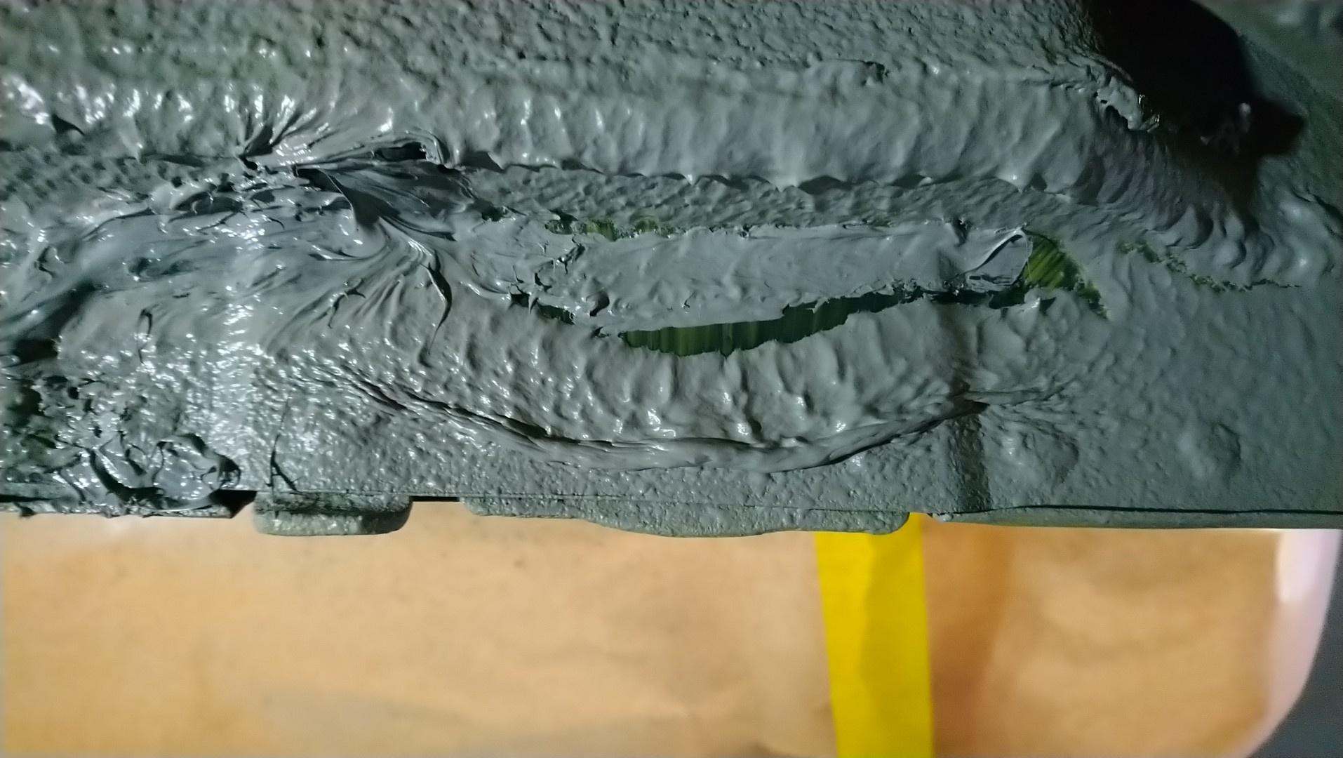

Then I got advised that the factory-look underseal finish can be achieved by mixing paste-like seamsealer with thinner, until it can be sprayed out of the 5mm airgun. He did it to his classic Merc, and it looked the part.
It looked great ... for the first few minutes. What we didn't realise is that the primer underneath will react with the thinner, and the sealer just sagged Laughing
I did my best to repair with the brush, and it cured to something that's certainly not a factory look:D It didn't happen to his Merc, because he used a 2K primer... Well thanks for saying that now:D

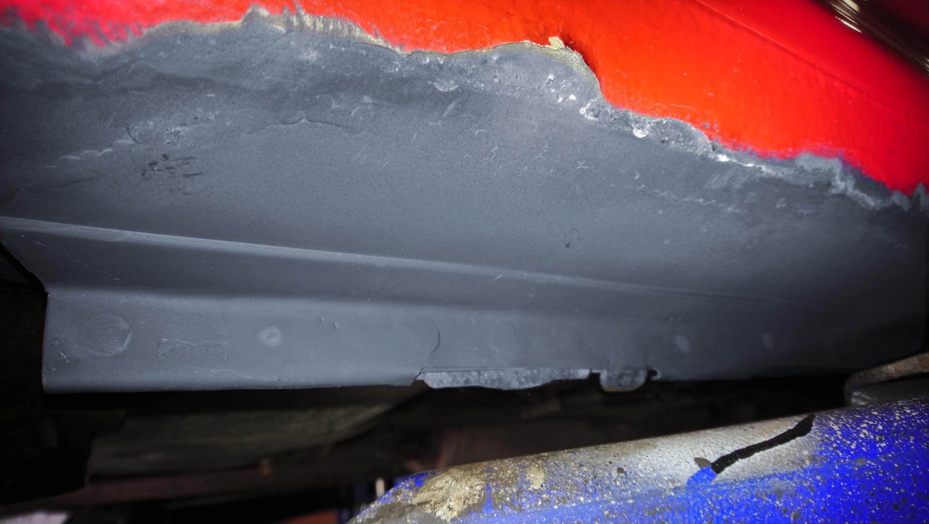

Notice how there is an intended gap between the metal skins for the drainage (left of the photo). Well whoever sold this car to VorTechS praised the "FULLY WAXOILED UNDERSIDE", where in fact it was the black underseal generously applied into all of the drain holes, so sills were probably full of water most of the time... Heard horror stories of water sloshing when car brakes, and water trickling down for hours after drilling a hole in a sill.
Final touches were done with Granville Underbody Seal Schutz Rust Protection Underguard Underseal 1 Litre sold by Independent Car Components for £9.97/bottle
Getting there, closer to the final painting weekend:)

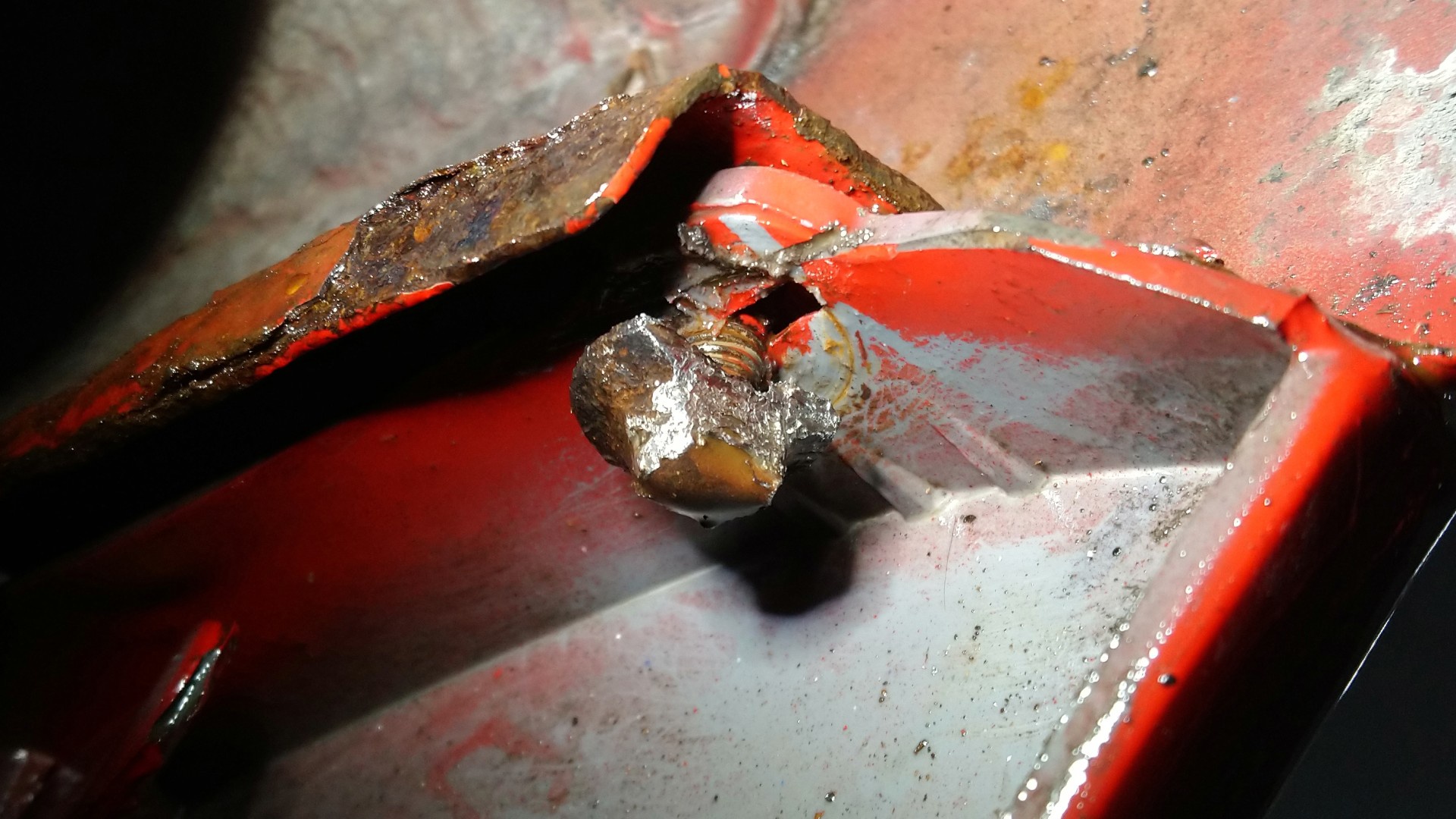

I decided to spray the rear bumper in situ, because taking it off may lead to snapped bolts under the arches
Scratch that and just cut through the seizure, then mole grips to off 'em:
Yep, I did go a bit too far with the cutting disk:) in my defence -- very tight space

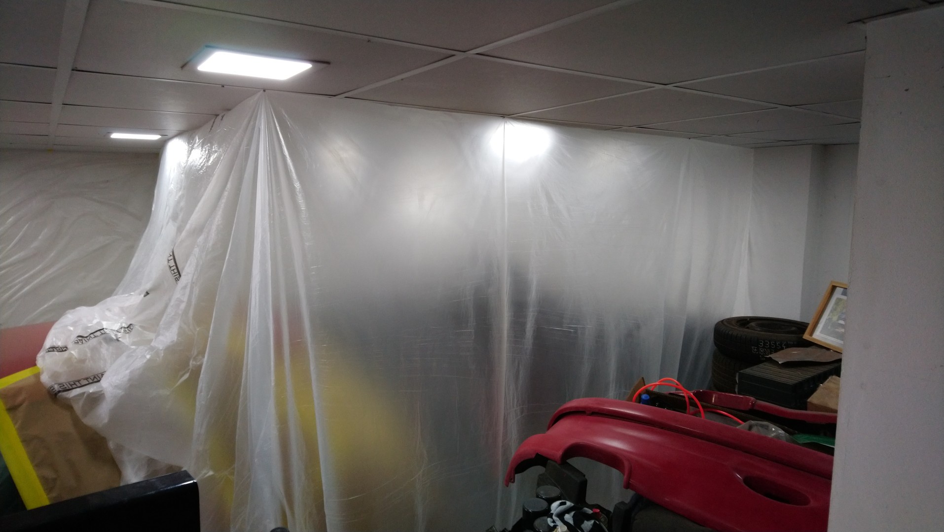

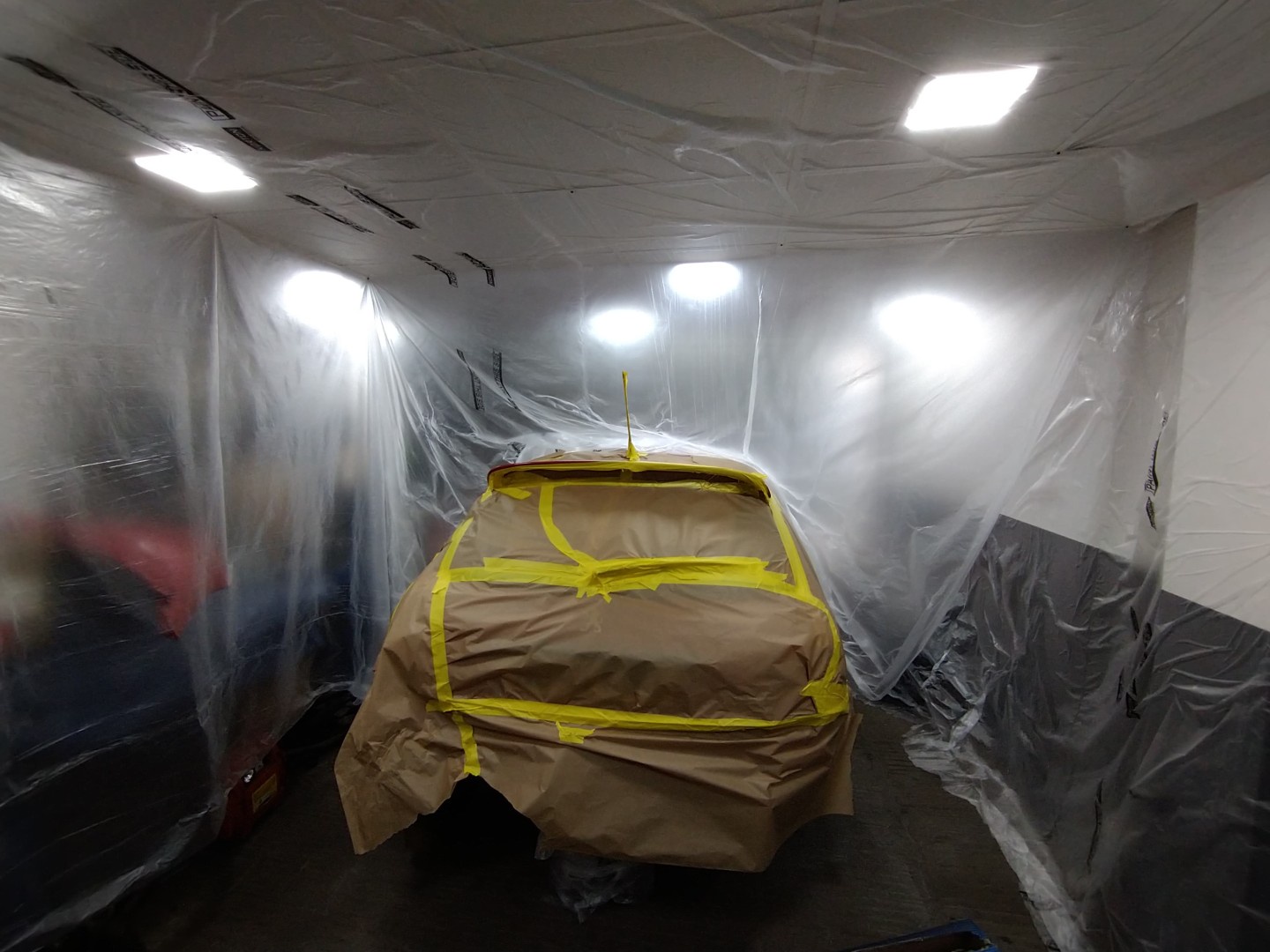

Spray tent
Masked ball

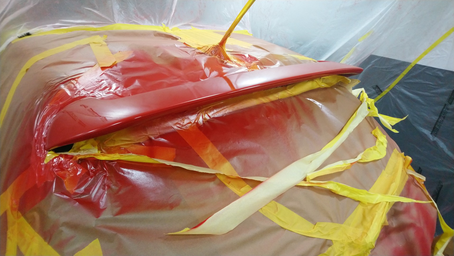

Sanded off mainly the clear coat, risking new paint reaction (bubbling up), but that didn't happen, winning
Rouge Aden KKN redy to go
After two coats of base (from paints4u.com) and 2.5 coats of 2K clear (Lechler)
Spoiler alert, before, during, and after (nearside probably had a quick job from a rattle can previously)
