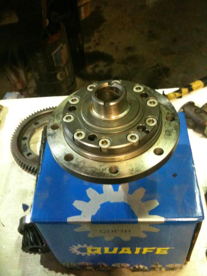

Another little update i have finished my gearbox build which i fitted the ratios from a 180 gearbox with low 1st gear to my 137 rod change box also fitting 4.5 CWP and a Quaife ATB diff
Apoligies for poor pic quality as i only had my phone with me
4.5 CWP
Quaife ATB
I would ideally like a close ratio gear kit but the lower 1st & 4.5CWP will suffice for the moment

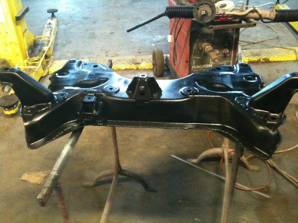

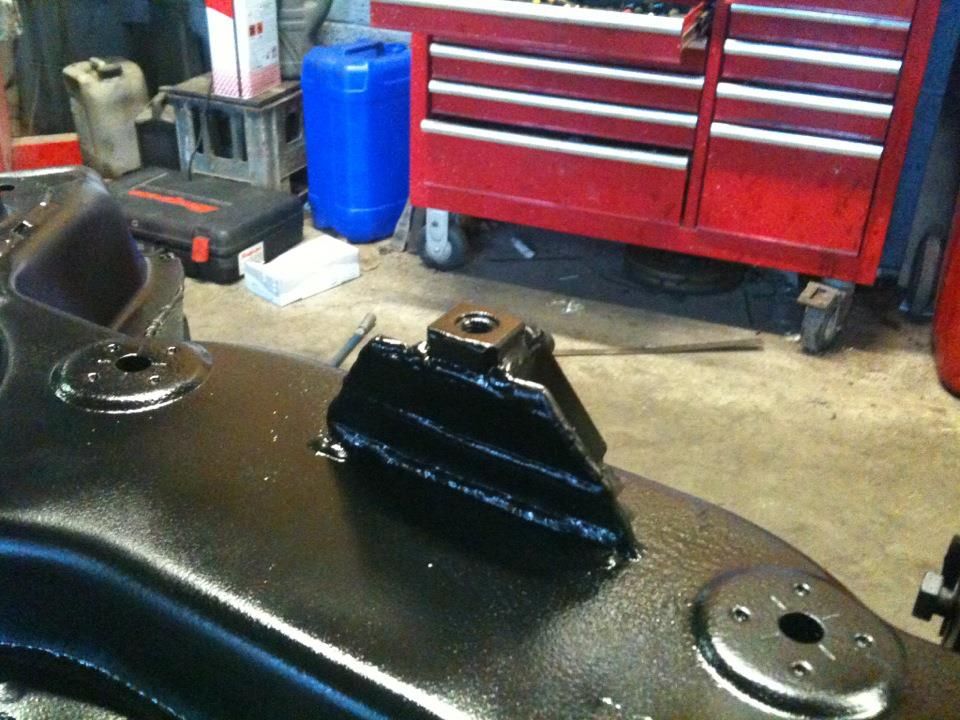

I also finished seam welding my subframe and strengthened the gearlever mount & painted it up

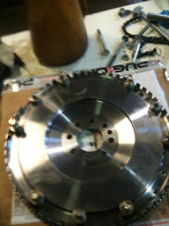

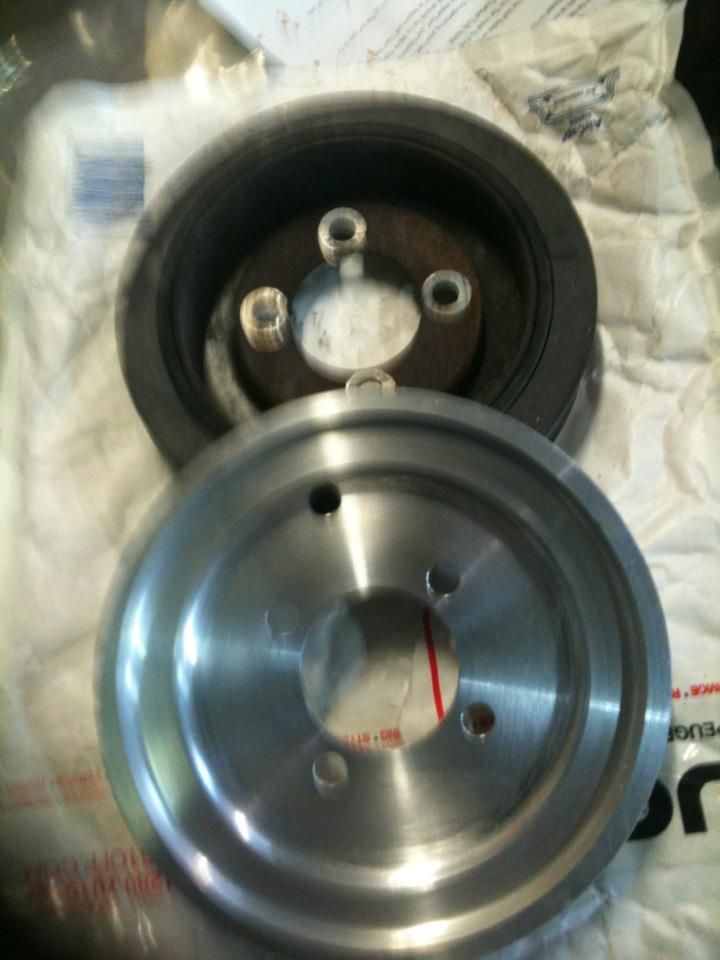

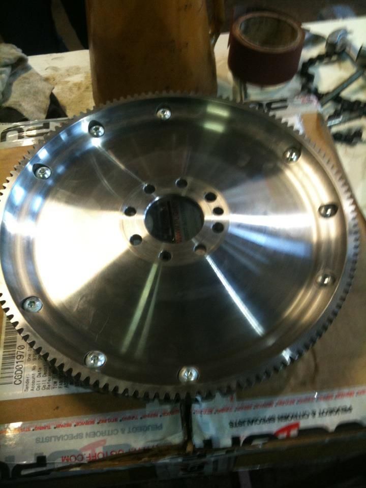

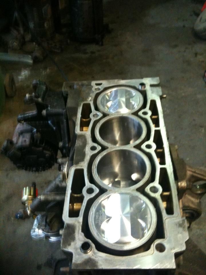

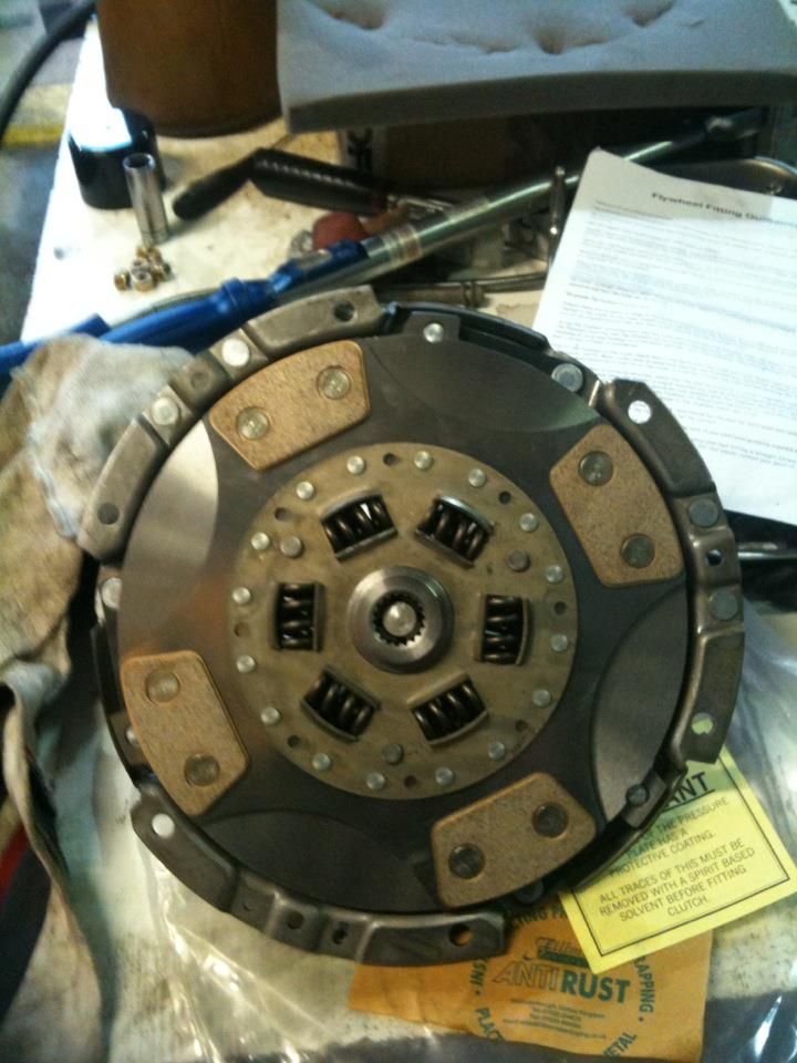

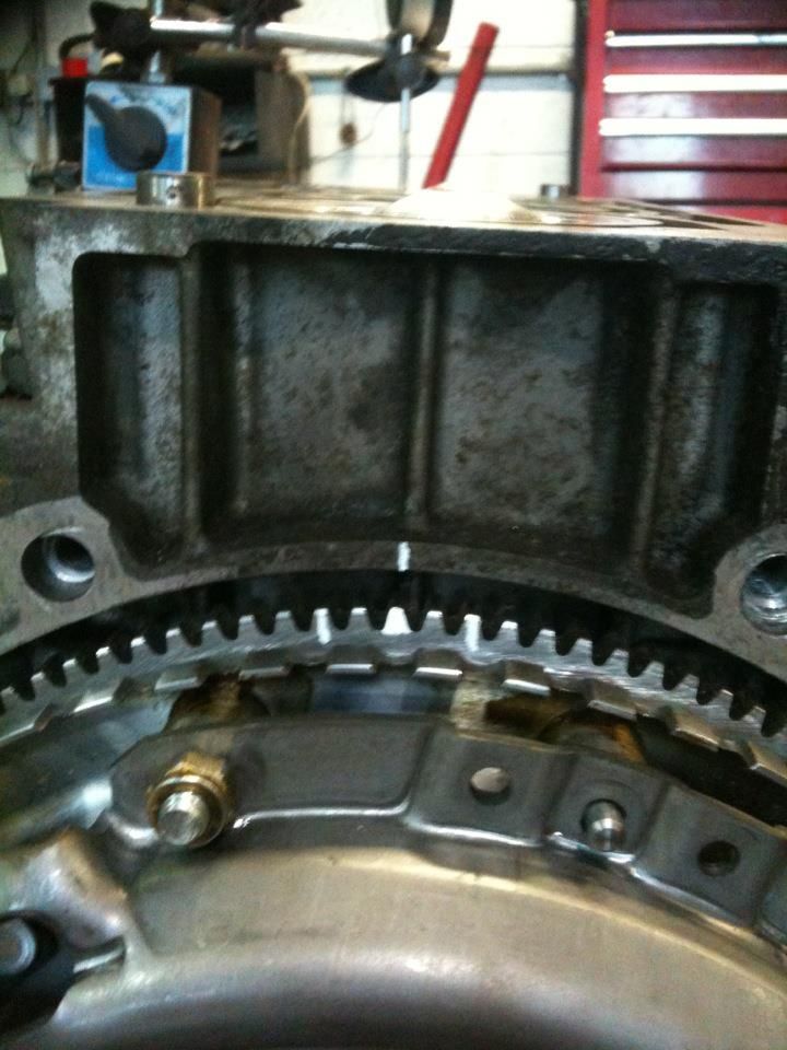

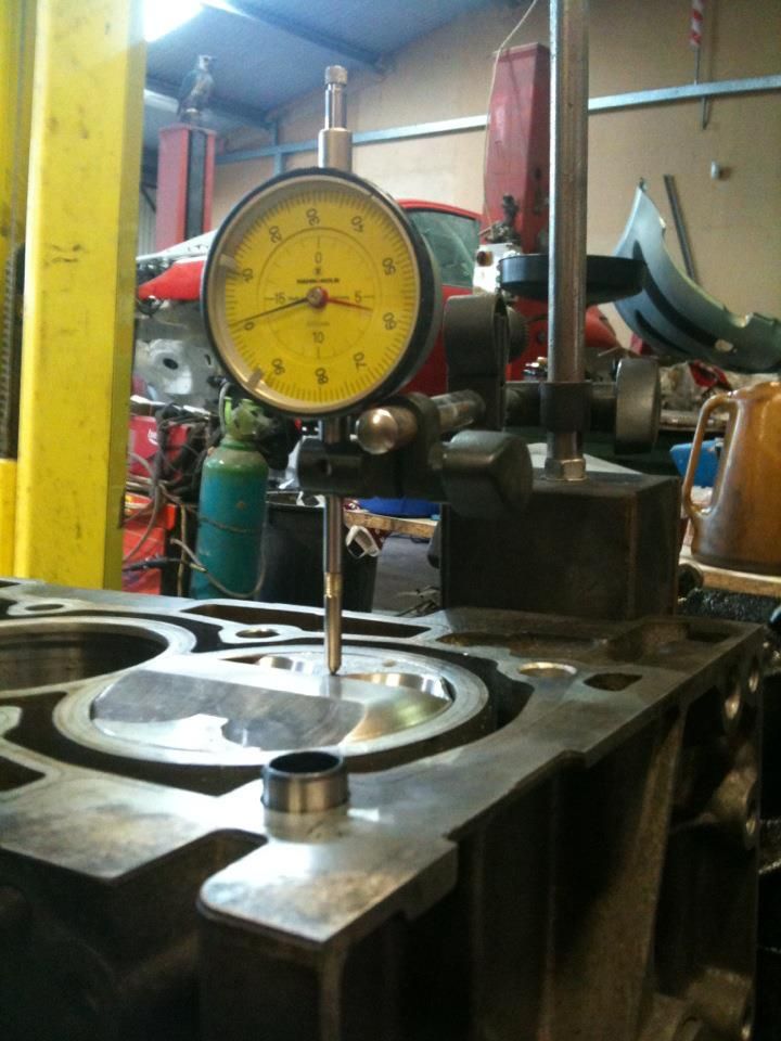

I fitted my PEC Steel Rods,Wossner pistons,Billett Flywheel,Helix Paddle clutch & Alloy Crank Pulley, New main & big end bearings

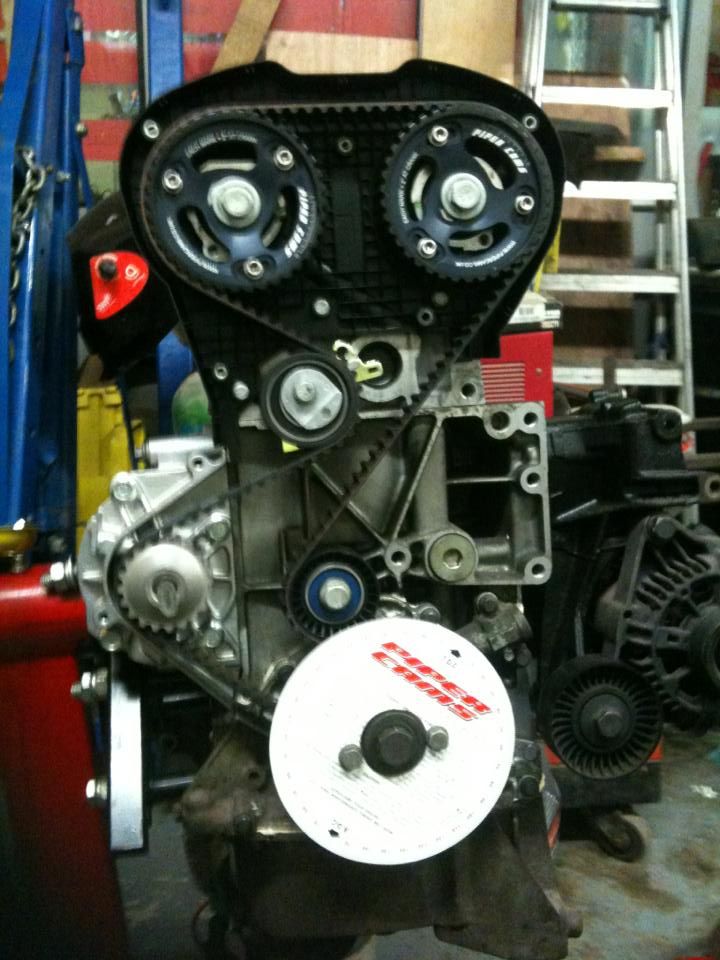

Dial Guage to locate Actual TDC for dialing in Cams later
Actual TDC

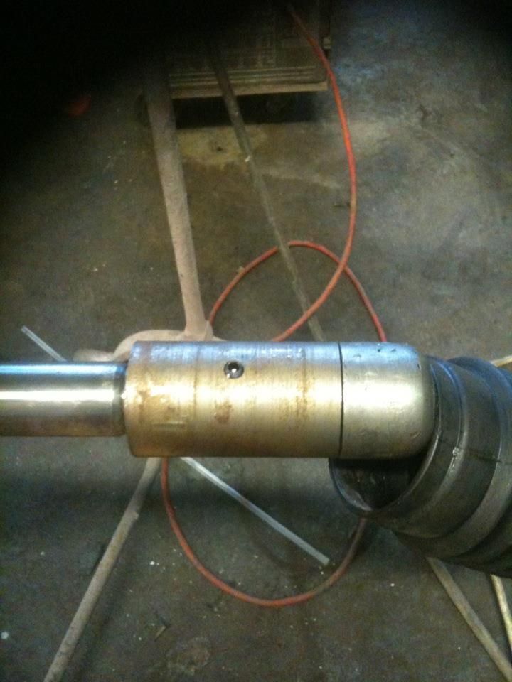

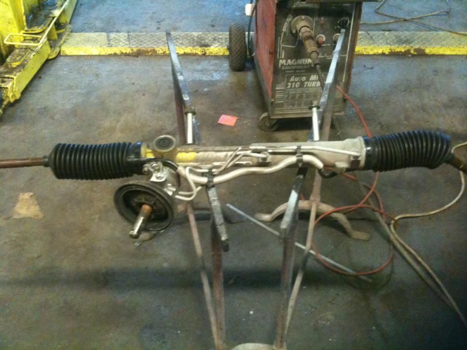

Lastly for now a pic of the spacer unit yo extend Steering rack/track rod arm
Steering rack with extended rack adapters & longer boots fitted ready to refit to subframe

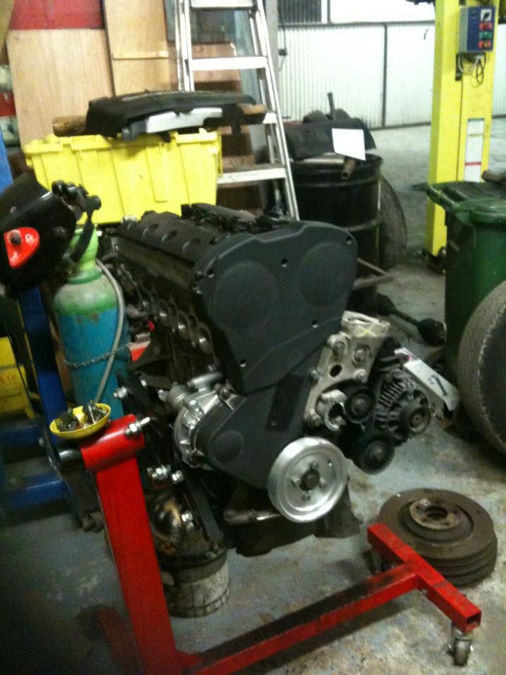

I Eventually have my engine rebuilt with
PEC Steel Con Rods
Wossner High Compression Pistons
2mm Oversize Inlet & Exhaust Valves
Piper Cams
Piper Uprated Valve Springs
Piper Hydraulic Followers
Piper Vernier Pulleys
Billet Flywheel
Complete Balanced bottom End
New Main & Big End Bearings
New Timing Belt kit & Water Pump
Helix Paddle Clutch Kit
so its ready to bolt up to gearbox & refit all going to plan it will be back in at weekend Very Happy

Good idea on strengthening gear linkage pivot as that's what I had to have done 'after' I snapped mine. Good choice on the fly wheel also I couldn't be leave the difference between the weights.

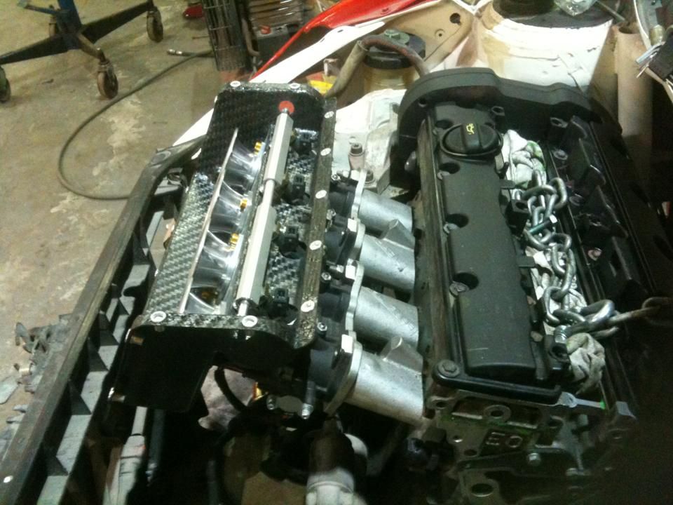

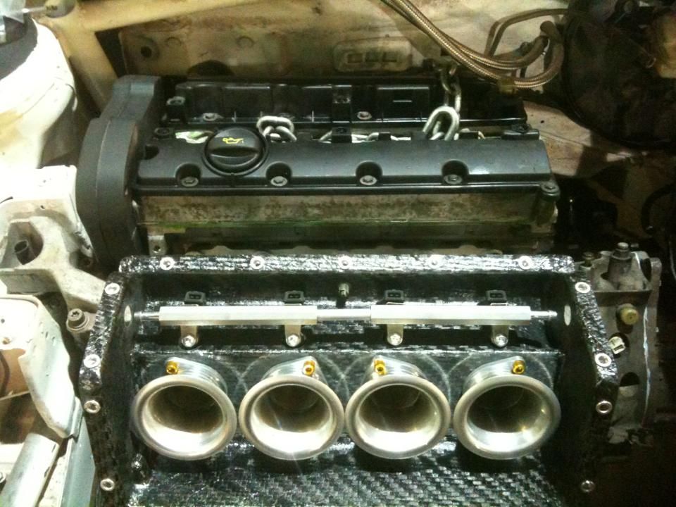

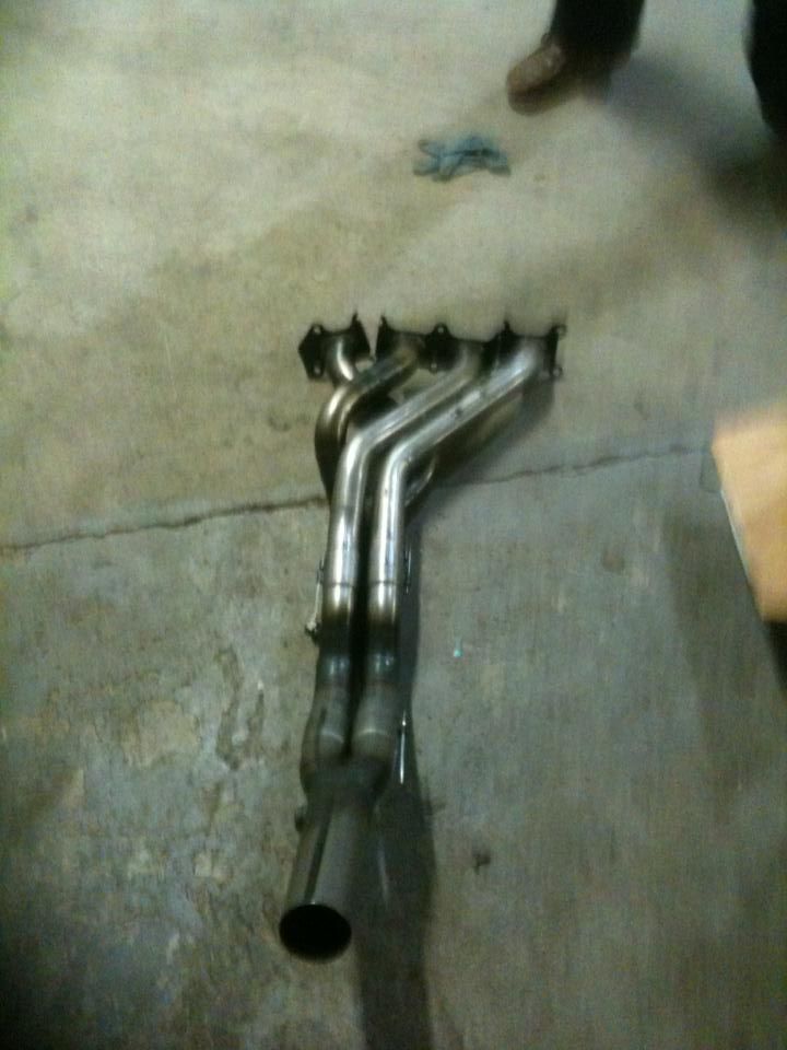

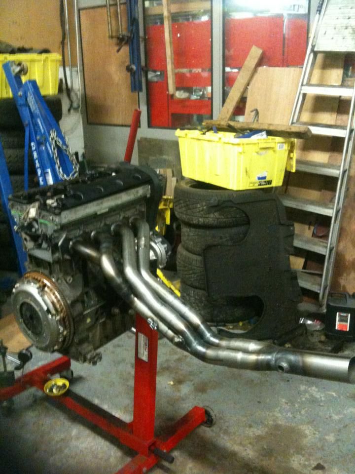

Maniflow Manifold arrived today
Fitted to engine
206 Rallycar

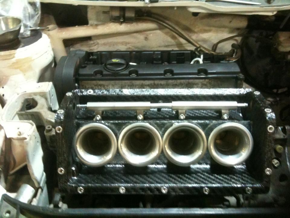

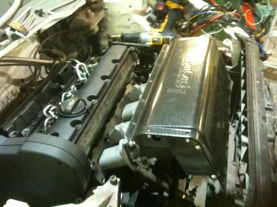

Got the engine back in & modified the airbox to suit throttle bodies,
need to sort out cold air feed to the airbox then its all ready for final fit
Here is a few pics of progress

How bonnet will close with that Airbox. Your inlet manifold simply straight. Not curved like Jenvey one. Good luck with your bonnet clearance.
