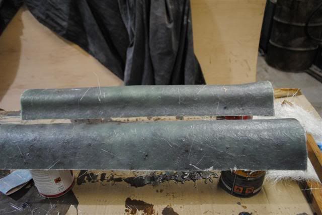

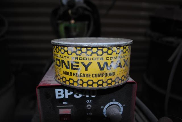

Its not really much to see but after a lot of cutting reshaping & sanding i eventually got wings & side skirts fitting the way i wanted
i started making fiberglass moulds so here are a few pics
After several coats of this so mould dosent stick to the parts Shocked
[img]
[/img]
2 coats of gelcoat on all panels
[img]
[/img]
then 3 layers of matt & resin
wing with 1 coat
[img]
[/img]
bumper and skirts with 3 layers ready to pull moulds (provided the wax worked Laughing )
should have wings finished monday night then pull moulds
& make new wings & skirts i am using the bumper supplied but not wings as there is too much bodyfiller & fiberglass in the modded wings

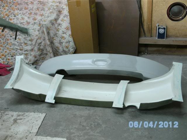

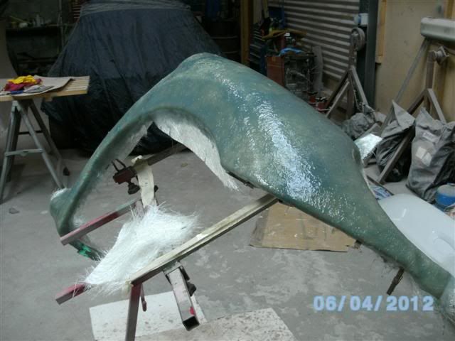

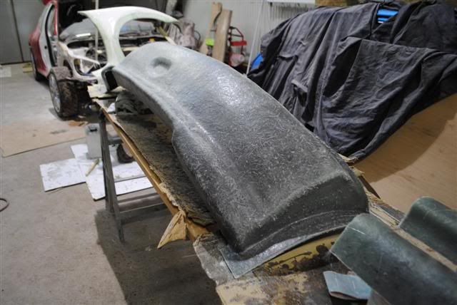

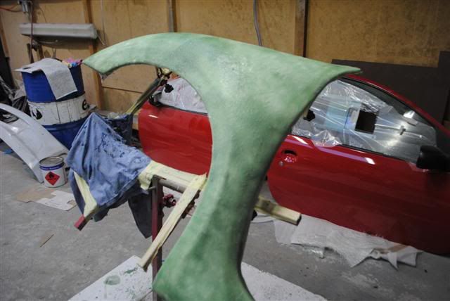

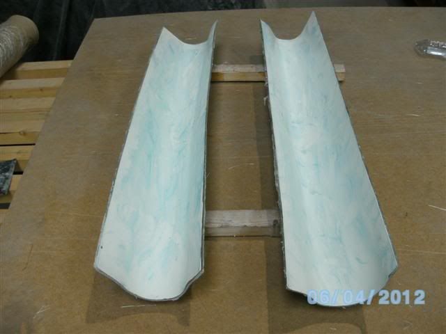

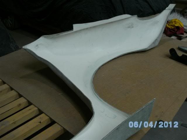

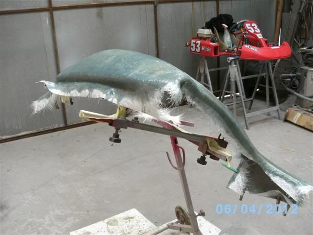

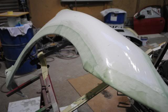

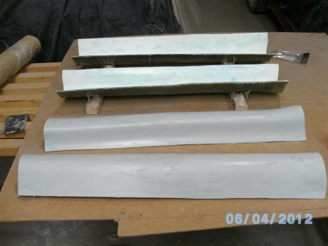

Few more pics of fiberglassing as usual im not getting it done as quick as i planned been busy with work but now have side skirts & both wings made just the mould for front bumper left to make
Final layer on mould for r/h wing
Mould for l/h wing ready to fill
Rear bumper & mould you can see where i modified bumper as it was 2inches too wide & looked bit silly
Side skirts mould ready to fill
set of side skirts made Very Happy
Will post pics of wings when they come out of mould monday

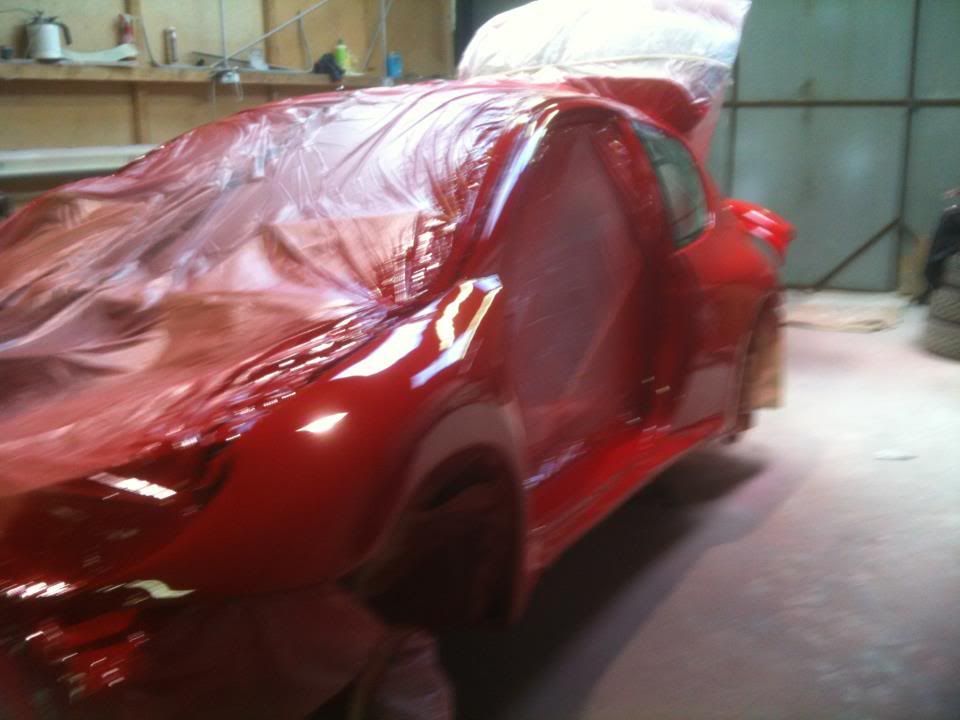

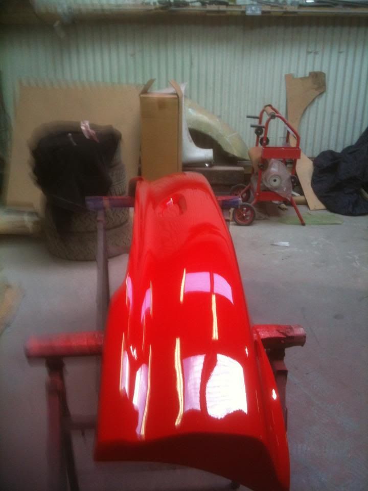

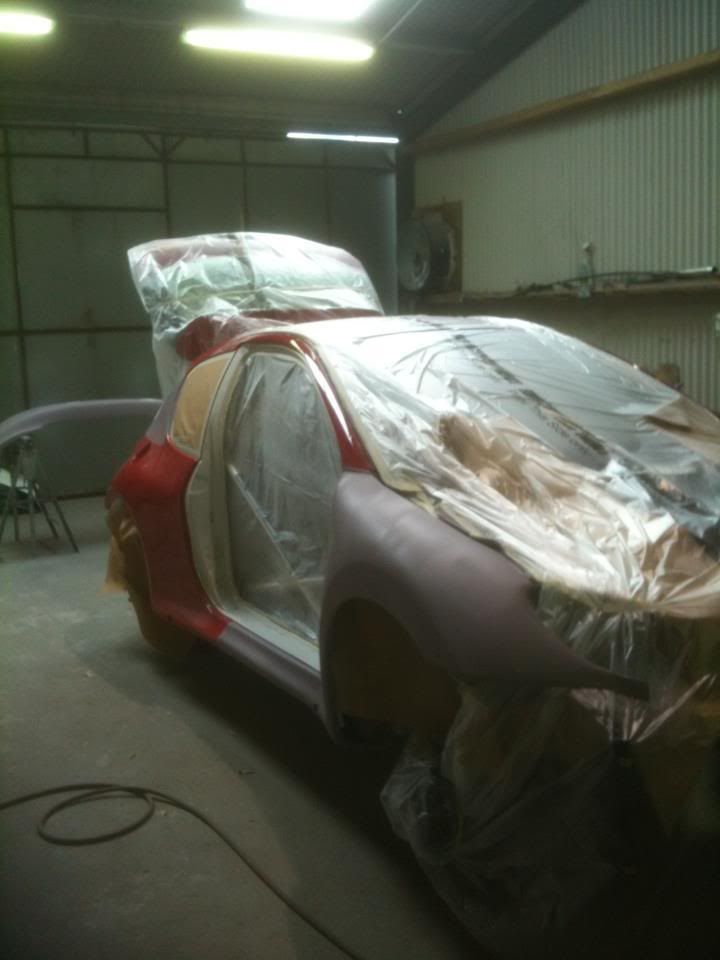

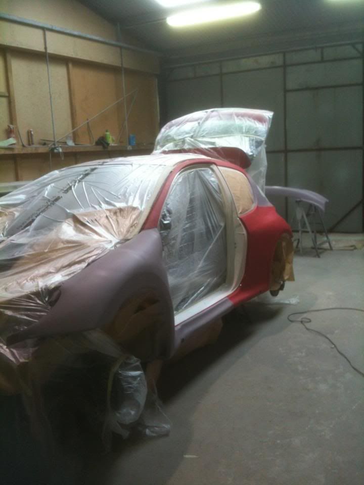

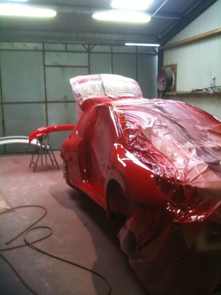

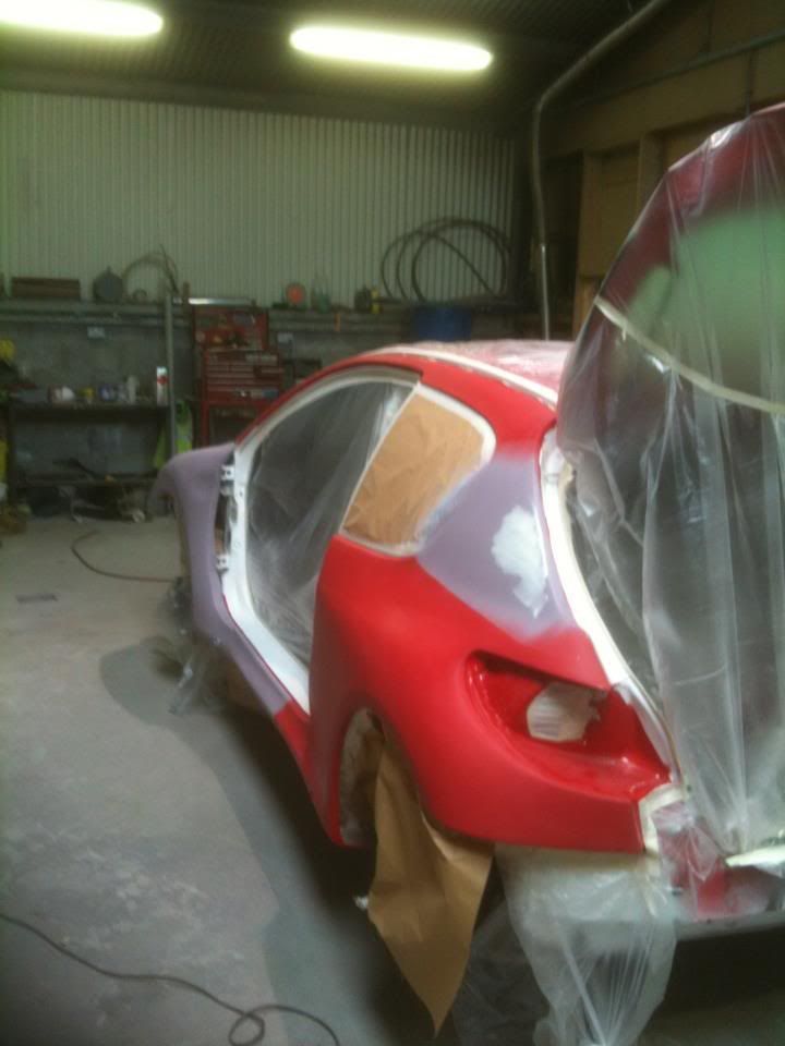

Few pics of progress slow as usual been very busy at work so rallycar only getting few hours a week finally have wings,skirts fitted & painted also got rear bumper painted
Wasnt 100% happy with join on rear 1/4 panels & door opening was wrong colour so repaired 1/4's and painted both sides of car.
