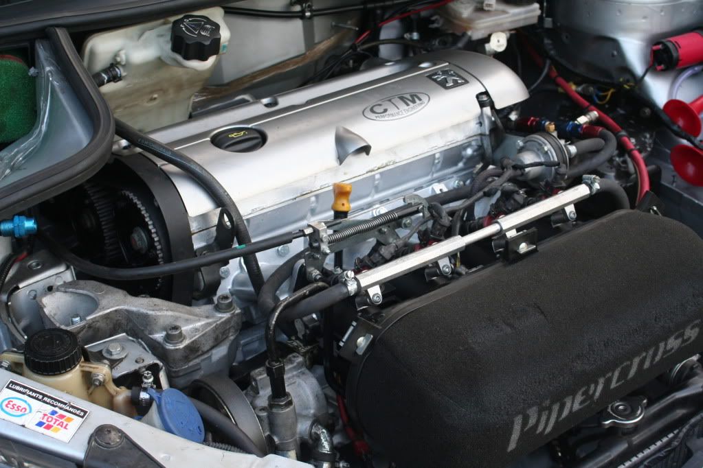

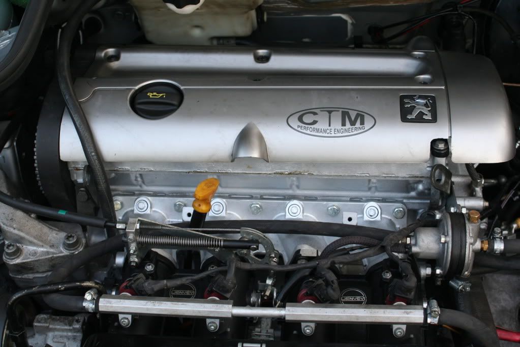

Has the block been painted? I always wonder if shot blasting an engine prior to strip down would finish it off like new.
Even the bottom pulley looks nice. Bolts look new too. I want a new pulley as there is a bit of corrosion on mine. £55 for a new one...
Is your rear rocker cover breather connected to anything? I see the later EW engines with the tall rocker covers have a breather on the inlet cam cover too. Any rally or touring car EW engine seem to have a breather on the front cover. Do you think having one would be an advantage?
Yes.... the block got painted. I have to say the whole thing impresses me. Charlie has a good engine builder. He has replace everything that needed doing. In the bag of bits that came back with the engine are some nice surprises.
A huge quantity of bolts
The old tappet buckets
The old springs
The old bottom end shells
The old pistons and rods
Old gaskets
I am not listing everything but suffice to say there is a lot of stuff.
The breather is to be connected to a catch tank. Small piece of tubing and a filter on the tank. I have had the end of the original breather tube covered to see what comes out and I have to say the old engine was not a big breather. The new one will need to breath me thinks.

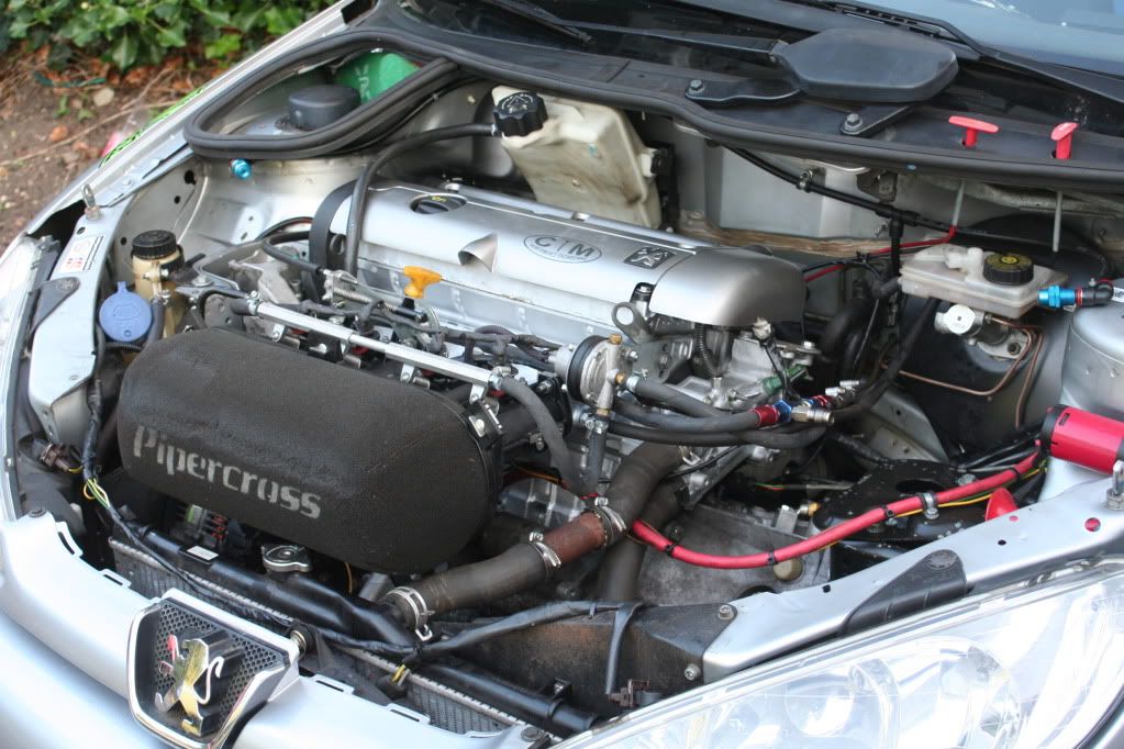

OK.... new engine is fitted and running nicely
I ran it in on the ramp for 2 hours using an SAE30 mineral oil then dumped it hot and changed the filter. It is now running on Millers CFS 5W/40 fully synthetic race oil. It is very noticeable that the engine is a lot smoother after the balance. On the road the slightest throttle brings on the predictable "pinking" due to the increased CR but that will map out on the rollers. The temperature is nice and stable with the fan dealing with the extra heat.
Bring on the rollers Thumbs Up
