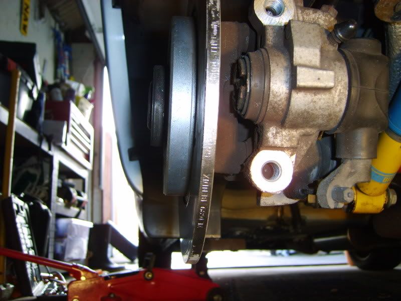

Right im trying to remove my rear brake callipers as hey are geting painted tomorow. The only problem is we cant get the handbrake calliper disconected. Does anyone know a good way to remove it cheers

Don't remove the whole caliper. Just undo the 2x 17/19?mm bolts and pull the big C shaped bit off and get it painted.
howcome. The only probably with that is im taking thm sumwhere to get painted :s
TEAM - I HATE FACEBOOK Smile
Steve206
PostPosted: Fri Nov 12, 2010 4:50 pm Reply with quote Up
Posts: 2724
Thats the only part that is really visable, otherwise you'll have to take the whole caliper off and bleed the brakes, Take a look at edwards Garage.

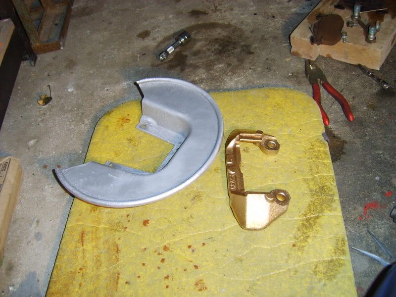

PostPosted: Sat Nov 13, 2010 3:35 pm Reply with quote Up
Because it's in 2 parts. There's a alloy block part with the piston and handbrake mechanism. This part doesn't need painting. There's also the C shaped section that's made from steel. That's the only bit that needs painting.
The gold part is the only bit that needs painting...
The rest of the caliper is alloy and doesn't need painting.

PostPosted: Sun Nov 14, 2010 4:35 am Reply with quote Up
It doesn't matter if it gets painted but simply polishing it with autosol would have looked much better.
That also means you wouldn't have had the hassle of removing the brake pipe (and bleeding them afterwards) and handbrake cable!
