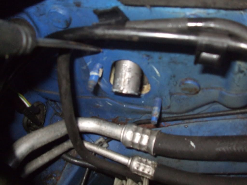

if your fitting a gti gearbox you need the whole pedal box from a gti as it has a hole that matches the bulkhead where the slave cylinder goes through to the pedal.
1.4 pedal box has a bit of metal at an angle going through the bulk head for the clutch cable so you cant attatch the slave cylinder.

This is the engine bay where the slave cylinder attatches to and as you can see the 1.4 manual pedal box has this in the way.
Old info post count 1500

im not actually fitting a gti box im fitting a manual 8valve tu box to my 1.4 engine and binning the auto box as its gone bang Smile
just im going to get some bits of a gti tommorow and if the pedals were the same id buy them too while i was there Smile
