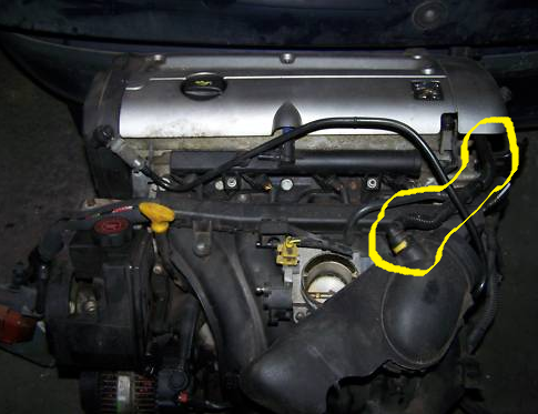

One of the pipes on my engine is perished, and is not looking so good.
What is the pipe called so I can get it replaced, and what does it do?
Have circled it in yellow. Thanks.

I think thats the oil breather hose

cam flow pipe i call it, as above i'm sure its a oil breather pipe from the rocker cover to the air inlet

Could swop it for a length of silicon hosing from Ebay...I think you'll need a little T piece in it though. I bet it's not cheap from the dealer. You can cut the pipe up to re-use the end connectors.
Mine just needed a straight run but I reckon you could use the existing angled T piece.
