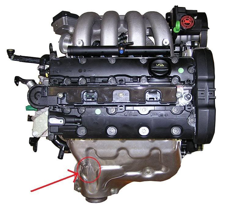

It's not vvt sensor that's near the coil pack.
kieron
PostPosted: Fri Dec 31, 2010 9:51 am Up
Joined: Apr 16, 2010
Posts: 1152
Location: in the house
it is the only sensor near the coil pack

is that not the lamdba sensor

its not the arrow pointed its at the end of the coil pack
thats a pic i borrowed of another post

ar right sorry...........

The thing next to the coil pack is the VVT solenoid. That controls the oil pressure to the inlet cam pulley.

Didn't say it's near the coilpack I said it's near the tb. And you can see it threw the inlet manifold near the throttle body it's black with a connector going to it and held in by a 9mm bolt I think. I did say it's not the vvti sensor because that's near the coil pack.
