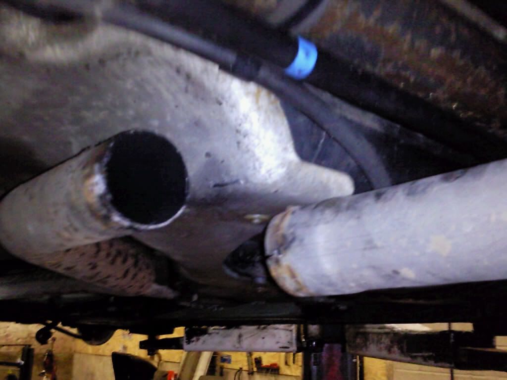

Put it up on the two post lift and straight away we could see that there was an arm missing, then we saw this hole in the exhaust:
So then we looked at where the back box was joined to the exhaust system and this is what we saw:
They have cut the exhaust pipe to fit the back box on! They havent even made a good job as the edges are far from being flush! I was disgusted when I was they had done this.

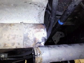

So we made a new arm to weld onto the exhaust to hold it as a temporary measure (and you can see the hole much more clearly now)
Then welded a small piece of metal over the hole:

mmmm..what a bad work they did there,it sure not a pro work,there should be a joint to attach each side of the pipes together,so you should do what you said you gonna do,and make them fix this shi**y work.

Crikeys!! Yeah defo got onto complaining about that! Shoddy job!
Your fix is great though, you can now tick it off your checklist!!

Well considering it has only been on the car 2 years I am not happy with it. The fix is just temporary but should hold up for now Smile

Looks like they let the apprentice have a go at making / fitting that one Laughing
