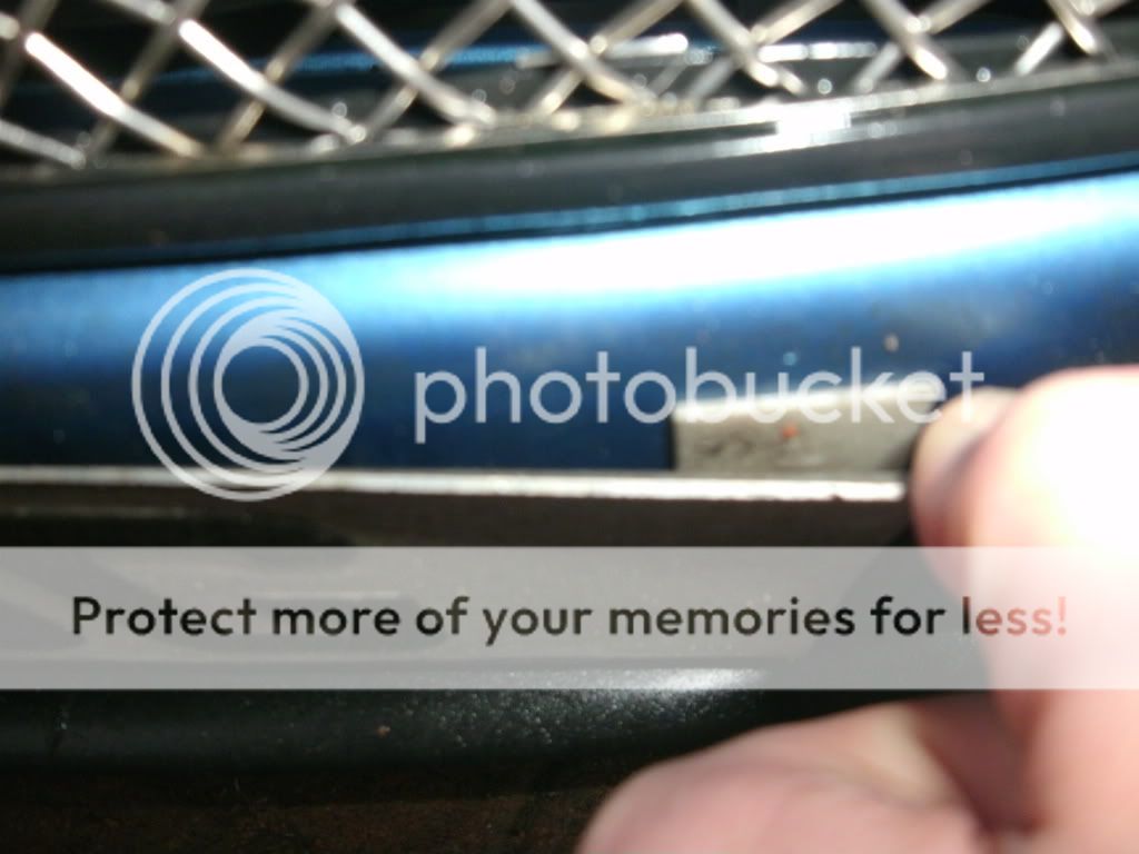

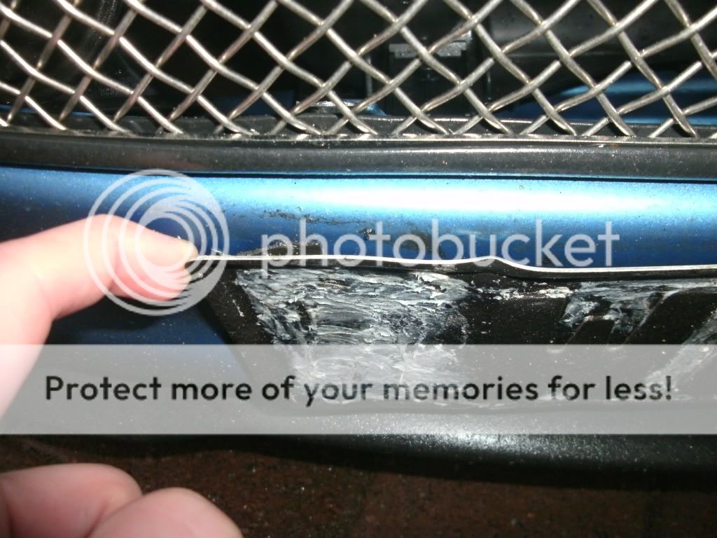

After my bump it has ripped the white stencil off the black back, so its hanging off just now. Getting a new one tomorow but I don't know how to remove it.
Its stuck on with the sticky pads that it comes with.
Here are the pics;
They just wont budge at all.
Thanks
Jordan

Get something in between to help prise it off. Use steady pressure, it will come off.
Uz
PostPosted: Wed Feb 02, 2011 6:22 am Up
Posts: 4117
Location: No Man's Land
Take a really sharp knife and a heat gun and they should just come straight off.

Heat gun will sort that
PostPosted: Wed Feb 02, 2011 6:28 am Up
So will some muscle, lol.

Use fishing line etc to cut through the pads. Then use heat gun to get what's left on the bumper off.

unless you heat it stupidly the paint will not peel. think of all those summers days when the paint gets too hot to touch. doesn't come off then
