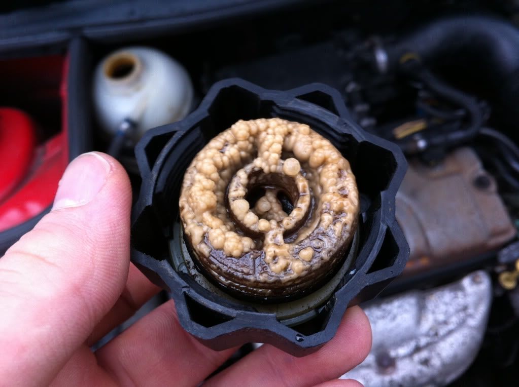

Hi guys, just had a look at the inside of my coolant cap and noticed this
Just wondered if this was normal or not, 1999 1.4 petrol. Joni
PostPosted: Fri Mar 11, 2011 11:27 am Up
Check under the oil filler cap too.
Possible head gasket failure.

Mayo = Sign of headgasket failing
But some cars just get it from condensation, so it here nor there
Is there any inside the engine?

the oil filler cap has no sign of any 'mayo' like substances...lol just this awful smelling stuff on coolant cap!! Joni

Sorry mate but I would say your head gasket is shot.

Flush the cooling system through & refill with fresh coolant / water in a 50 / 50 mix.

that mean you have oil mixed in your coolant,I think that your headgasket is gone bye bye :(,does the car overheat quickly??

The car doesnt overheat at all, always runs at good temps. Is oil not heavier in a particle sort of way? meaning it would sink to bottom of coolant tank as oppose to floating at the top causing this stuff? Not loosing water either, the levels fine. There IS a slight oil leak somewhere leaving the odd drips on the pavement overnight though!

Oil floats on water

:whathesaid:,Oil always floats on the surface of water,but since your car does not overheat,check the car oil,is't the same color as the build up you got on your coolant cap or not??
