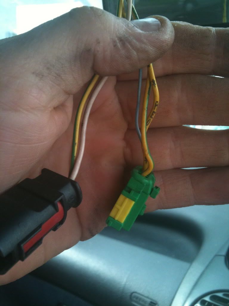

ive found 2 plugs that are not connected up to any thing.
this one is behind the interior light.
the green one is for the light, but whats other for?

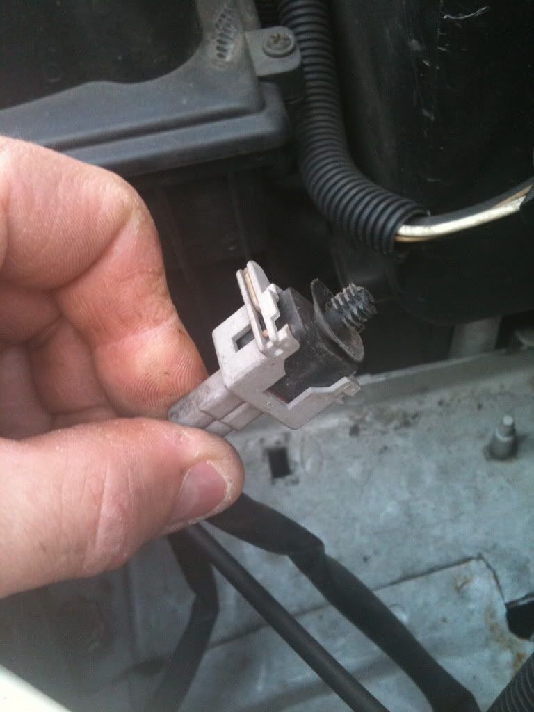

this one is in engine bay, behind the headlight, im thinking its for the fog light?

i think the top ones are for auto lights and wipers and the bottem one was i think for the bonnet sensor for alarm or something

sunroof? Smile

thats a point i didnt think of a sun roof lol

plug looks like a light plug, but its only a short wire so cant see it reaching the fogs. BUT i could be wrong

Grey 2 pin plug will be front fog light.
Grey 3 pin plug will be crystal twin H7 headlight.
Count the wires to the plug Wink
The big black plug is for the electric sunroof, the size of the wires gives that one away Laughing

cool, im fitting fogs soon, so that plug will help loads lol
least i now know what the big black plug is for now!
