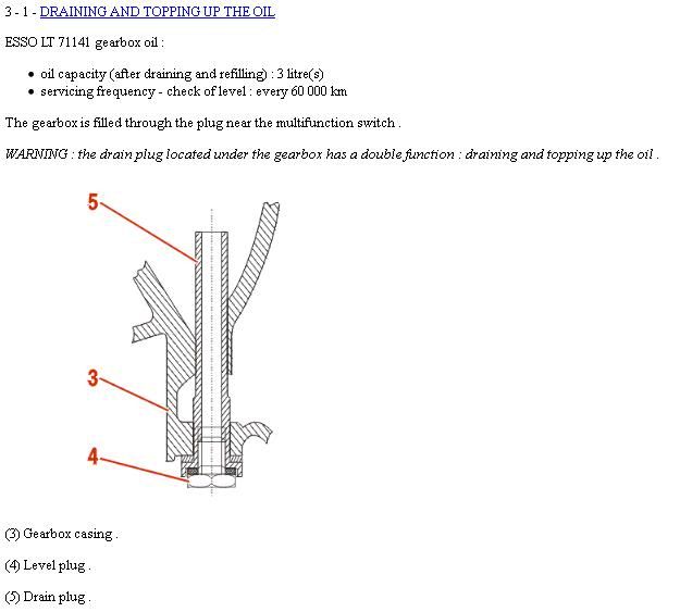

It's really up to you but I have my AL4 gearboxes oil changed every 20k miles or every 2 years by local Peugeot specialist. One of mine is on 96k and is still going strong and that trouble free mileage puts many a manual gearbox to shame. Gearchanges are as smooth as silk
AL4 does a duty cycle count and at 6000 hours will flash Ice and Sport warnings to say time for oil change but it's better to do it way before then and get the counter reset
This pic might help but if you're going to try it yourself then read up on the procedure as it's easy to under or over fill
