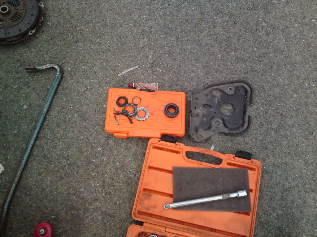

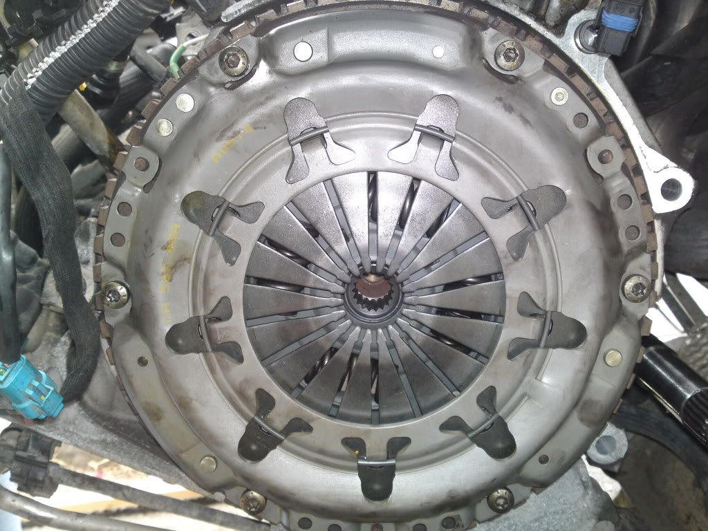

Mine went after hearing the release bearing grinding for a good 2 weeks and the bite point getting higher and harder to pull away.
I bought a clutch kit from my local factors, national clutches was the make, cost me just under £100, have done around 3,000 + miles and no signs of problems.
pics of the thrust bearing, well what was left of it, new one on the right to compare
and the new clutch installed
2004 GTi 180
