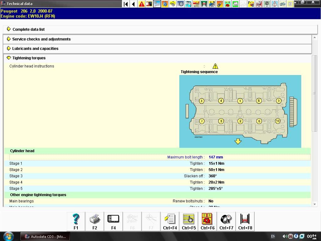

Hi im re-building my engine on my gti 138,does anyone no the torque settings for the head bolts?

PostPosted: Thu Jan 19, 2012 4:10 pm Up
Its a small amount heading in an outwards circle then a degree
Grease the bolts before putting the new headbolts in, dont want snappy snappy now

PostPosted: Thu Jan 19, 2012 4:14 pm Up
8/4/1/5/9
7/3/2/6/10
proceed bolt by bolt in the order shown
tightening torque of bolts : 5 da.Nm
tightening torque of bolts : 2 da.Nm
loosen by 1 turn(s)
tighten a further 285 degrees
This. new bolts must be used

Dont use grease on the bolt threads, use clean engine oil.
