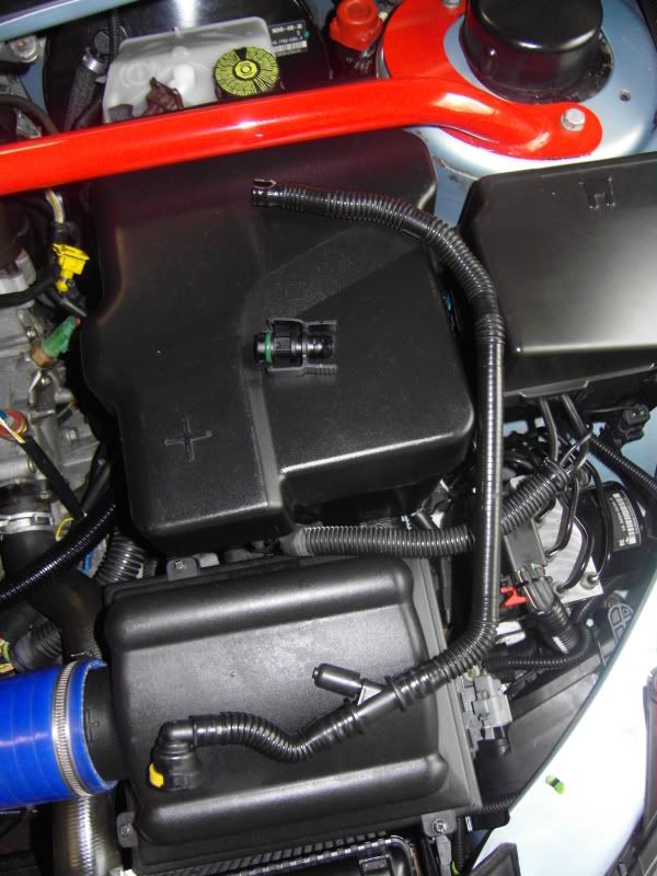

PostPosted: Wed Mar 21, 2012 4:39 pm Up
This is the standard hose - with the connector removed from it.

Edward, thanks for that pic. Bundle of info in that photo. I'll try and get a hold of that full pipe. Wink
