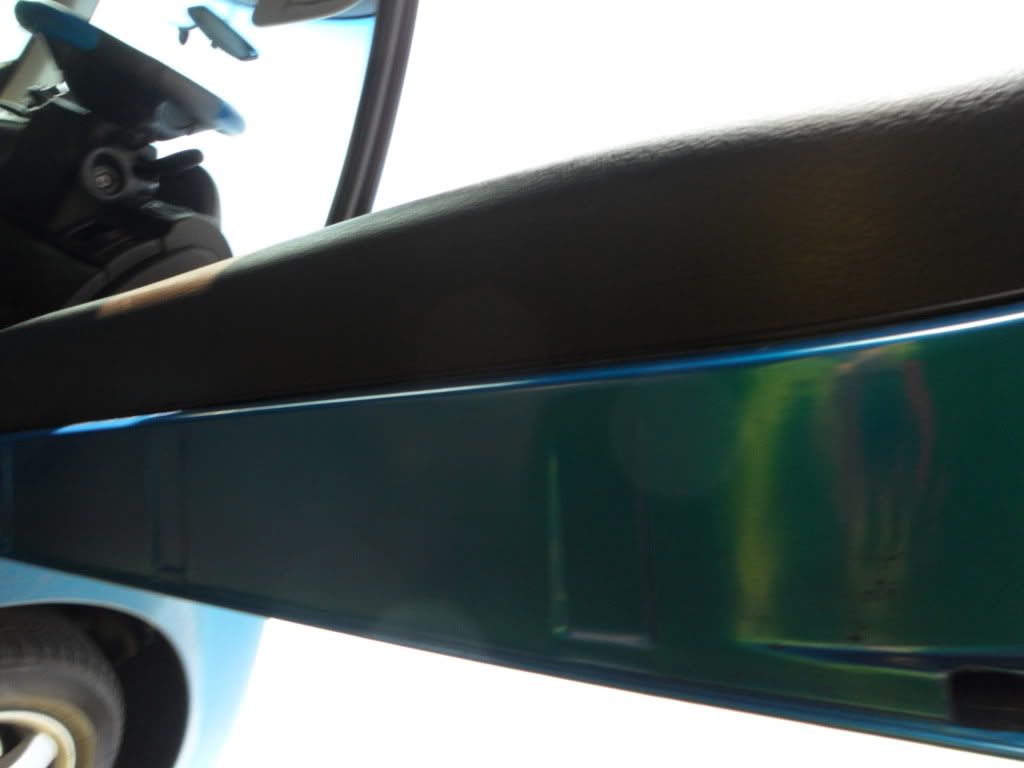

Can any one photograph these drain holes please I am sure they are not on my car, I'm having the same leaking problem!
Thanks in advance

Look at the door from the bottom. They are on the seam between the inner and outer skin.
'98 Nile Blue 306 GTi 6
PostPosted: Fri Jan 17, 2014 1:17 pm Up
You can just see one in this picture (bottom right), there is a similar one towards the front of the door too.
