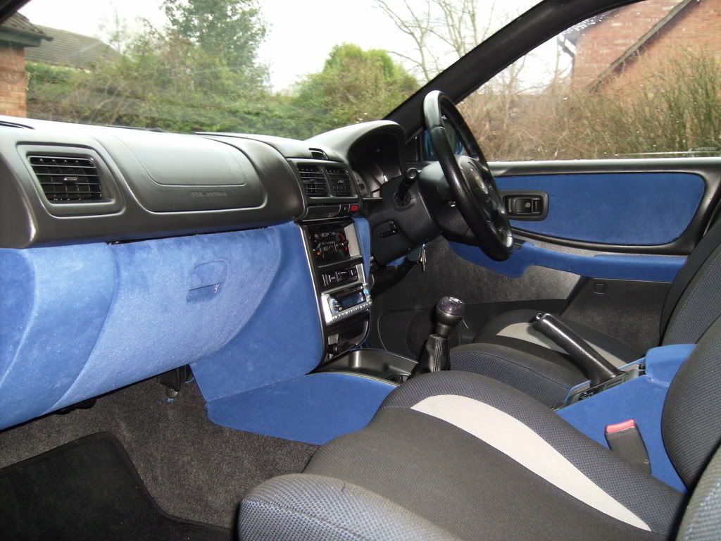

I did this on my old scoob mate, its all about patience this game! The way i tackeld it was to spray adhesive on the flat surface and bond the material to it, allow it to cure over a few hours and then trim/wrap the corners and stick down with a quick dry bonder (like syrup) Sadly i never finished it before selling. Was going to put the later spec sti blue seats in to finish it off!
