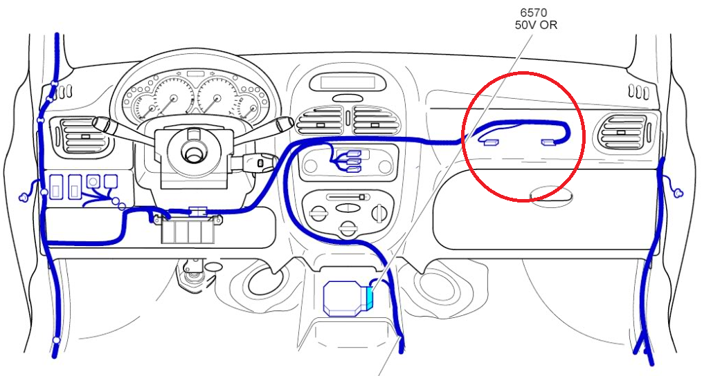

Would someone be able to tell me what colour the cables (circled in red) are?
I'm having some issues with my airbags and if the colour of the cables are the same colour as the ones which I have hanging behind my glove box with the plugs cut off, I may have found my problem.

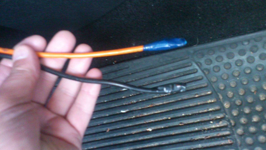

And this is whats hanging behind the glove box...
Thanks
PostPosted: Thu Jun 07, 2012 1:35 pm Up
You have found your problem.

Cheers Lee..
Would I be able to just solder new plugs on to the cables?
Is there a differance between plex and non-plex plugs?
PostPosted: Thu Jun 07, 2012 1:40 pm Up
Yeah you should be able too. Two wires (2mm each I think) in each cable.
You'll need plexed ones, as non-plexed only have one plug due to the SRS airbags only being single stage compared to the plexed dual stage system.
Multiplexed 206 airbags = more bang for your buck Laughing
Cheers Lee..
Will get some plugs and see if the 'BEEPS' go away Very Happy
