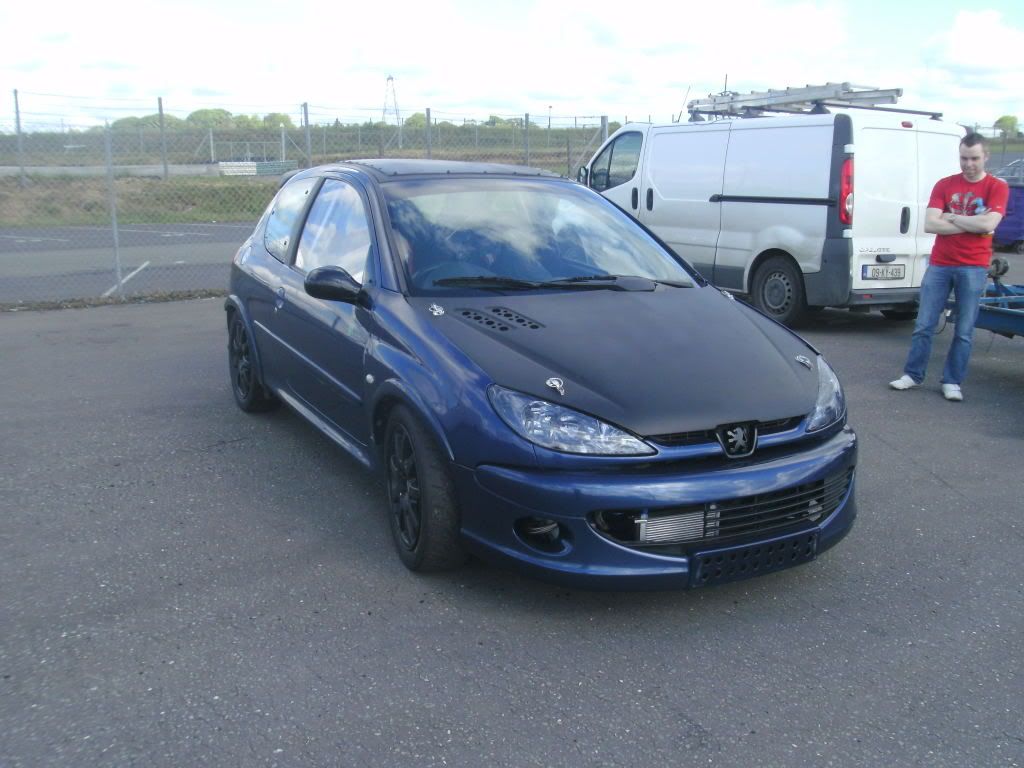

well took the pug to its and my 1st track day 2day and i have to say the car was absolutely SUPERB!!the engine is totally standard except for oil cooler and i managed to show up some serious machines(ie evos wrxs skylines)it was totally down to the brakes and handling of the car they were brilliant!!i couldnt beleive it ill post up a few vids 2 mor.

haha ok well as you see in the video above i am catchn a 306 gti-6 turbo but on the straights he pulls away..my specs are purely for a windy track like mondello as my engine is standard apart from an oil cooler.
standard gti 137 engine
k&n panel filter
lightweight fibreglass bonnet
brembo 4 pot calipers
carbone lorraine rc6 pads
307 hdi 283mm solid brembo discs
406 v6 master cylinder with 306 gti-6 reservoir
exact braided hoses all round
abs removed and brake lines re plumbed
motorcycle clutch reservoir attached to gti-6 reservoir
halfords racing brake fluid
tein fully adjustable superstreet coilovers on front
tein adjustable dampers rear
carbon fibre strut brace
22mm rear anti-roll bar
battery located in rear
pirelli pzero rx7 racing semi slicks
fully stripped out interior

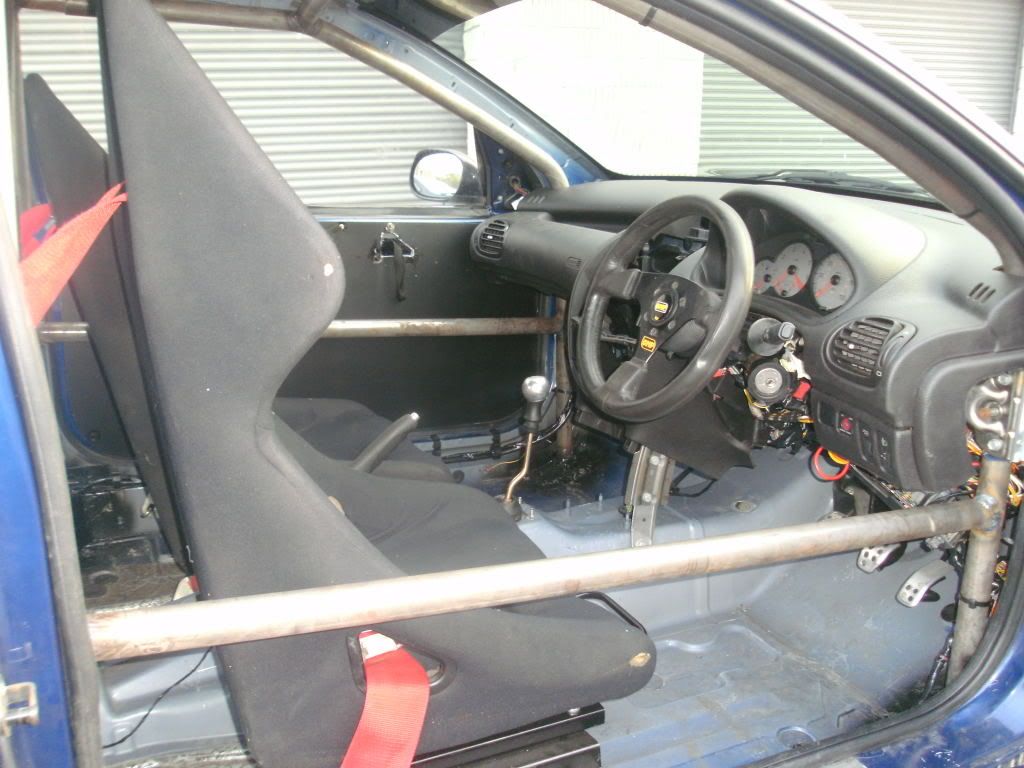

heaters abs air horns every possible bit of weight removed from engine and interior
poly carbonate windows
omp seats steering wheel and 6 point bolt in cage
sparco seat belts
think that about covers it
