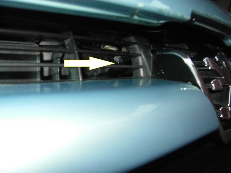

Easy to open the bonnet of a locked 206. I'll take a photo. All you need is a long screwdriver to push the latch through the slats in the grille.

Shine a torch through the slats and you can see the block on the end of the cable. Just get a large screwdriver and push it to the right. Bonnet should open easily.
