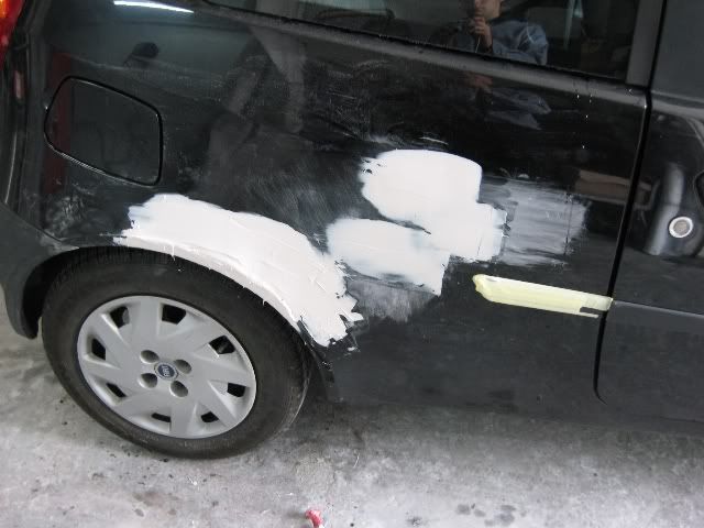

Couple of bumper corners here before flatting, these both had massive scuffs on:
Also had a ST, which had the entire passengers side kicked in, didn't get any starting photo's but it was really really bad. Had to rebuild all of the door's swage lines by eye:

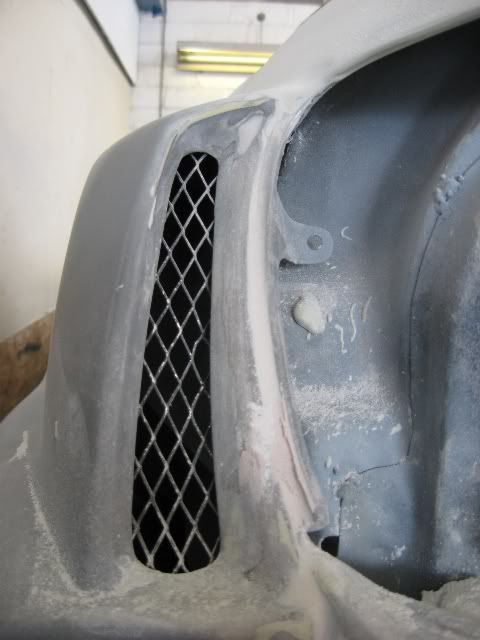

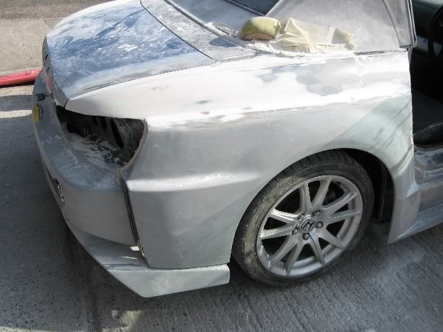

More updates on the S2000. Outside bodywork fitting is now nearly 100%. We are now making sebs arch's suitable to take large wheels. Obveriously the rear and front overfenders are about 2 inches inside the new fibre glass outer edge. So we cut back the metal archs, welded them back then fibre glassed over them to stop any hash edges catching on the wheel.
We will also be making Seb Custom wheel archs out of plastic as well, so that road muck does not get thrown up inside the kit and allowed to sit on the metalwork.
Also we finally worked out what the odd spare bit of the kit was for, and fuel cap extension. However like normal it fitted horribly. So we now cut the entire thing and reshaped it so it will fit like stock:
