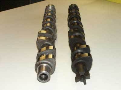

PostPosted: Wed May 05, 2010 3:48 pm Up
mattie wrote:
Ahh didnt realise you had aftermarket pulleys on the cams. Id definately suspect the crank sensor in this case.
The pulleys are nothing to do with it. The trigger is part of the cam. These are 180 cams below, the X on the end of the cam is the trigger for the sensor.
I wish the Piper cams did have a cam sensor because I like the idea of a thorough set up like standard cars have.
