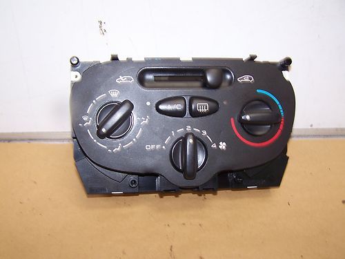

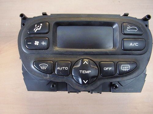

You are right,
The switch panel type like this:
Does indeed cycle the compressor depending on cabin temp, setting etc. Never seen it over here, I believe they call it 'climate control' type.
The other spec panel:
Does not cycle the clutch but comes-on as soon as you press the A/C button, as long as the blower fan setting is above OFF, and the temp setting on the right is on full cold.

Do you have one of the switch panels shown in above pics?
There is also a heater motor blower resistor mounted on the top side of one of the vents.
That has a thermal non-resetable fuse incorporated on it and might be worth checking that too.
