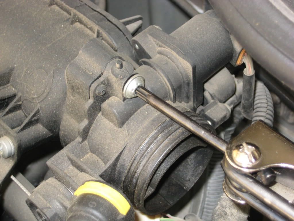

Hi can anyone let me know precisely where the ICV is located, have searched the forums and its near the Throttle body but still cannot see it
Sorry i need a idiots guide as a newbie pug fixer.

Its a 1.4 8v 2006 206
PostPosted: Sat Jul 20, 2013 12:38 pm Up

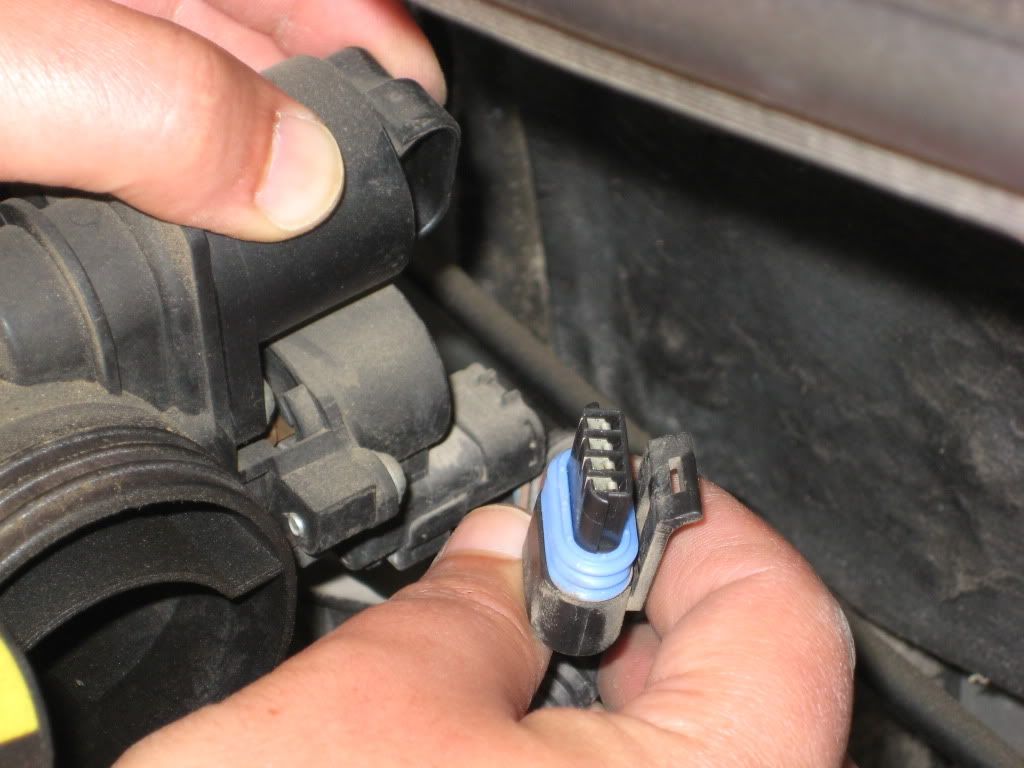

Well here is a pic of it,it's the one on the right next to the screw that i was taking off
and it's the one I'm holding with my fingers here:
and take a look at this guide it might help you:
Cleaning Throttle Body

Timon thanks very much, will have a dismantle when daughter stops drving it.
PostPosted: Sun Jul 21, 2013 1:19 am Up
You are most welcome :),keep us updated Smile
