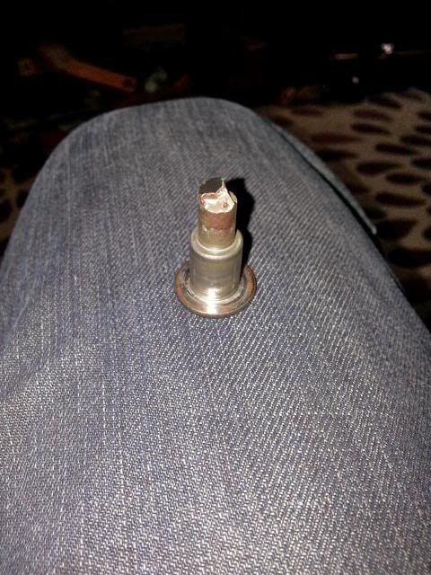

I moved my drivers seat to get in the back and noticed a sheared bolt underneath.
Its seems like it is to do with the height adjust for the seat as that is no longer working.
I've also checked all the subframe mounting bolts and they are all connected and secure, however the seat does have a slight bit of movement.
I'm going to take the seat out to see exactly what it is, but for MOT purposes, but if it is secure on the subframe is that enough or will it fail due to the movement?
Seems like a suitable excuse to justify changing the interior though Very Happy
TY in advance!

I just need to check that its not a bolt connecting the seat to the runners... Pic below.

Got apicture of the head of it?

2 secs... its completely flat, ie no starnut or anything

That looks like the pin for fold slide action when you let passengers in to the rear

Took the seat out and its the height adjuster pivot bolt thats sheared off.
The seat is secure, but it moves about quite a bit so I've just bought a half leather gti interior to replace it.
