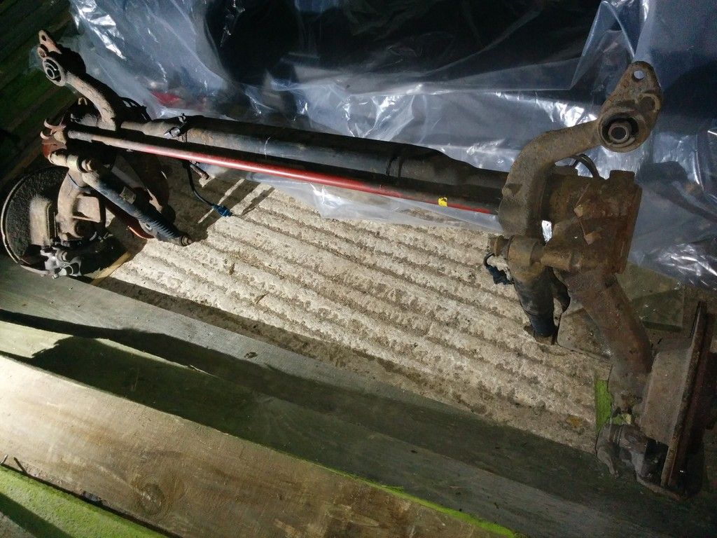

Back to our got-axled-up story; while enjoying the new clutch and alternator, a clanging noise started coming from the rear.
Been quite baffled for a while, forum search pointing to shocks, handbrake components, collapsing torsion bar splines, and what not.
Decided to give ImAxle specialists a try, a refurb arrived in good nick, but a word of warning all this hammeritesque coating is very thin, and grows an unsightly surface rust in weeks.
The oldie had an apparently snapped ARB within, so that explains the clanging. Left it for further inspection in unforeseeable future:
If you're careful, it's possible to rustle the axle down without disconnecting the brake lines:
Dropping the axle made it easier to inspect the rust-away situation.
Back in 2015 before the treatment (real bad):
Same 2015, after sanding (I didn't remove enough rust, was hard to get to!)
On the same 2015 week, rust inhibitor (didn't inhibit enough apparently:)
Coat of cavity wax and the undersealer (same 2015 obviously:)
2018, nearly 3 years and 7500 miles later (two years of being SORNed):
Lessons learned:
  • don't use pressure washer to remove surface rust, as it will leave tiny droplets in hard-to-get places
  • use steam cleaner instead
  • ensure you remove all the rust you can, drop axle to gain easier access
  • invest into sand blaster (would soda blaster be less messy, Edward?)
  • if blasting is off the table, then a compromise would be this newish invention: Polycarbide Abrasive bit or disc, only bites the rust out and leaves the metal intact!
  • consider several coats of rust inhibitor, cavity wax, and especially the final undersealant
Axles, axles everywhere!
Since it was the shiny one going up, I decided to toy around with the sandblaster. Picked the shoddiest-looking caliper brackets, and gave them a quick onceover:
Didn't go overboard, as that blastard thing just sprayed everywhere, even when you're wearing painters overalls
A spray of galv for protection:
Splash guards take the toll first if you drop your axle without too much care. My ones were also rusted beyond acceptable.
Picked up new splashguards from the stealer, they also got their share of galv spray, as they get scratched during transportation, that's where the rust starts to set in.
Now this part of the car starts to look more like from an Edwardian era, but alas this being my daily, had to go back on the road, meaning ran out of time to blast the brake calipers Neutral Next time for sure!
The splash guards are still as shiny today after 3 months of abuse, and make the rear discs look bigger Very Happy
Had one last niggle from the AVO rear shocks -- one of them was weirdly knocking.
All mechanical things being sound, meant I could start eliminating uncomfortable and noisy bits, meaning front AVO coilovers had to go too, with lowering springs replacing them (that's for my next post).
