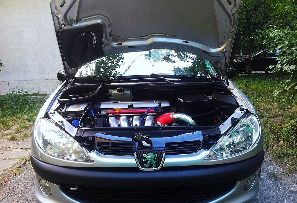

Fixed the intake. This actually made a noticeable difference in acceleration as the engine is finally sucking some colder air.
Twisted Evil Twisted Evil Twisted Evil Twisted Evil Twisted Evil
