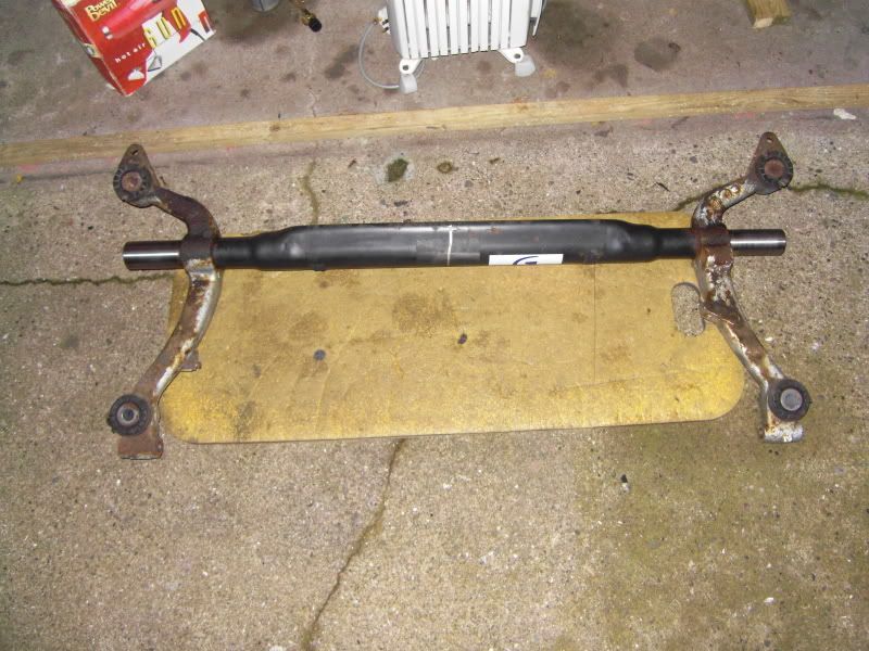

The only other difference I know about is in 2003 the trailing arms had the bosses cast into them for the lateral links fitted to the 180 and SW models. I've also heard later axles were round in section as opposed to the square/triangular section of earlier versions.
Earlier axle is below.
