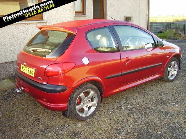

Ok so i have been saying for a while that I would start a project thread so here goes!

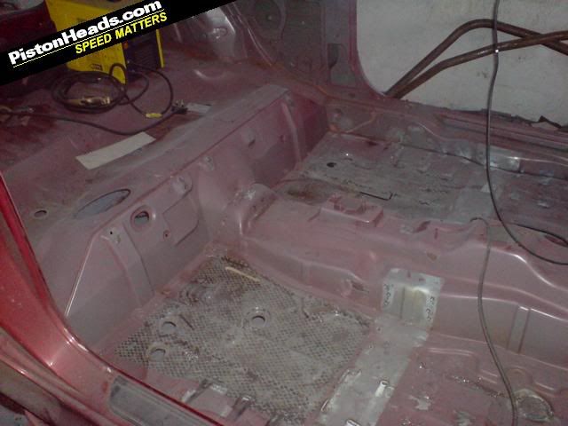

Bought the car from a guy WAY up north of Scotland and had the interior etc stripped out it and partly seam welded plus a few bits to install to make it a rally car.
original car before any work!

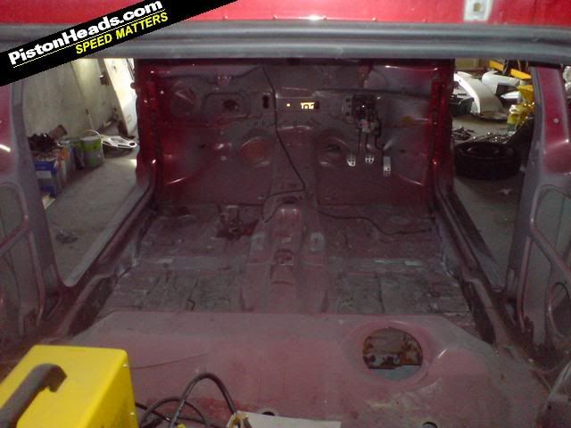

Inside all stripped out and welding started on all the seams

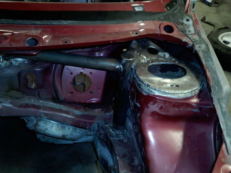

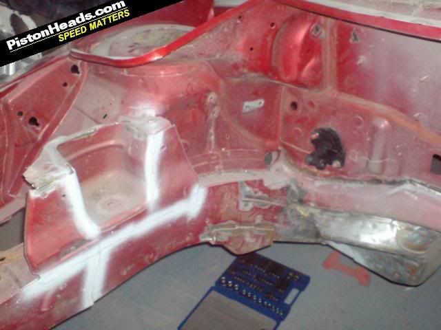

Engine bay with all the seams welded and painted to try and stop rust

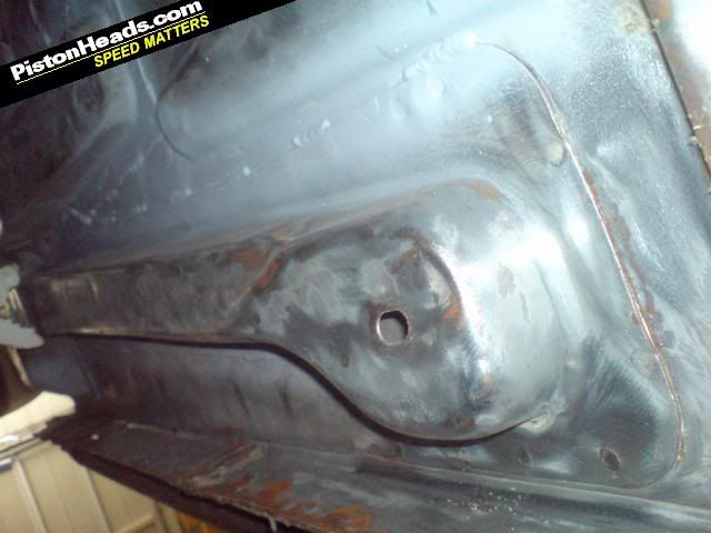

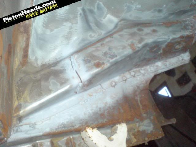

All the sealer removed from the underside of the car and welding along the chassis rails etc
Ok so that was the state of the car when I bought it so the rest of the work was me. Thanks very much to the guy i bought it from for removing the sealer ive just done it on a 205 rally car im preparing and its one horrible job!!

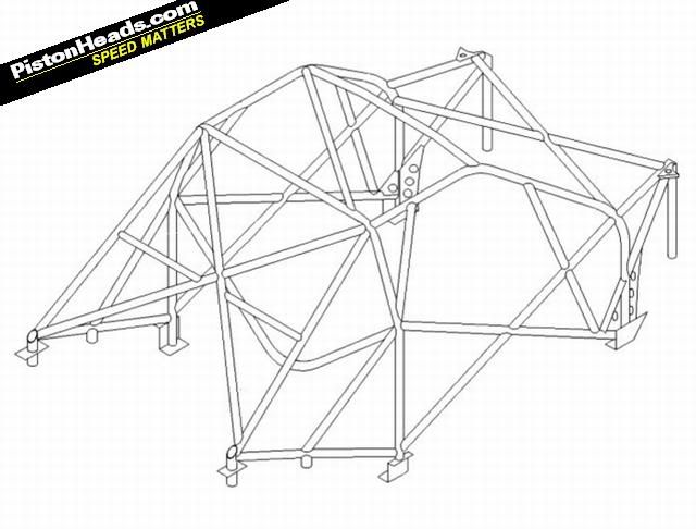

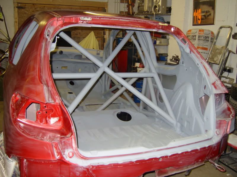

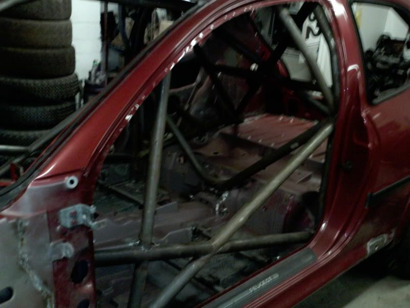

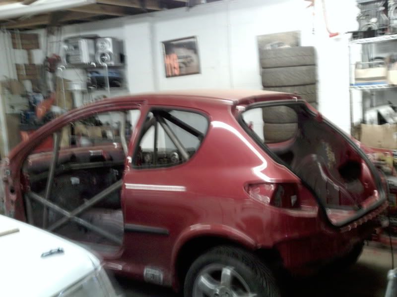

Customs weld in cage to be fitted
New engine bay with the cage fitted
Inside the door. How i get in and out of there when the seats are in i dont know!! Laughing

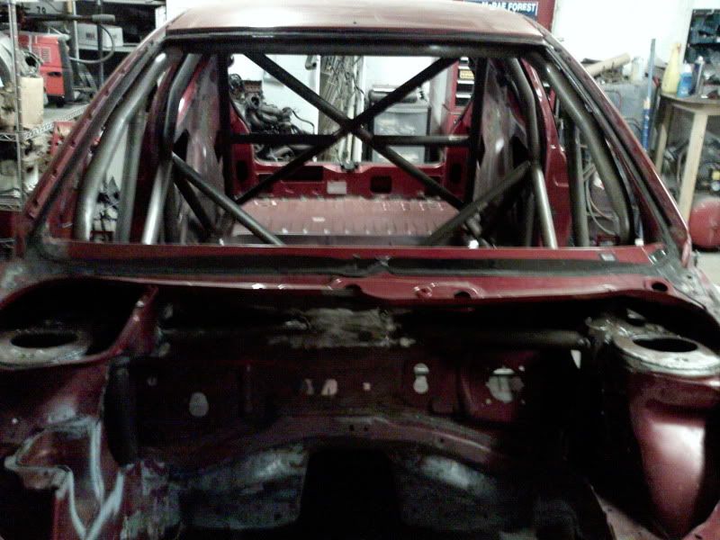

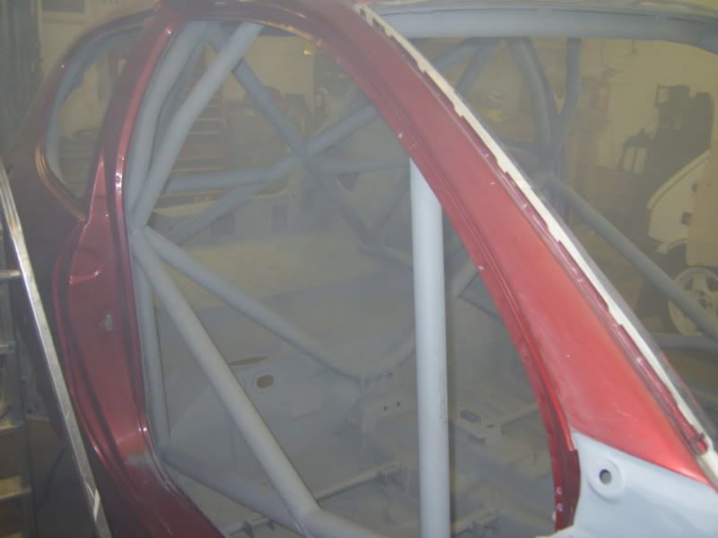

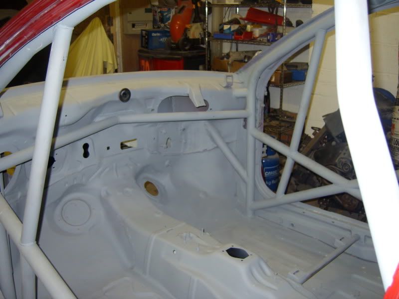

Inside of the car with the cage fitted, seat rails welded in, all seams welded up
Bilstien jack points welded into the sills!

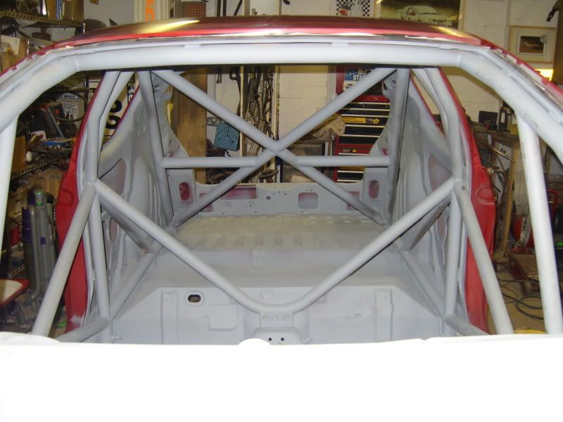

Roll cage finished

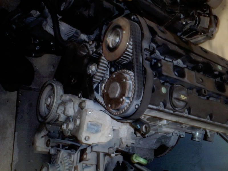

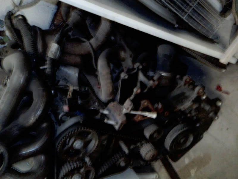

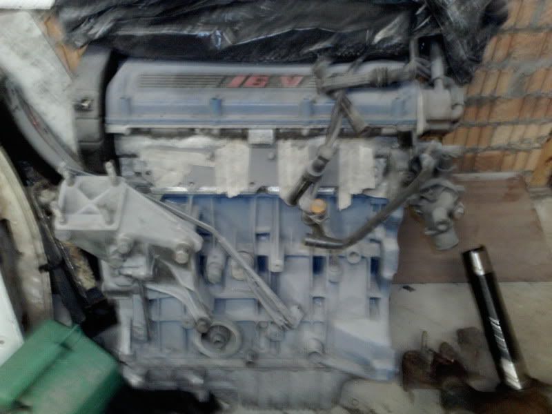

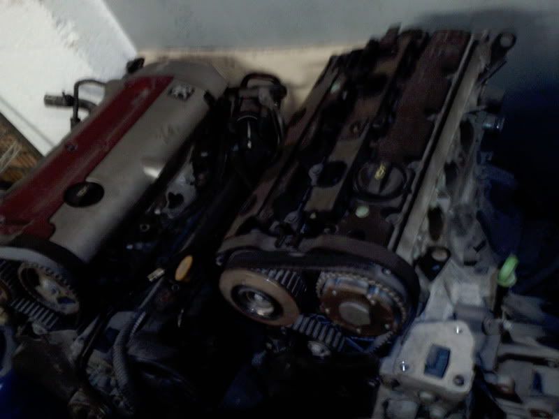

Then i faced the engine problem. What one to use.
I first started with the standard GTI engine.
Thought that i might get bored with that one so i bought a GTI 6 engine
Decided that putting a heavy engine in the front of a rally car may not be the best for handling and with a standard 180 engine the same performance id try a 180 engine!
Think i could join them together??? Very Happy
Ok look another engine this time an MI16 from a 405 mhhhh which to choose!!! Very Happy
Choices!!! So that is where i stand so far with the project

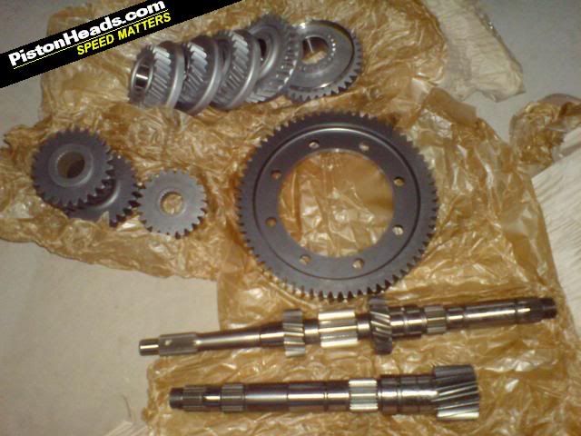

The quaife gear close ratio gear kit and tran x diff to be intalled into either the standard or gti180 box

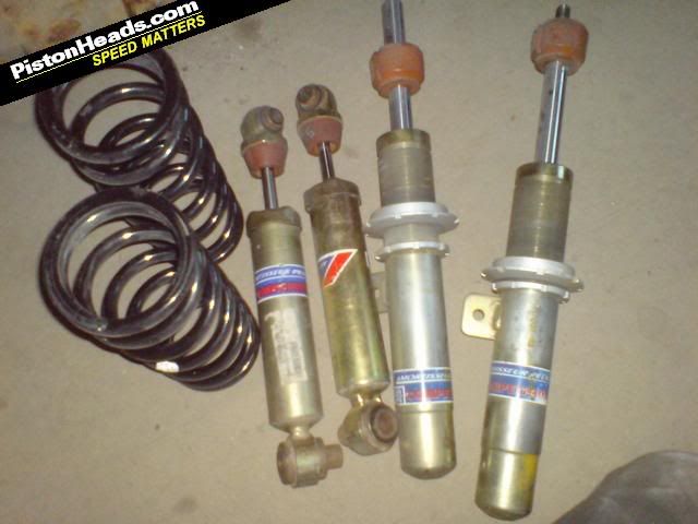

Peugeot sport group a suspension to be fitted

gota be the 180 engine to put in id say as them mi16s are old and worn out compared to newer engines!!! great project though be good to see the finish
PostPosted: Sat Apr 10, 2010 2:13 am Up
There are pros and cons of using the 180 engine. Setting up the 138 engine on throttle bodies is easier and there are more engines out there if spares are needed.
The 180 has a modified bottom end which could mean it's stronger and the cams will help get more power out of it. The downside is the VVT which is harder to set up but also gives a torque advantage if you can set it up with standalone management.

It was a CAT D right off so i have saved it from a life in the scrapie Smile
Tried to fit the dash but it was a total pain in the a$$ trying to cut bits out to get it to fit around the roll cage!! Next step is to paint i think or maybe take the sump off the 180 engine to check its all ok. Should be as it has only done 30000 miles but best to check i suppose Very Happy

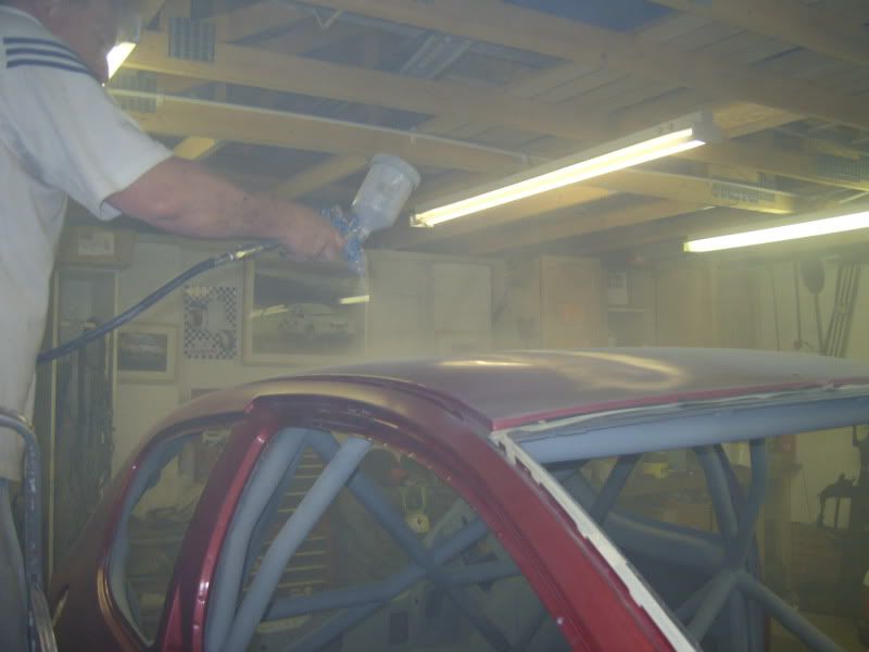

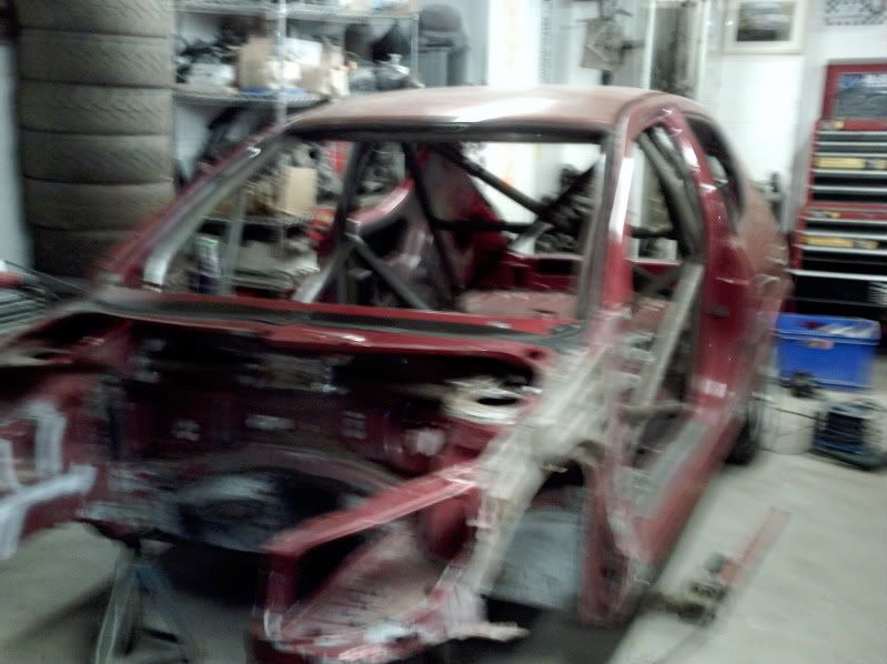

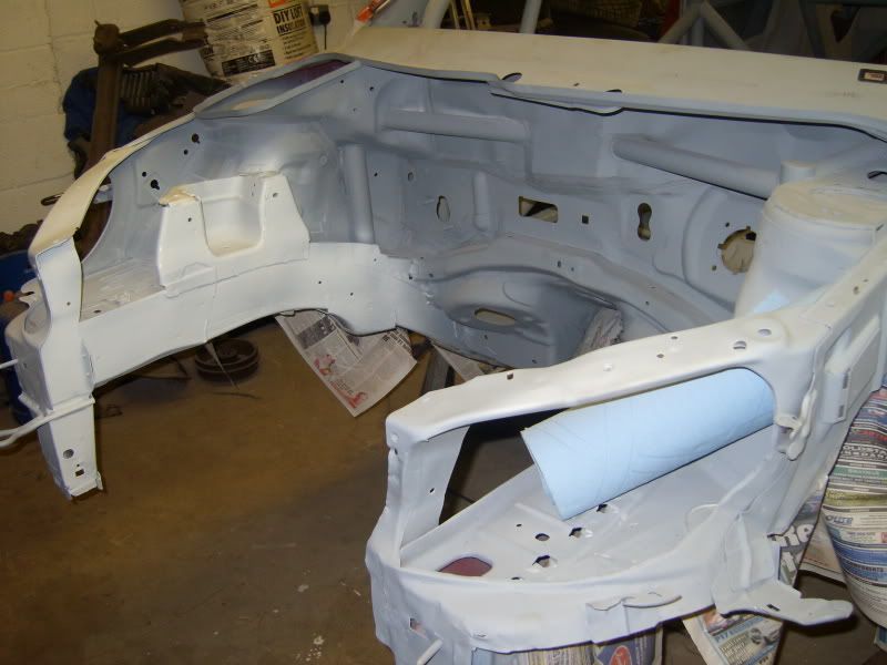

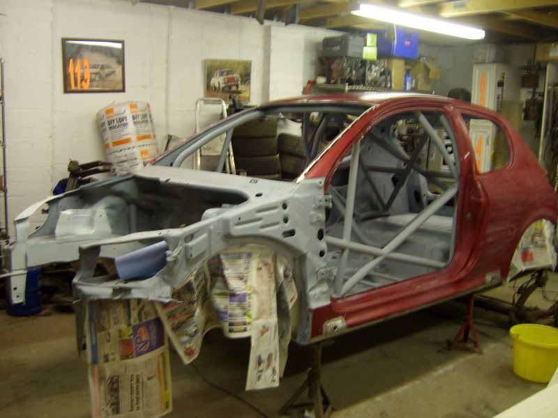

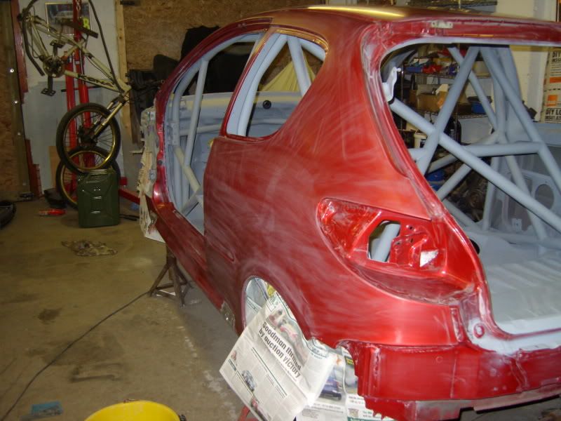

I have removed all sealer from the bottom now as well as the inside, welded up all the drainage plug holes which takes ages!
The engine bay was primed ready for paint on tuesday and i have just finished off the rest of the body in primer tonight. Will update with those photos tomorrow its like a purple haze out there just now with the fumes.
Anyways here are the pics of the engine bay, inside all primed and the rest of the body all prepared for the primer to go on.
