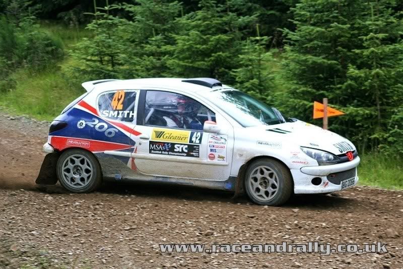

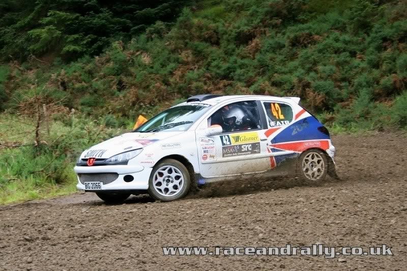

New colour scheme!
What do you guys think?
Schumi
PostPosted: Wed Sep 07, 2011 4:01 pm Up
Posts: 901
Location: Istanbul / Turkey
Not bad. Is the car completed ?

why does it have angle eyes lol
PostPosted: Wed Sep 07, 2011 4:35 pm Up
apart from the red lion badge on the front everything looks cool!
looks like the 207 BTCC git color scheme
