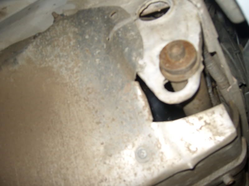

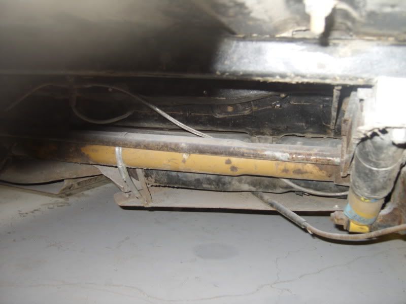

looking very good, proper job! sorry to be abit cheeky but do you think you could send me a few more pics of the 205, im building one on a very tight budget and just interested in how others have gone about things, dash board sump guard mountings etc, any help would be good!
Sure thing i will post some photos up later on. Is there any particular area you want photos of? Very Happy

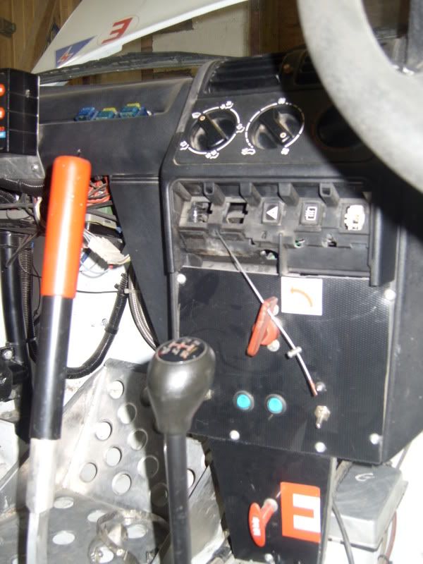

cheers mate, mainly the 'c**k pit' area need to see where others are putting switches etc, also be interested in some of the sump guard and how its mounted, as ive been given a good thick alloy one but im not sure weather itl be wide enough, so for the tank guards would be a help to as i got some cheap and there the next job to fit! But anything would be a help, many thanks, pm and email them if you like instead of hosting here, whatever is easier for you.

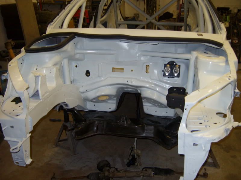

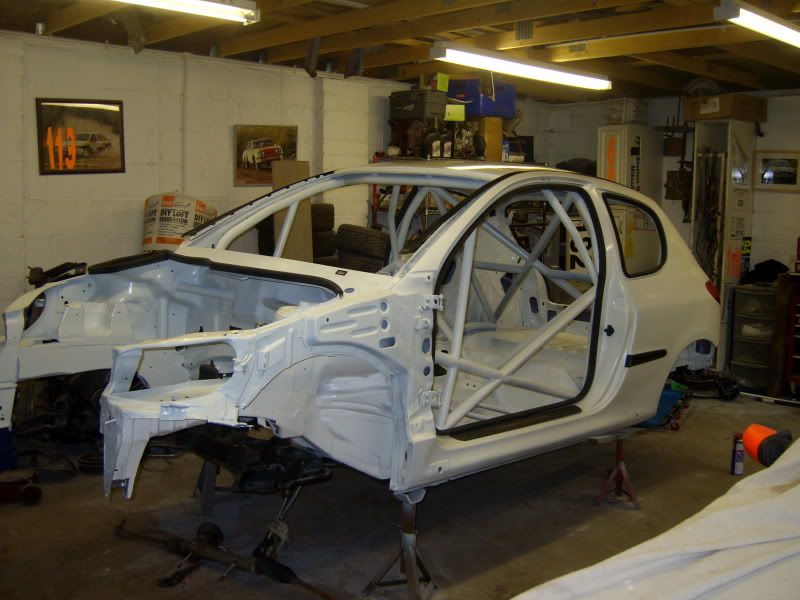

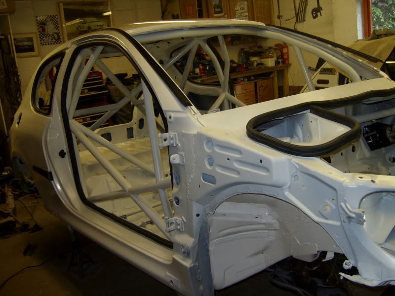

Update on the 206 from work done today:
Jamie
PostPosted: Tue Jul 20, 2010 6:16 pm Up
Posts: 3327
Location: Ring y0
What's the lever for? Hydraulic handbrake?

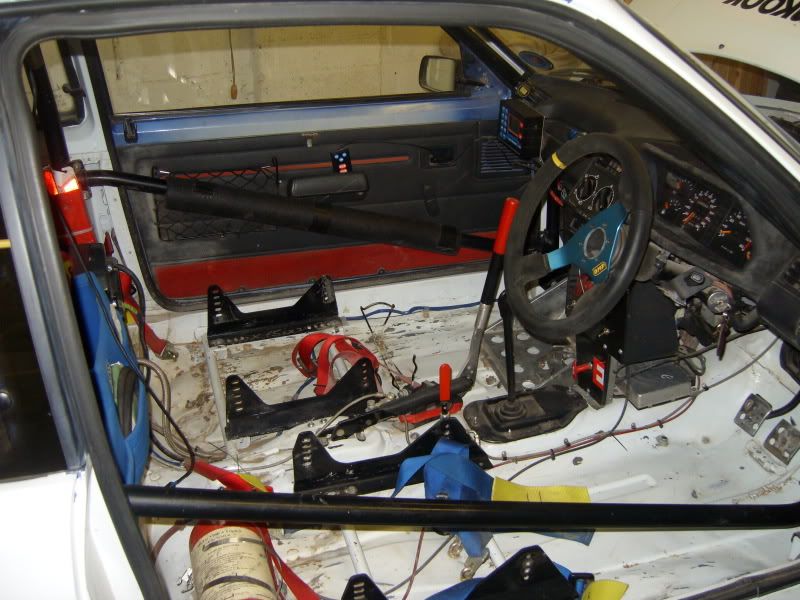

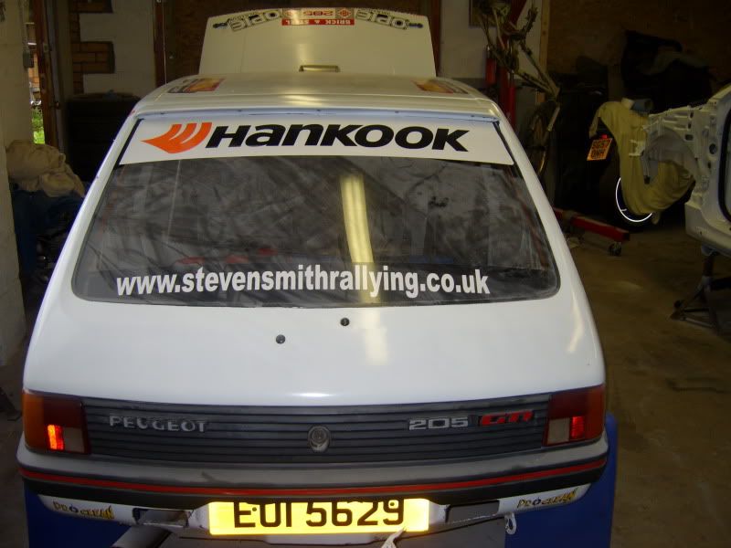

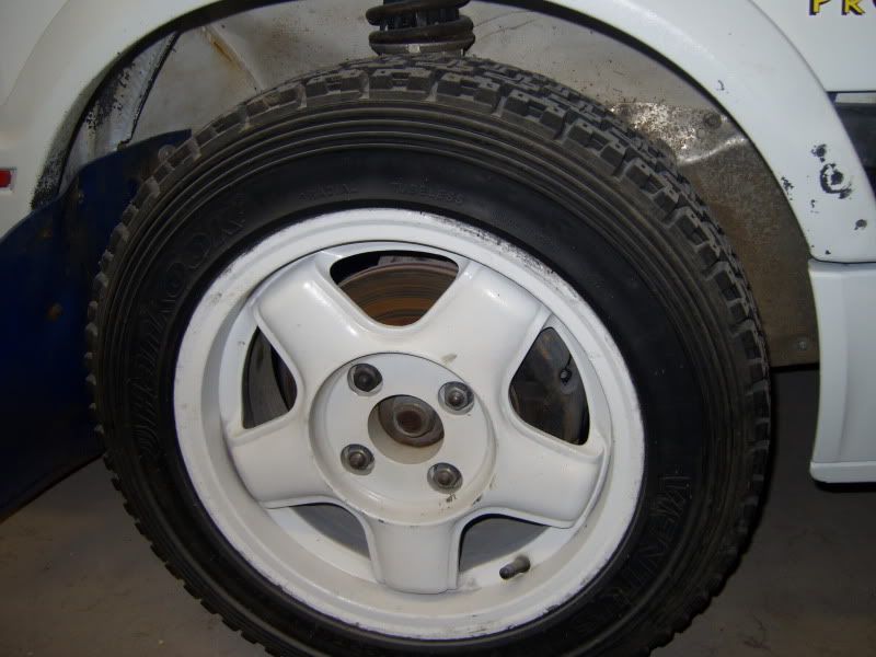

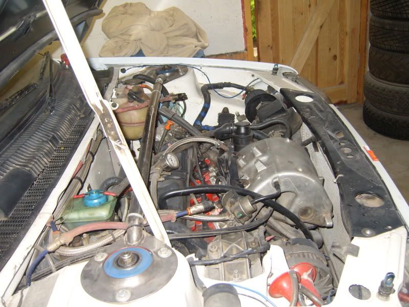

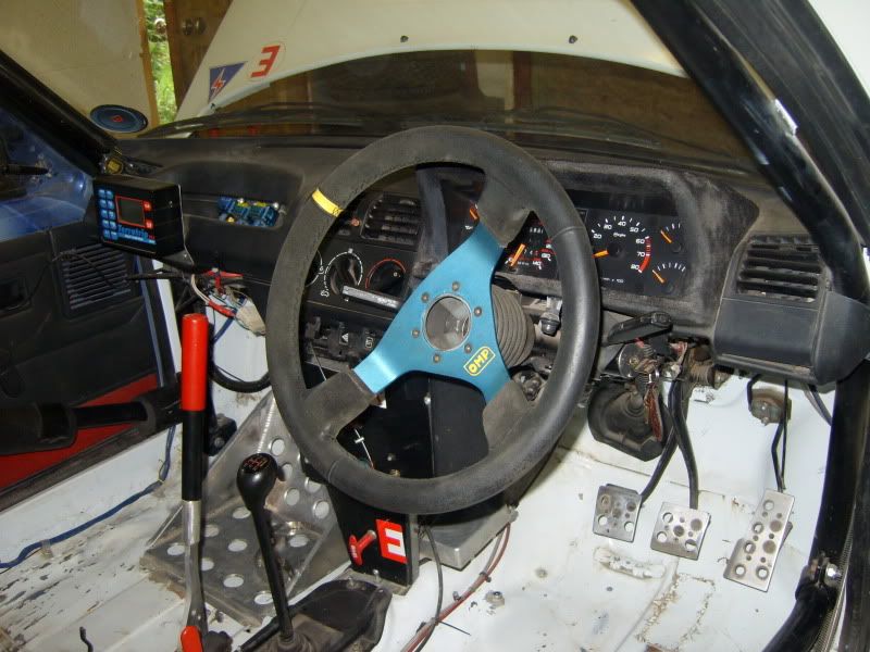

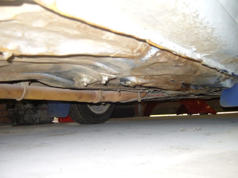

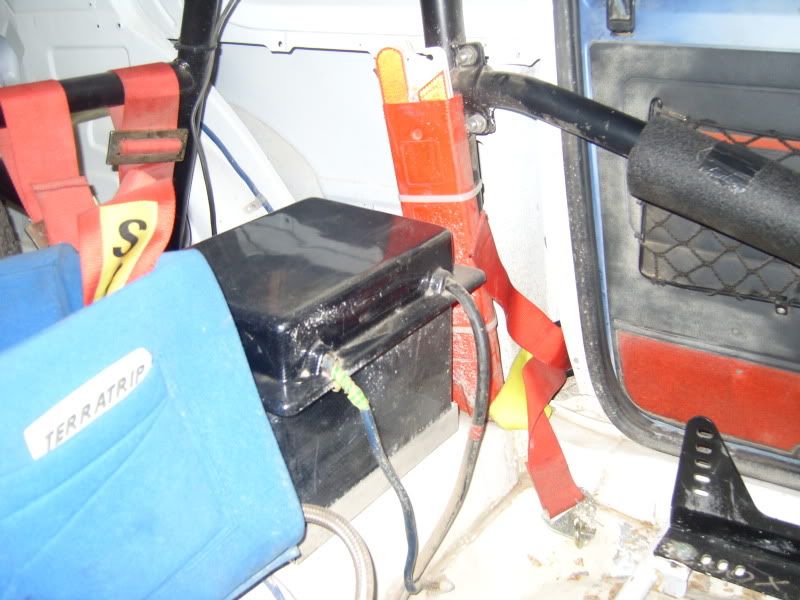

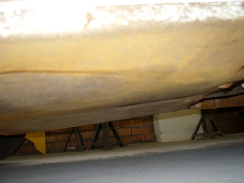

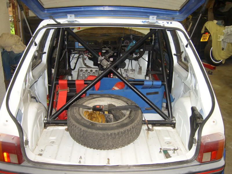

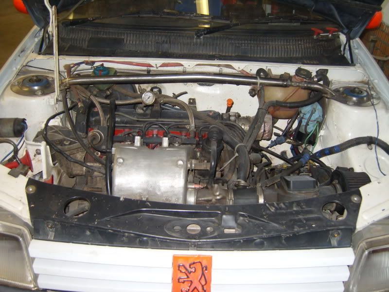

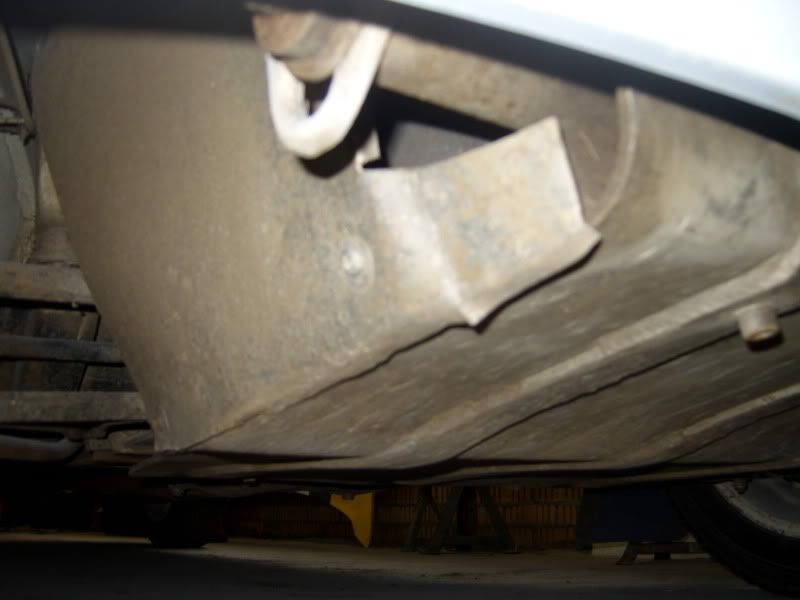

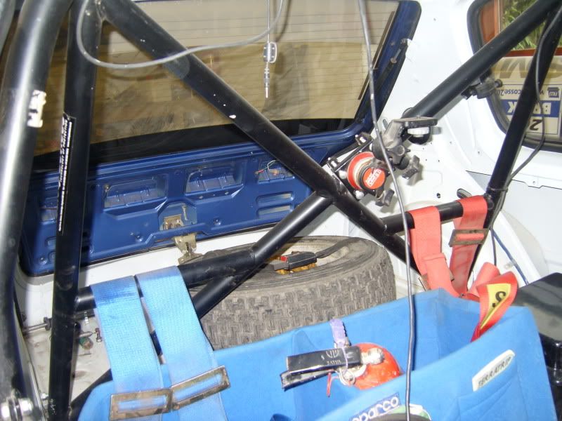

Pictures of the 205 for spud_owen. I have the seats out just now because it took a bit of a battering on the last rally so it need a bit of welding and some painting on the floor
General view
Engine bay
Wheels
Sump guard mount and side plates
Dash
Rear of the car
Where the seats would be
Under the back
Tank guards

Yeh Jamie it is the hydraulic handbrake. I need to keep the standard one to comply with the road traffic act sadly. Unless i can get it tp look like the hydraulic one pulls the cables Very Happy

Yeah you need a machanical handbrake for MoT or RTA like you said!

Just got the sump to put back on and then i can put it in place. I will need to order uprated mounts before that.
I will call emerald tomorrow as well and remind them they owe me a discount off my ecu so will get that ordered up as well soonish i hope.
Do you know when yours is going in to be done yet?

spud_owen
PostPosted: Wed Jul 21, 2010 7:00 am Up
Posts: 414
Location: ashby de la zouch
cheeers for them them mate, got a couple of questions if thats ok? does your sump guard cover the entire underside of the engine bay, ie does it extend to cover the gearbox as well? the one i have been given will cover the sump and I can make some side plates up for it how much further do i need to go? also is that a metal strap you have around the rear beam to stop the tank guards from 'flapping'? last one is a query aboutt he hydralic hand brake, my car has one fitted but it is in the postion of the standerd handbrake and it also has a locking falicity which enables it to act as a normal handbrake, to your understanding to I need another mechanical lickage as well?? again many thanks much appericated.

imjeeves wrote:
I will use a mix of the Baker and Vibra techcnix ones i think. That seems to be the cheapest option anyway.
Ooh i havent thought about the radiator yet what are you fitting?
The only baffled sump that i have found was on the Peugeot Sport France website but i dont think it was very cheap tbh. I was considering fitting one but i havent had a problem really with oil surge before on events. May be a good idea if you are doing a lot of fast track stuff though?
Apparently a good one for bodies is a Toyota Corolla one as it is shorter than the standard unit. I think a baffled sump is a good idea, ie prevention > cure!
I have a mix of the Baker/Vibratechnics items and you only need the gearbox mount from VT, however the Baker engine mount (called RHS mount iirc) will require some of the thread being taken off as it is too long as standard!
